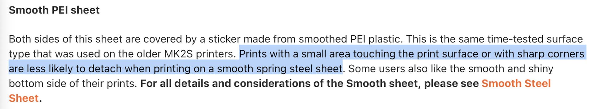

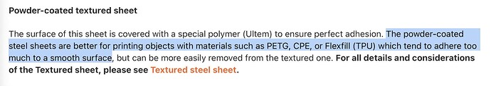

And here is some more info for you from Prusa who pioneered the use of both textured and smooth PEI.

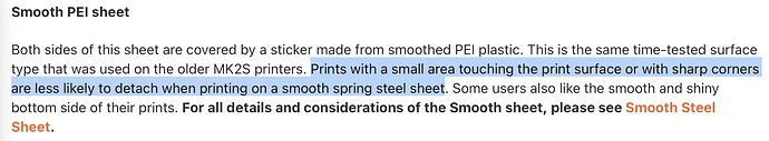

Here is some more for you:
Dont take my word, do some research instead. And yes I print on both smooth and textured, every single filament under the sun, with small items that often have 1 or 2 lines for the first layer, and smooth has STRONGER adhesion.
Again if your smooth PEI is not sticking well, its becasue its dirty or worn. It requires more maintenance and upkeep then textured and is a consumable part that wears out quicker then textured.
like i said read the product page
it requires glue for most everything and its more delicate. why argue this its been fact for 5 plus years almost. i love the smooth plate its what I use most but it has downsides
