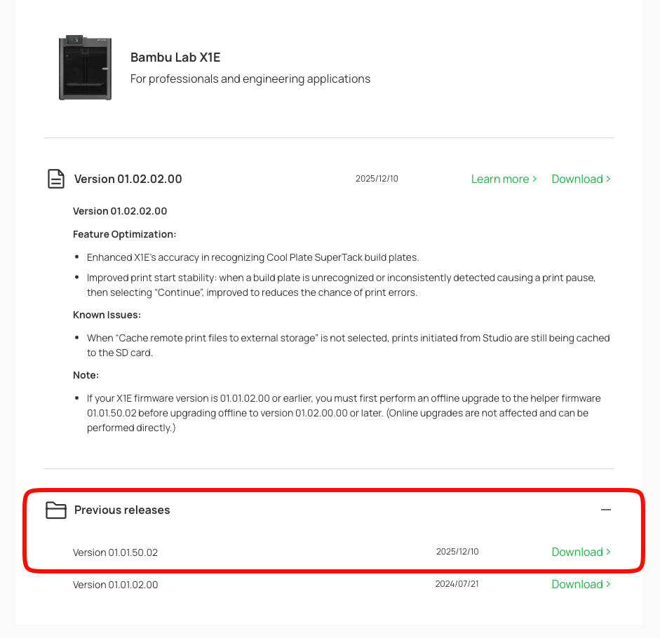

Running an X1E with firmware 01.01.02.00 and looking to update.
According to the Wiki, I need to “upgrade to the helper firmware 01.01.50.02”, however no link is provided and searching for the firmware version has thus far been fruitless.
In our environment, OTA updates are not allowed, and updating offline requires a version that I have been unsuccessful at locating.
A link to the above mentioned helper firmware would be greatly appreciated.
They really should include the download location on the Wiki. You can find your firmware to download here: Firmware Download | Bambu Lab

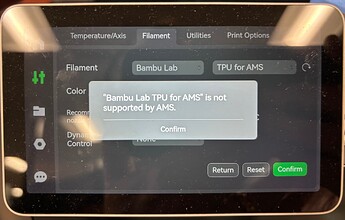

While the printer is still functional, the desire to update stems from an error I received trying to manually load TPU.
Since this works fine on the X1C machines with their updated firmware, I attempted to update from ver 01.01.02.00.
Downloaded offline-ota-c13_v01.02.02.00-20251210083431.zip and ran the update, but was greeted by this error.
Which is what started my search for the 01.01.50.02 helper firmware.

The helper firmware is available already on the download page: Firmware Download | Bambu Lab
We will improve the wiki to ensure it is clearer.
