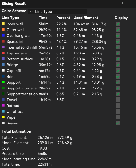

X2D curve planning much slower compared to arc fitting?
With enabled Arc Fitting:
Disabled Arc Fitting which results in Curve Planning to be used instead (at least that’s what bambu studio tells us):
Looks like sparse infill alone takes +3 hours.
Is the print quality really that much better with curve planning? Also, how can we confirm whether it’s actually being used and that the printer isn’t still handling arcs the old linear way?
Arc fitting enabled is the faster setting, right? I would assume that it is both faster and better quality than curves being interpolated by short straight lines. The printer can execute curves as one smooth movement at constant speed. That should be beneficial for both speed and quality.
Do you have gyroid infill enabled, a very curve heavy sparse infill? Perhaps thats part of the puzzle.
Yeah - it’s faster with Arc Fitting enabled.
The thing is that bambu studio automatically disables it and informs the user that printer supports curve planning and to use it instead:
Indeed - gyroid 30% infill

Btw to be clear, even if you use Arc fitting, curve planning is still active (afaik). Although it may or may not affect g2/g3 curve gcodes.
I believe the thinking behind this is that Arc fitting is just done for gcode compression, and is effectively lossy. The printer can handle raw line data and doesn’t need it. However, I wonder if we have the the controls to steer it.
You should play around with the “resolution” setting too. It has a huge impact on how both lines and arcs are generated in the slicer. I wonder now if that value is sent to the printer for use in curve planning… I think that would be ideal - samples straight lines generated in the slicer, and the printer is aware of the resolution. But I think the value of resolution is actually much too high for fine prints. You can see the difference on smooth curved surfaces.
Also to adress the slowness directly, have you tried adjusting the acceleration values? These may enter into both modes, in different ways.
