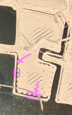

I took the plunge this week and bought my first printer, the X2D. I was looking forward to creating lots of things for the kids but it has been a bust so far.

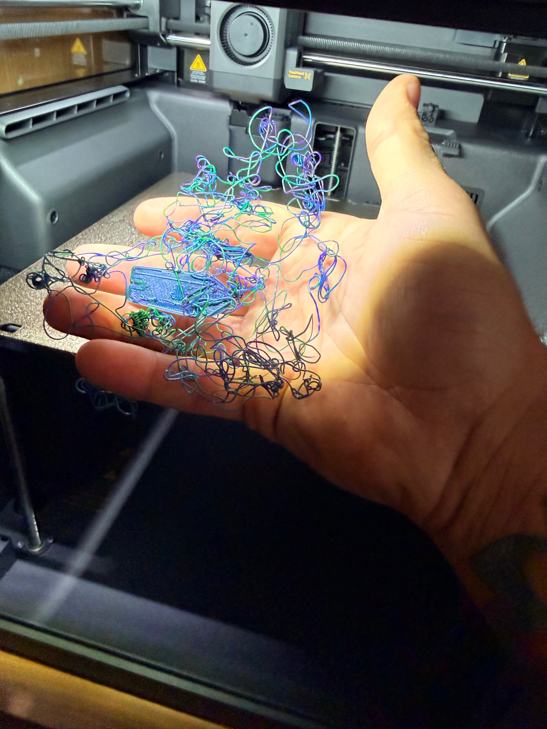

I am sure this may be due to my lack of experience but thought I would post here to make sure and maybe get some helpful feedback. Every post on tick-tock I see people unboxing this, put the filament in the Ams and off they go. I am yet to have a successful print, indeed they don’t get past a layer or 2 before a piece of filament still attached to the hot end pulls it up and the process is ruined.
I read online increasing the bed temp may help with adhesion, so I tried that, slowing the speed down, tried that, cleaned the bed in soapy water while wearing gloves so as not to get oily finger prints on there, dying the filaments for 12 hours…. Nothing has worked.
Any advise on where I am going wrong would be greatly appreciated
From your pictures, it seems be a bed adhesion issue. I know you washed your plate with dish soap and water, but did you make sure to get ALL the soap off? I personally use IPA (isopropyl alcohol) to clean my build plate because dish soap is hard to rinse off and the water takes forever to dry. IPA evaporates pretty quickly. I would try wiping down with microfiber cloth and IPA and try again. Hope that helps.
something looks really really really off in pressure advance to be that far from the wall, which probably is not helping matters. Bambu software calls this K-Factor, Flow Dynamics[not flow rate]. Is this off of your main extruder or the aux extruder? What was the measurement the k factor came back as? It should be a small number, 0.0■■ usually, decimal very important

That was off the external spool so the secondary one, wanted to try if that would be better but it wasn’t. I have ordered some of the alcohol spray ( should be here tomorrow) and also some 3DLac glue spray, not sure if this is required but I am running out of ideas.

Do the filament flow dynamics calibrations IMO. The aux nozzle especially needs more “k-factor” than the primary, so running uncalibrated it’s gonna give some poor results.

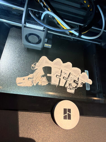

Yes I dried them both in the AMS for 12 hours overnight. One PLA and the other PLA sulk. I set them up like this on the printer
Yes I did a full recalibration and it didn’t help
Yes i have tried to print the boat, dinosaur and several spiders, non of which get past 2 layers at most
To me it looks like bad bed leveling. This could happen if
(a) there was dirt/filament on the nozzle while probing (rare)
(b) you might have some filament between the heatbed and the print plate. Take off the build plate and check it’s underside and the heatbed for (small) filament / dirt that should not be there.
To troubleshoot I would recommend using the left/main extruder, the regular filament (not silk), and put the “bed leveling” and “dynamic flow” options before print to “on”.
When the nozzle probes the bed, check if the nozzle is clean and actually touches the sheet. Maybe film the first layer with your phone

its much easier to diagnose issues with more visual aids.
I suggest you take a video of the first layer being printed.
