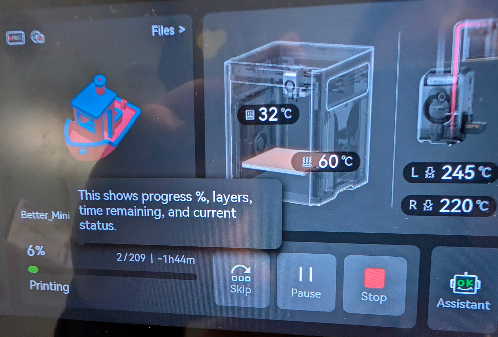

I’m running into a very frustrating issue where my X2D keeps freezing at the end of the first layer of the prime tower on multi material prints (using both nozzles). The printer is currently in Lan only mode and is on firmware 01.01.00.00.
The first layer will print, but then just freeze up. No warnings or errors popping up, just frozen. I end up needing to turn off power on the back to reboot it.
This did not happen on the firmware the printer shipped with, so I am thinking it is something in the 01.01.00.00 update. I’ve reloaded the firmware (from a USB stick), but that has not fixed the issue. Unfortunately, it doesn’t seem to be possible to revert to the original firmware, as it is not published anywhere that I can find. Factory reset does not appear to revert it back either.
I found one other instance of someone having what appeared to be the same issue online. They said they were able to fix the problem by reloading 01.01.00.00, which I am trying again currently. Just wondering if anyone else has run into this issue.

Try using the bare stock defaults in the slicer for all components? Machine,filament,process. Your one nozzle is 245. What’s loaded in it? Try using both nozzle pla while debugging.

I am using Polymaker Panchroma matte in the hotter nozzle, using the profile for the X2D I downloaded from the Polymaker website.

Interesting, I’m running a test now. The culprit might be the Polymaker profiles because I’ve done the same thing and the profile shows N/A for bowden max volumetric speed.
I’ve changed it to 8 and will give it a try and update here.
I am currently printing a two color benchy using elegoo PLA in both nozzles, and the generic PLA setting for each. It has gotten passed the second layer and is showing no signs of stopping. I am also suspecting the Polymaker profile.
It is highly probable that this issue is caused by Polymaker profile having N/A in bowden profile’s max volume setting. Can you try to confirm?
I have successfully printed with the profile fixed now!
However this is still a bug because the tooltip clearly states that if user (Polymaker in our case) enters an unacceptable number it will be ignored. Yet it is not ignored. Or it can throw an error instead of freezing.
Just to confirm, to fix the profile you entered a value for the max volume setting in the bowden profile? I just did that as well, updating both the high flow direct drive and bowden settings to 8, from N/A, to match the standard direct drive setting. I also did the same for the Polymaker ESD-safe PETG filament I had downloaded but hadn’t tested yet.

Yeah I did simply edited the profile. Specifically for the Bowden.
24 would be too high I believe so I went for 8 for now.

I can confirm this was the issue. I set the flow max to 8 across the board and it is not printing the 3rd layer of my model with the Panchroma material. Thank you Kontinyu for your help.
I will pass this along to Bambu via the support ticket I opened. Even though the issue ultimately was with the 3rd party profile, there still is an issue in their firmware if it doesn’t look for this problem and throw an error.
