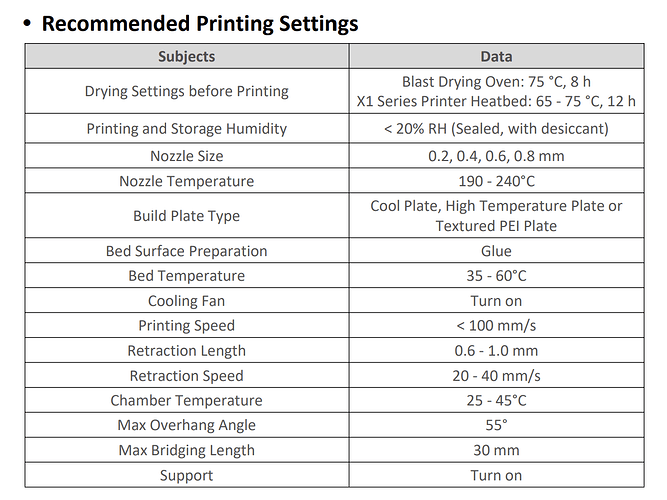

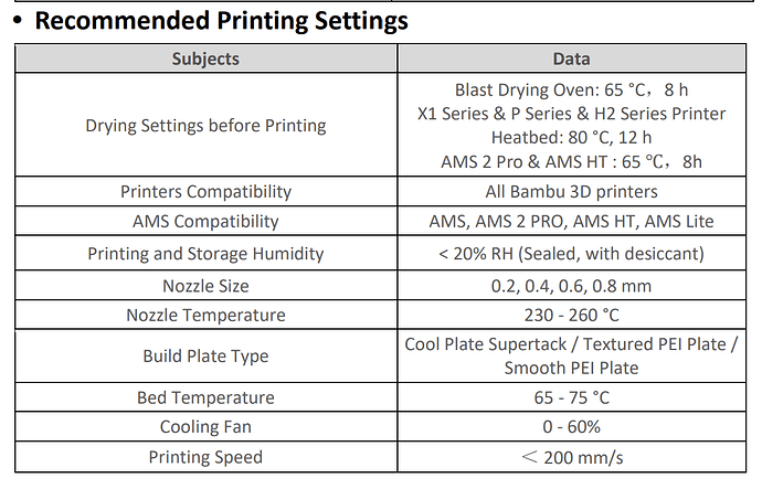

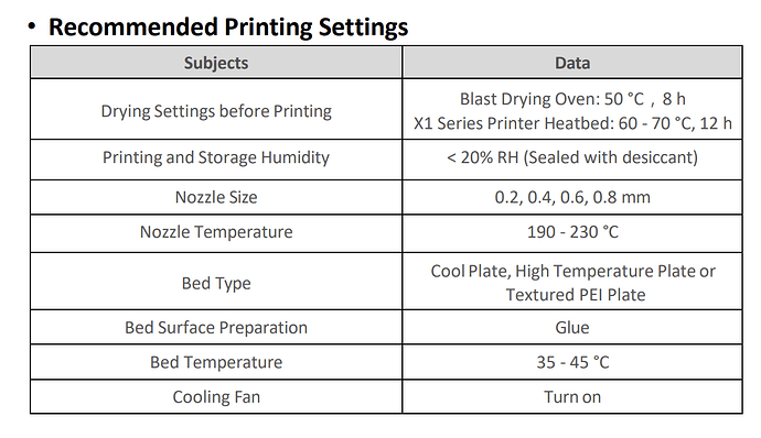

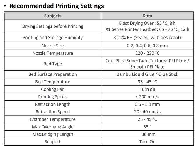

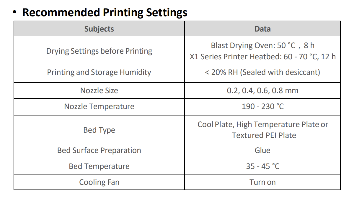

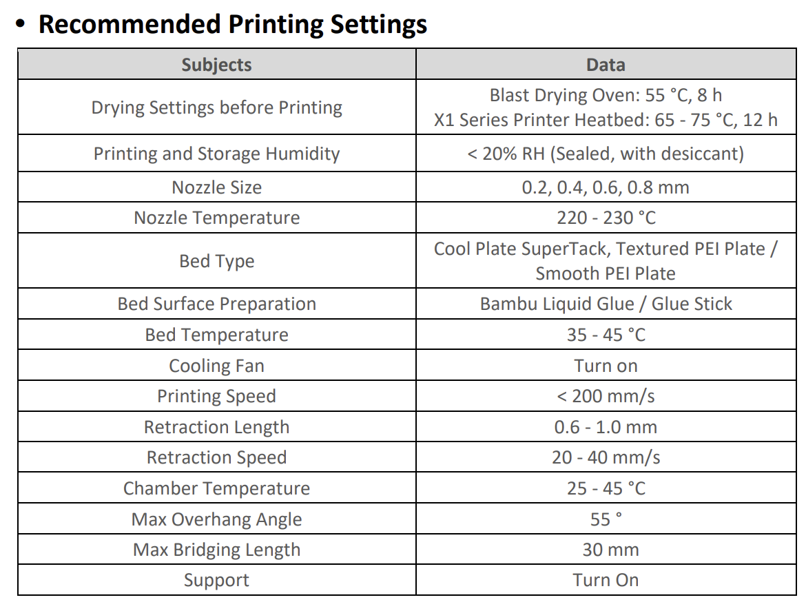

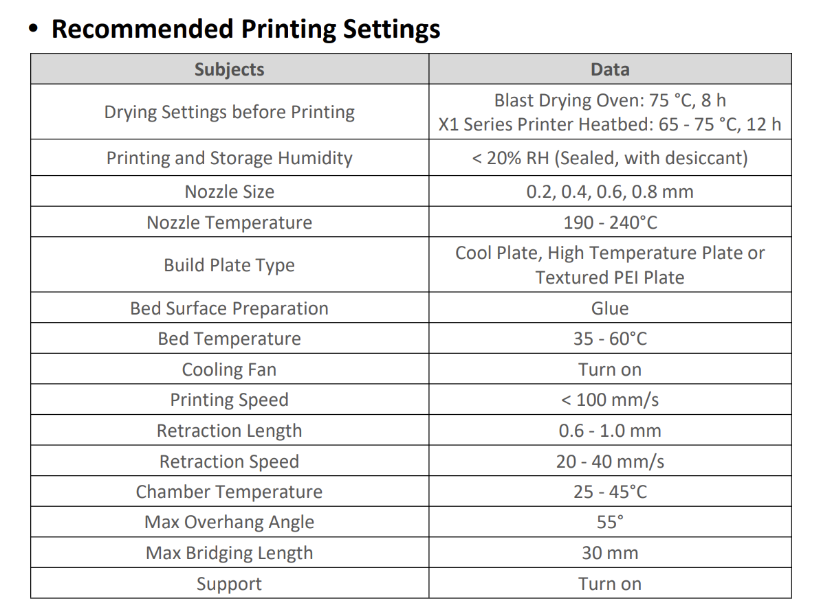

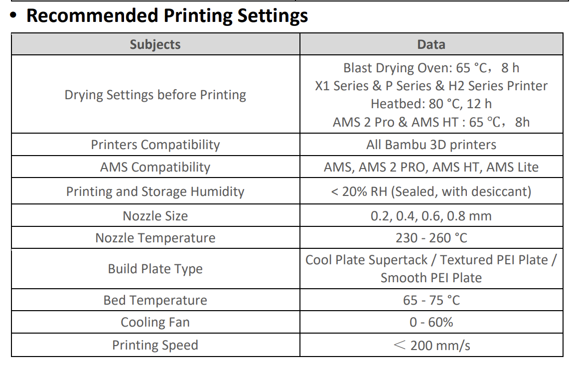

That’s a great piece of info about the Support for PLA/PETG filament. I could not find anything about the softening temperature of it, and in its default filament settings on Bambu Studio it is set to 45C (same as PLA Basic), but maybe the drying temperature indicates that it’s probably more heat resistant…
I can not see HDT either but drying temps are high:
Support for both PLA and PETG filament:
For comparison support for PLA only:
PLA Basic filament:
PETG Basic filament:
So blast drying seems to be highest on the combined support for PLA and PETG. And nozzle is up to 240. As far as I know this is a kind of composite material around PETG.
