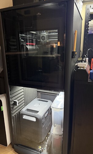

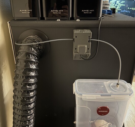

I know this thread is old, but this is basically how I just setup mine. 4-1 splitter right off the main extruder inlet. One port for the buffer/ams, one for the tpu assist, and 2 others for whatever else I need (super stiff filaments maybe).
Is that a custom built enclosure or off the shelf you have around the printer?
Both maybe? lol. It’s an old audio cabinet
