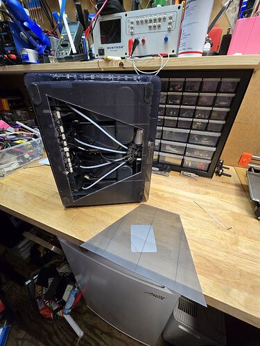

Yes I cut the bottom out of my AMS

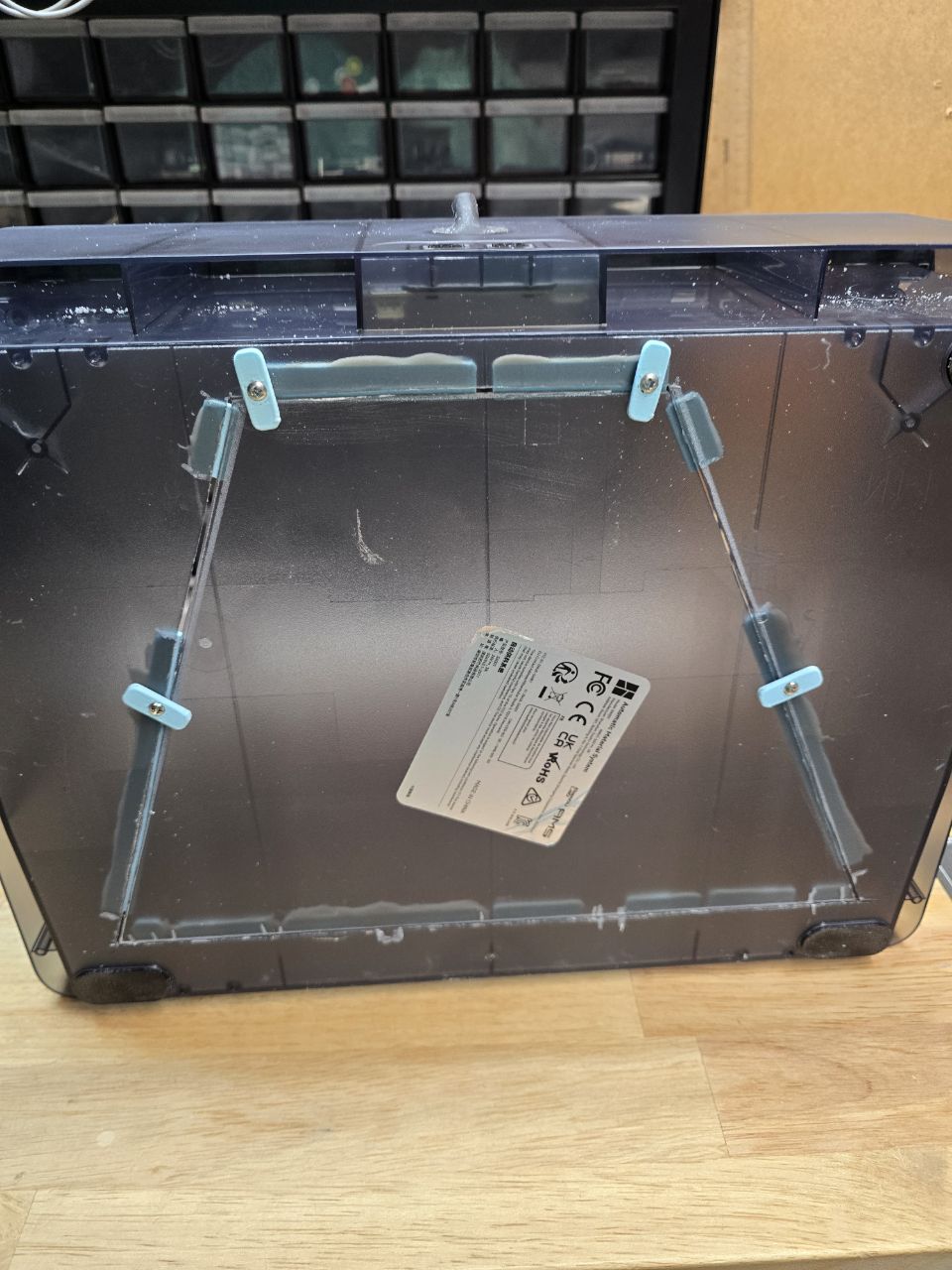

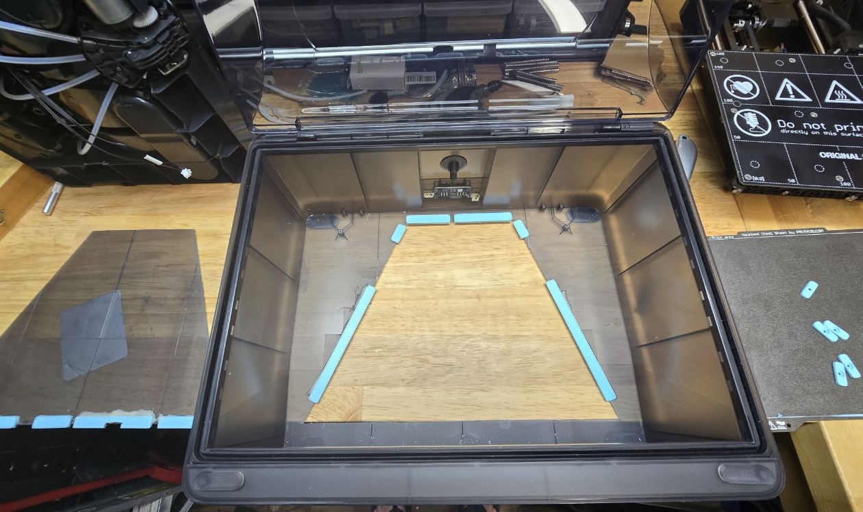

Got tired of taking it apart (twice was enough) so I cut the bottom out and I am going to do it to the other one too. Just the frustration of disconnecting and reconnecting the cables alone makes the effort worth it.

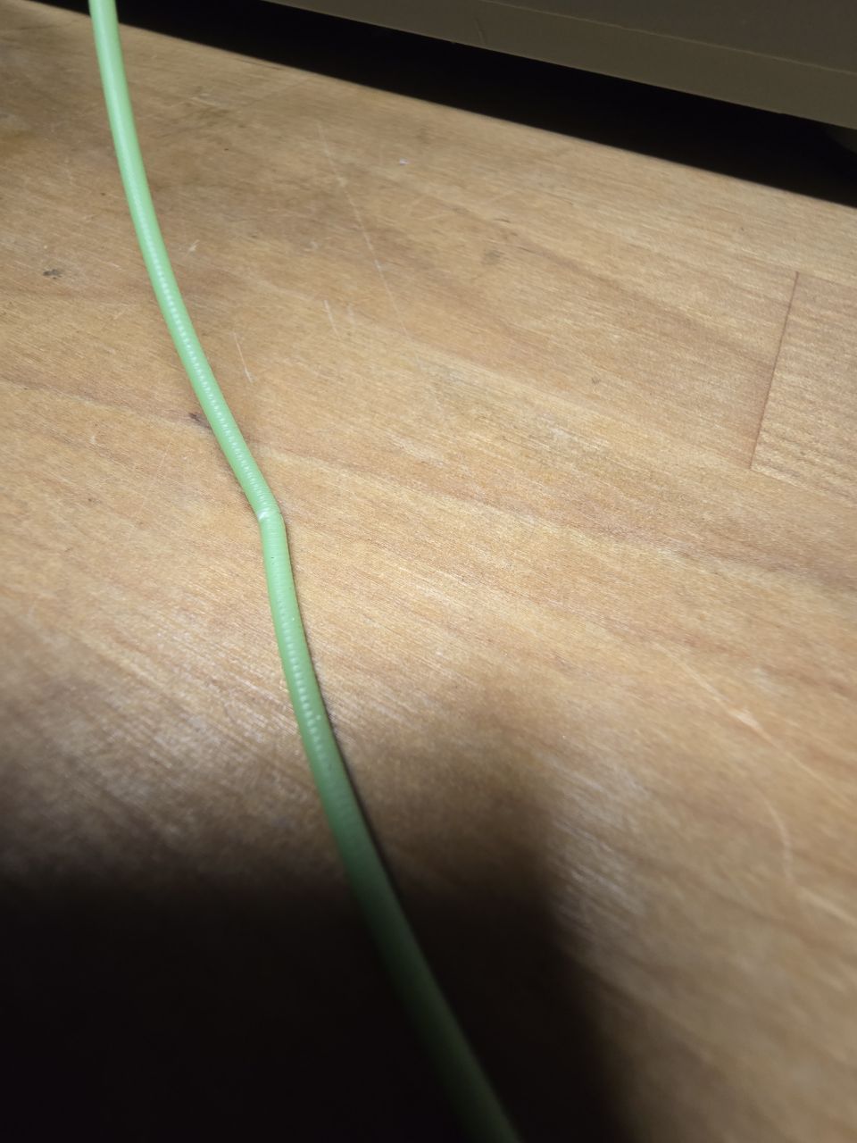

The design team should have made a service panel on the bottom to resolve broken bits of filament. Filament gets brittle from being run in and out of the AMS. Now I pull it out and test it before I run it but breaks still happen.

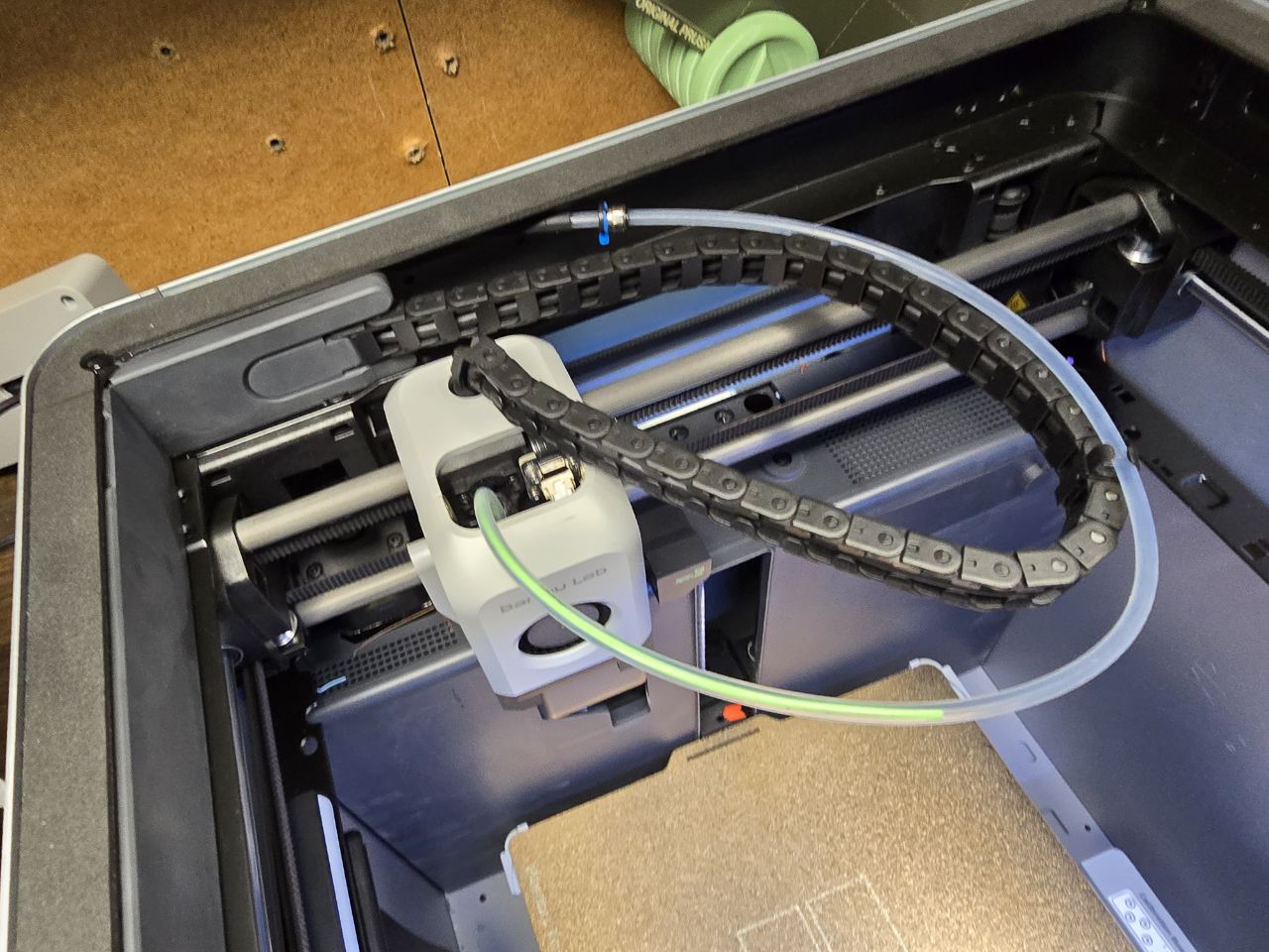

Waiting for the plastic epoxy to cure, then drill the twist latches and it’s done. Added clear PTFE tubing while I was at it.
If you want the details and the Step files PM me.

At least the next will go faster. I just have to reprint the parts in one go instead of as I create them on the first one. I really didn’t want to spend the time on this… ■■■■ happens.

First one yesterday was Voxel. Today is Esun. It think its from being run in and out + age. I have some Prusa galaxy PLA that worked great the other day but I did remove about ten turns that where brittle in random places. It is a bit old but the quality of the prints with all 3 has been great.

I crack myself up when I am doing these kind of mods. I have big hammer hands so getting at those connectors is ridiculous…
I even removed the hub and pointed it out the back to the left side to get rid of the loop friction and shorten my runs… The AMS’ motors struggle a lot less now.

It ain’t pretty but it works. Next I break out the AMS capable TPU and design slightly taller feet for it. I don’t have to ever look under again hopefully.
My theory is the filament gears might have something to do with the brittleness of the filament. The problem “seems” to happen on filament that has been fed in and out maybe even multiple times. Get rid of that and the rest seems fine.

It had nothing to do with the filament being in and out of AMS or age. The filament was too wet. The brittleness and the breaks were due to the moisture in the filament. Even for me who have never dried PLA so far, I wouldn’t have used the filament without drying first.

Again, I wasted a bunch of filament on a few rolls and found that where they have been through the gears, they were all more brittle.

If mine does it again (and it likely will) the bottom pops off easy, problem diagnosed and cleared relatively easy. Onto cutting my second AMS tomorrow.

Having say that, wet and brittle filament will keep breaking inside the AMS no matter how good the AMS is. Funny I said that because I have never dried PLA filaments but before use I do check to make sure they are not so wet that they become brittle.
