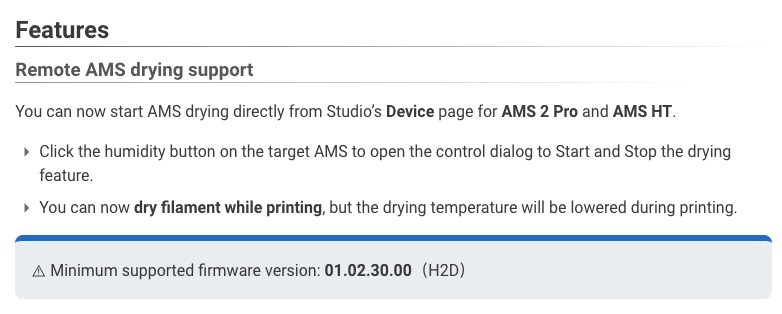

Has anyone noticed this or tried it yet? As a noobie to Bambu software, it seems like something everyone was complaining about. Just surprised that there was no topics about it yet. So, is this the real deal or am I not interpreting right?
Long time uses, please chime in. Release notes found here.
Features
Remote AMS drying support
You can now start AMS drying directly from Studio’s Device page for AMS 2 Pro and AMS HT.
  • Click the humidity button on the target AMS to open the control dialog to Start and Stop the drying feature.
  • You can now dry filament while printing, but the drying temperature will be lowered during printing.
Note the highlighted statement at the bottom:
This firmware hasn’t been released yet.
I recall this being discussed in at lease one other thread, if not more, but I don’t remember which thread(s) it was. The point being discussed was that it was only for the H2D and will be trickling down to the other printers over time also if all goes well with the testing.
