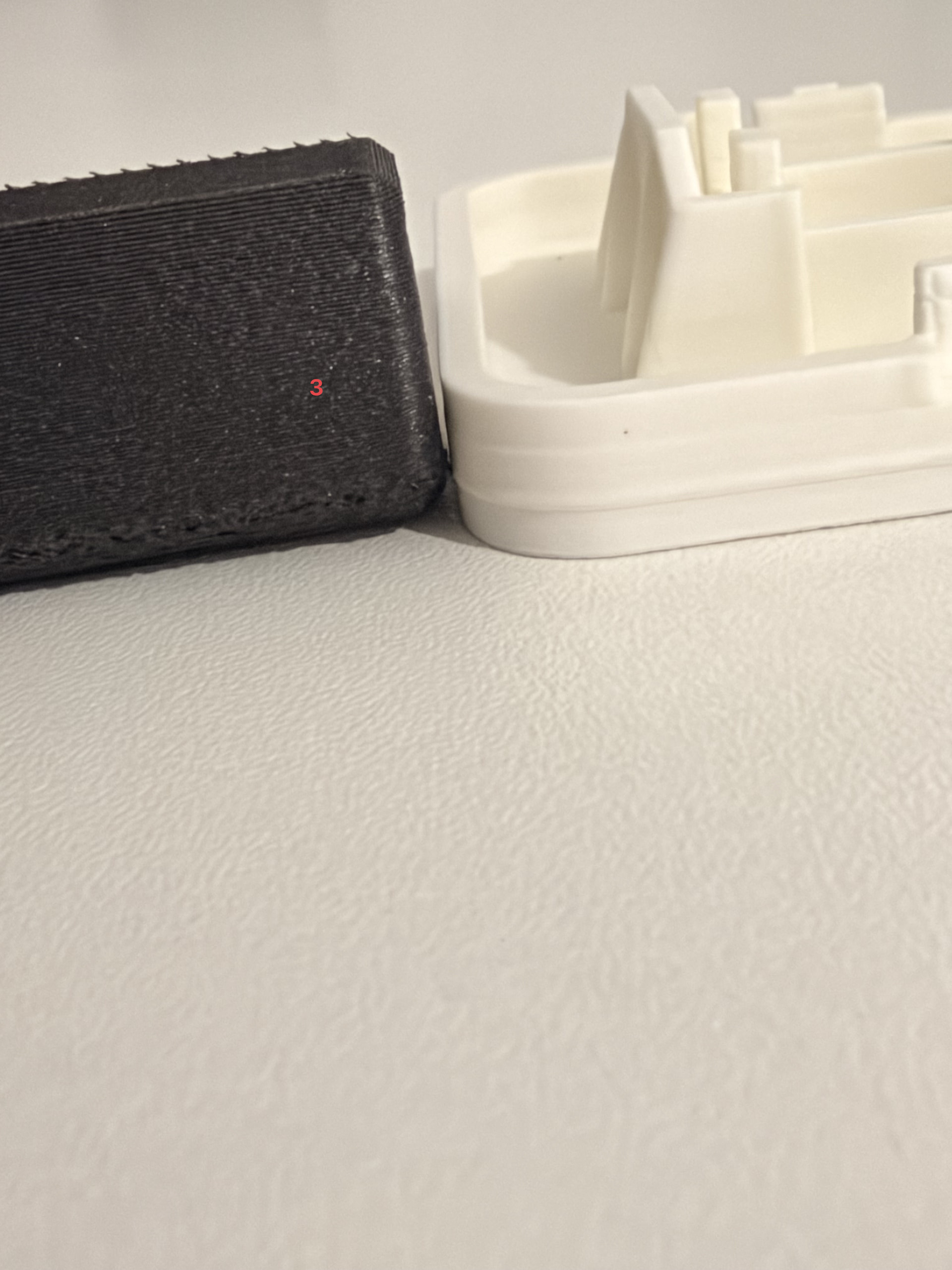

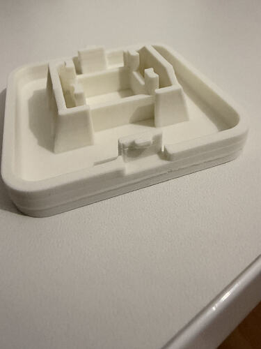

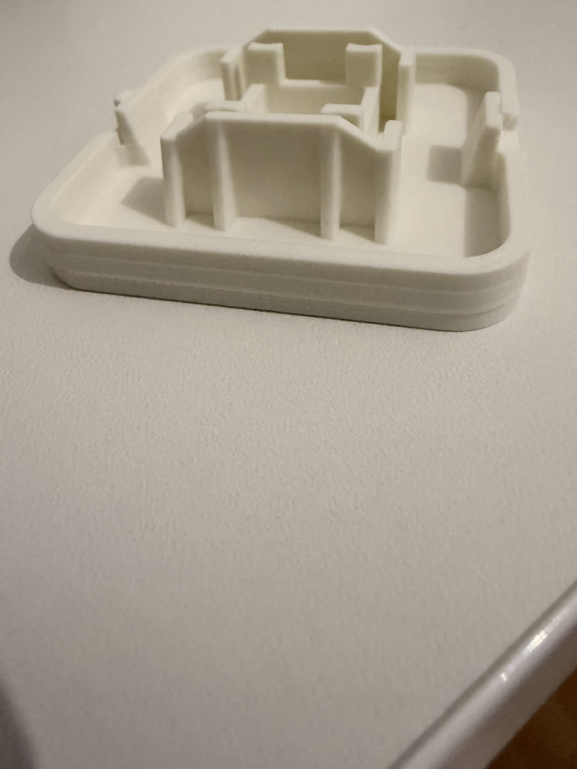

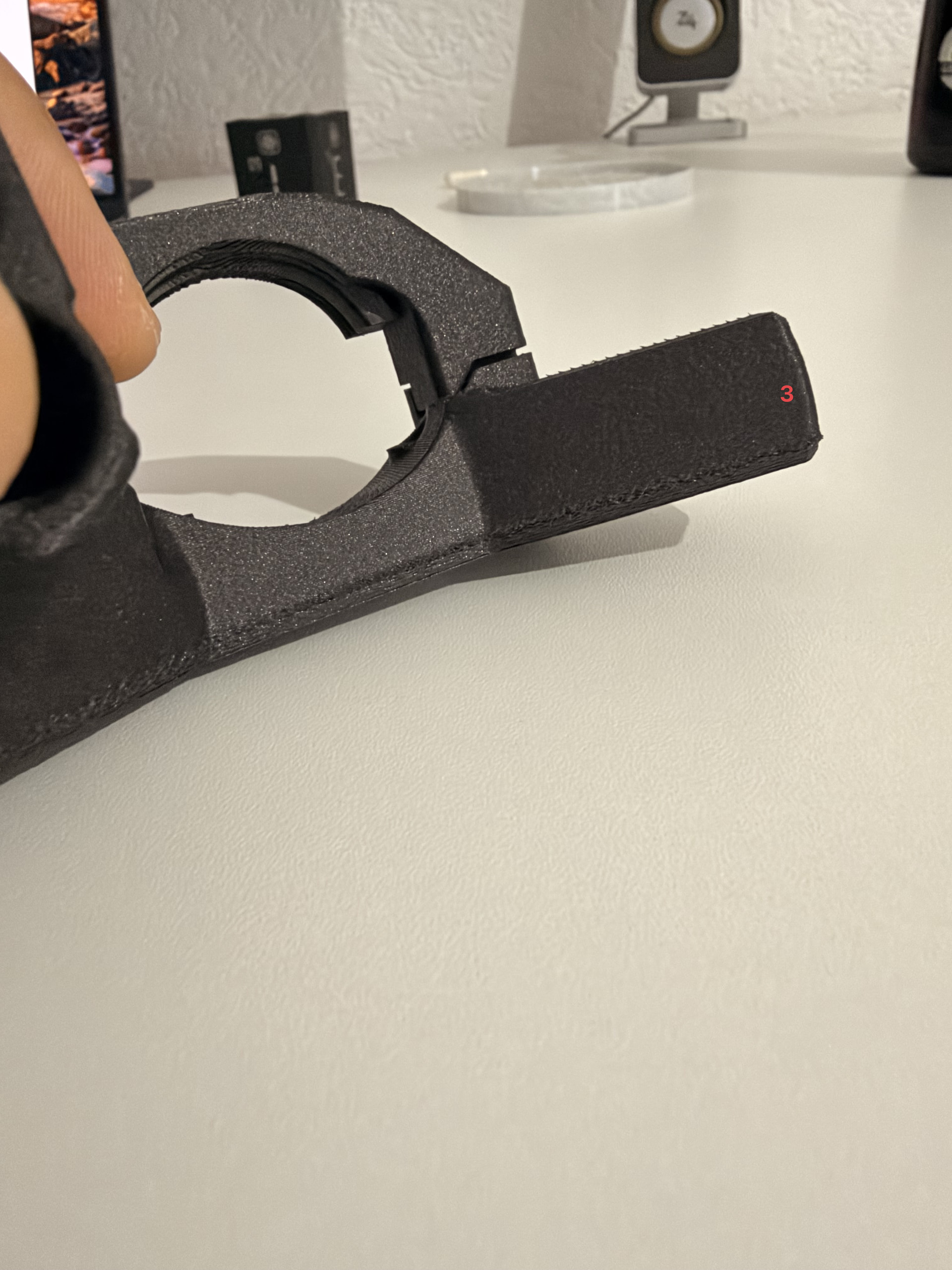

I’ve noticed a little hiccup on all my prints at one specific z-height, there’s a slight layer shift there, or does look like since it does not look like it would shift only on one side, it is on all side! I haven’t touched anything on the printer, and everything above that spot looks perfect. I can’t spot anything on the axes that might be causing it. Any ideas or tips would be super helpful!

Cuz it looks like a shrinkage/benchy hull line. Thats a googleable phrase for a huge rabbit hole. TL;DR: Large flats tend to shrink differently and more viciously than walls with infill behind them. The layer you transition from mostly walls to mostly floors tends to shrink/cool different. There’s often not a simple solution and is enormously geometry dependant.
That link may still be of value. When you have big flat areas before the model is actually done, the printer slows way down to print the first layer over infill and again on the last layer for best finish.
What this does is adds lots of cooling time to the previous layers which can throw off dimensions and make layers go wonky.
The Bambu tutorial should cover things like adding chamfers and other features, even if not visible, that help make those transitions more gradual to minimize those layer artifacts.
If that specific height comment happens on other models then maybe there’s something else. But if you mean other copies of the same model, or even other models with the same/similar features, then bet it’s the discontinuity in layer print times.
In Studio you can color the rendered images by layer time. Bet you see a big change right at that line.

In the picture, the shifts correspond to layers with changes in the model— the top of the interior floor, the bottom of the wall notch.
Are you saying that the shifts occur in all models at specific heights above the bed?

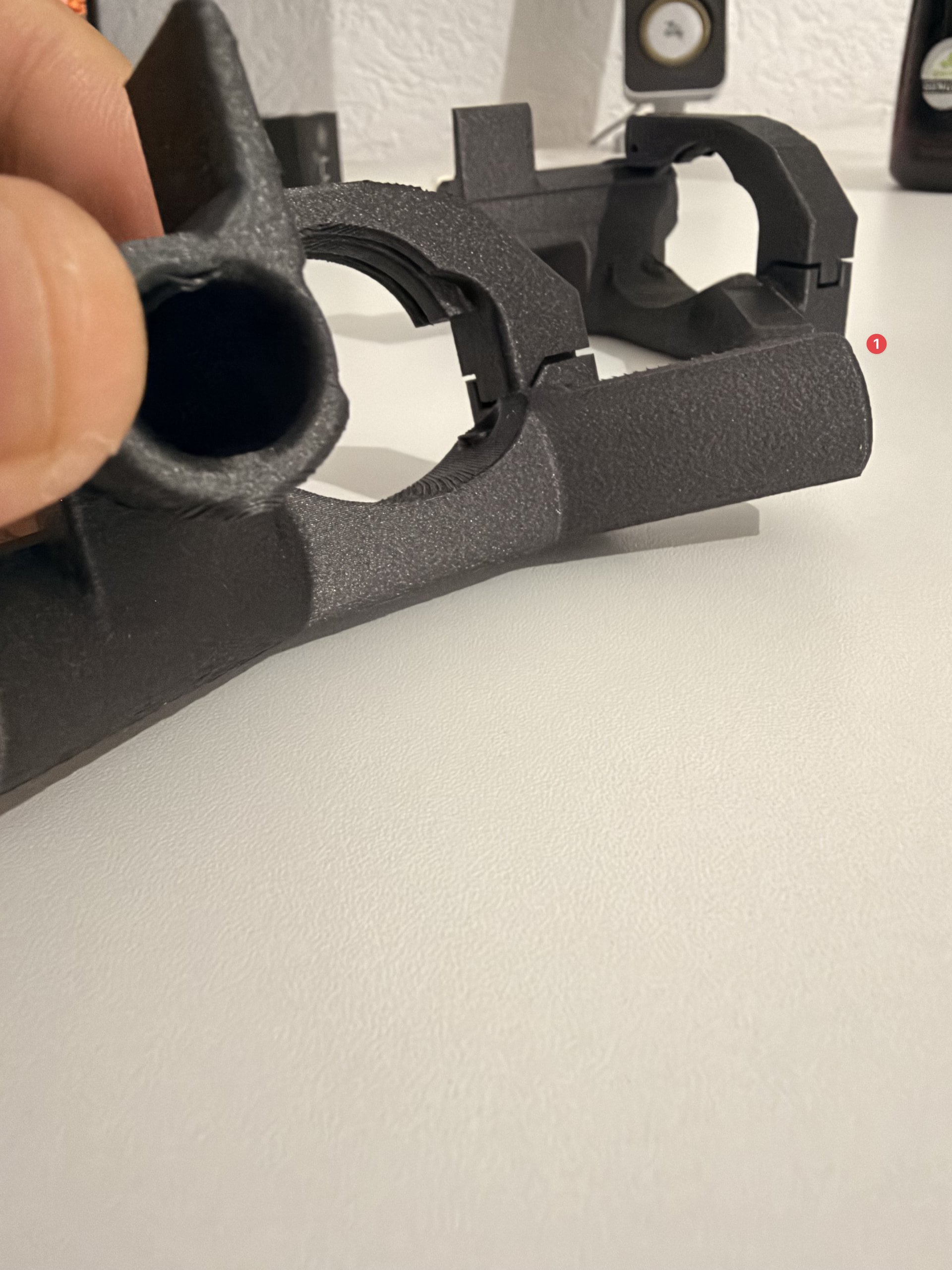

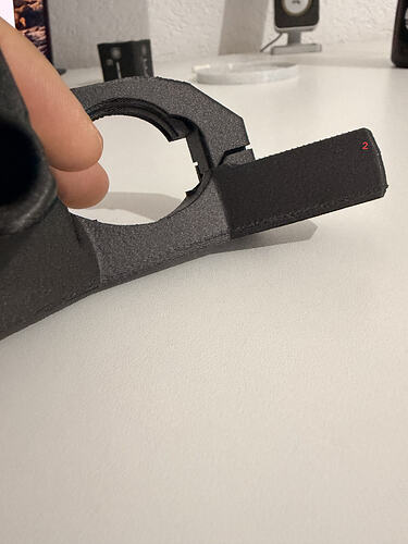

Here are some images. The black print was made in PA6-CF, and the white prints were made in PLA. I also numbered the prints: print 1 came out first, followed by prints 2 and 3, which had this issue. After that, the white prints continued to have the same issue.

I was able to identify and resolve the issue. I found compressed particles and dust accumulated on the linear rails, which were very difficult to remove. After thoroughly cleaning the rails and lubricating them with the supplied oil from the toolbox, the problem was resolved. The Z-axis linear rail bearings had been rolling over the compressed debris, causing slight movements and affecting theses “shifts” on my printed objects.

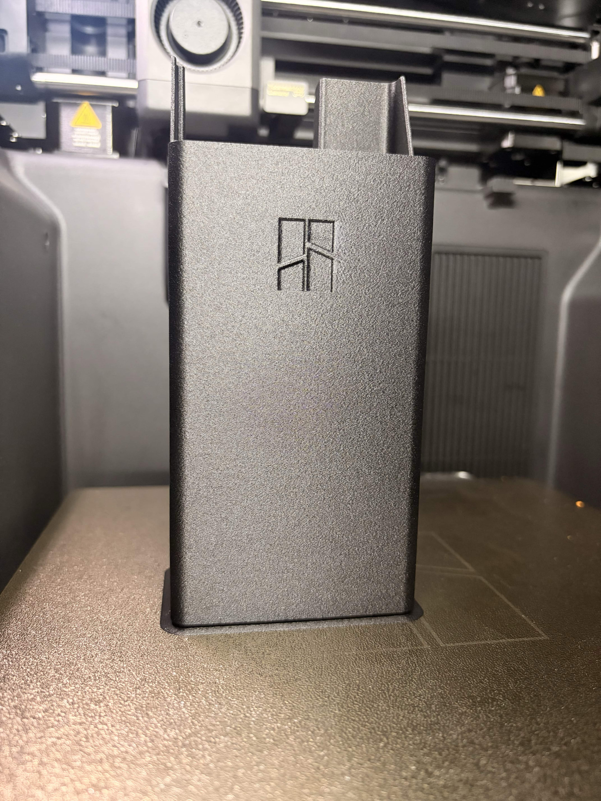

Here is a flawless print, printed using Bambulab PA6-CF
