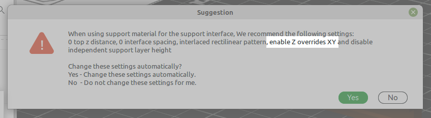

So, I’ve decided to redo an older model to test this some more, and I noticed this dialogue box pop-up that says to set top z to 0, then to check the z overrides x/y box (when using support material). That’s an obvious mistake IMO.
This much bigger model has a small 5x3mm slot inside around 3 sides, about 650mm length total. There’s no way to use trees, so I’ve always used snug supports in this slot. It used to take me an hour or more to clean out the support stuck to the model in there and looked awful when done. So, I’ve just sliced a little 70mm test piece and printed it with the new setting. I took me about 5 seconds to pull the support and interface filament out and it looks great. Nice.
