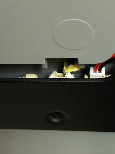

This is just for the newbies out there that just received their P1P and bed temp reads 0 and/or won’t heat up.
There is an article on this from the Bambu Labs site that I dutifully followed but the solution was something else!! One of the two pin connectors was NOT inserted under the bed even though it has evidence of glue. I don’t know if this was manufacturing mistake or what but the bed will not heat until this connector in seater properly. Yeah I’ll silicon it in place later. Currently printing my first benchy in supplied white PLA. See pic of connector.

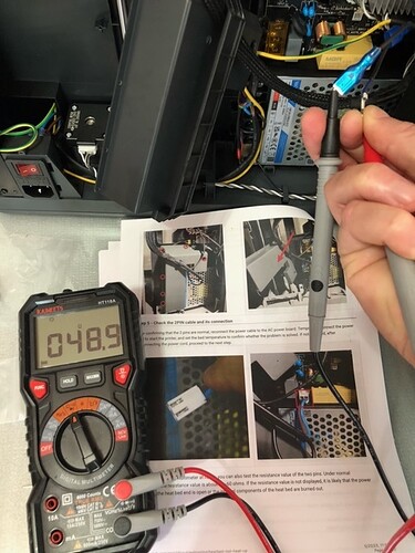

Generic article from Bambu Labs that was interesting but didn’t help. However, now I know my bed heater resistance. LOL
Troubleshooting of heat bed not heating up | Bambu Lab Wiki

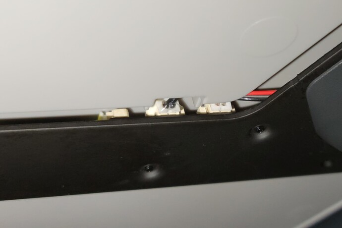

Are you just looking for a pic showing the orientation and polarity?
If so, this is what I’ve got. But I’m having a hard time get a clear shot. I noticed the notch is on the bottom like the plug beside it.
Thx for the pic. If it’s a thermistor then there is no polarity but I don’t don’t what those are. I’m wondering if anyone has an actual schematic of the bed heater. Meaning what is connecting in the right socket and what is connected in the left?
