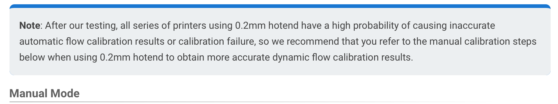

Let’s be specific about OP’s problem I’d say, .2 nozzle is unique.
.2 Auto calibration fail:
While A1/H2D’s auto calibration produces pretty useable results for .4/.6 nozzles, bambu wiki explicitly say it doesn’t work well for .2 nozzles. .2 Pre-print auto calibrations also tends to produce swollen corners so you are not seeing bugs.
Manual calibration for .2
This is an issue specific to .2 nozzles. Don’t use the manual ‘line’ method, it’ll produce drunken results, go straight to the ‘pattern’ method.
.2 nozzles typically produces much higher ‘optimal’ PA value than .4 nozzles. .4 PAs for filaments typically won’t exceed <0.04>, but .2 nozzles can reach upwards of <0.2> in values (PLA, PETGs). Prepare a boarder value range accordingly.
That said, .2 is tiny, don’t be surprised if line to line results are hard to tell apart, so pick whatever you felt is good enough, or use a high zoom macro lens cameras etc. I hate calibrating .2 for this very reason, but I’ll still do it for quality :tm: :sweat_smile:
I also recommend that you check/calibrate flow rates again after manual PA is saved and applied, .2 nozzle prints are just pretty sensitive, I’ve found that manual PAs needs a new flow rate for best top surfaces. But once you do, it’ll be gorgeous.
