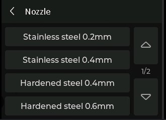

In the slicing software the Diameter of the nozzle is 0.4mm the nozzle in the printer is 0.4mm I slice the file then Print Plate and get a maessage that makes no sense ie: (The current nozzle diameter (0.2mm) doesn’t match with the slicing file (0.4mm). Please make sure the nozzle installed matches with settings in printer, then set the corresponding printer preset when slicing.)…
I have only 4 nozzles one orginal Bambu one one that is 0.2mm and is unmaked the others all have 0.4mm on them so what is going on
Bambu A1 Mini Bambu Studio veraion 2.2.1.58…
Does not matter what file I use the same thing happens…
Help please if you can I’m very new and tech is not my first second or even third and I’m 74 and a bit…
Cheers Merlin…
…check what nozzle you have in the printer menu (you probably have it set to 0.2, so change it to 0.4)
