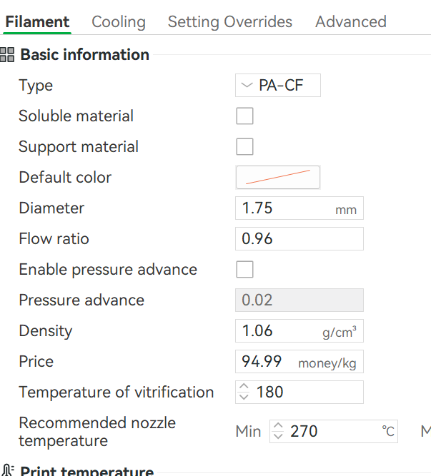

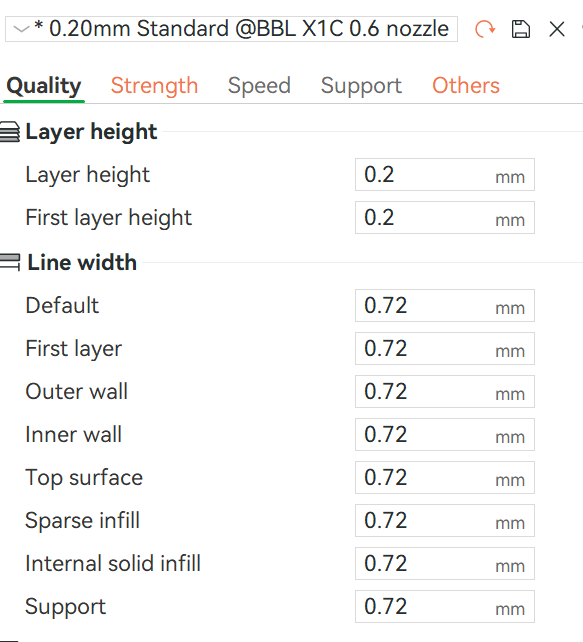

0.6 Nozzle PA-CF line thickness 0.1 thicker than settings
i have been working with a 0.6 nozzle and am sooooo confused about what is happening, i set a line thickness of 0.72mm, printing PLA is perfect and i always get a 0.72 wall.
but when i print using 2 different PA-CF filaments i get a wall thickness of 0.81 / 0.82 one of those filaments is the bambu own.
can anyone think why this would be as makes the parts im making wrong.

Stupid question - how did you calibrate your flow? and can you show a pic from the filmanent setting and your quality setting?
Sounds like you calculate the flow / extrusion multiplier the wrong way around (if it gets bigger). What line width is shown in the slicer preview?

Preview shows line width at 0.72.
Is the filament setting still the stock setting (Bambu PA-CF)?
If yes, where did you follow the calibration guide from SoftFever? With the walls so much off, I would expect that during calibration you recognized over extrusion with almost all of the first phase of the calibration activities (0.85 to 0.72 appr. 10-15% over extrusion). And for this a value of 0.96 flow ratio seems too high.

So, you say that if you print with the updated profile which has a flow rate of 0.785 (instead of 0.96 you show earlier) that you still are off by 13%?
