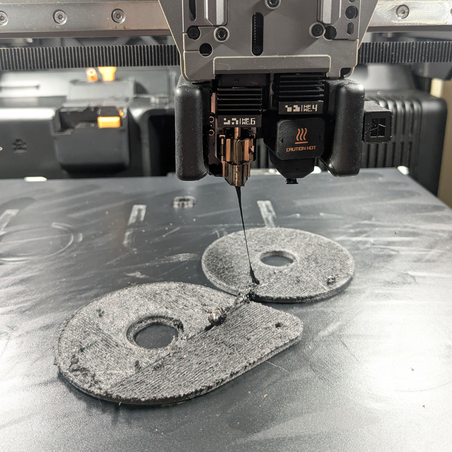

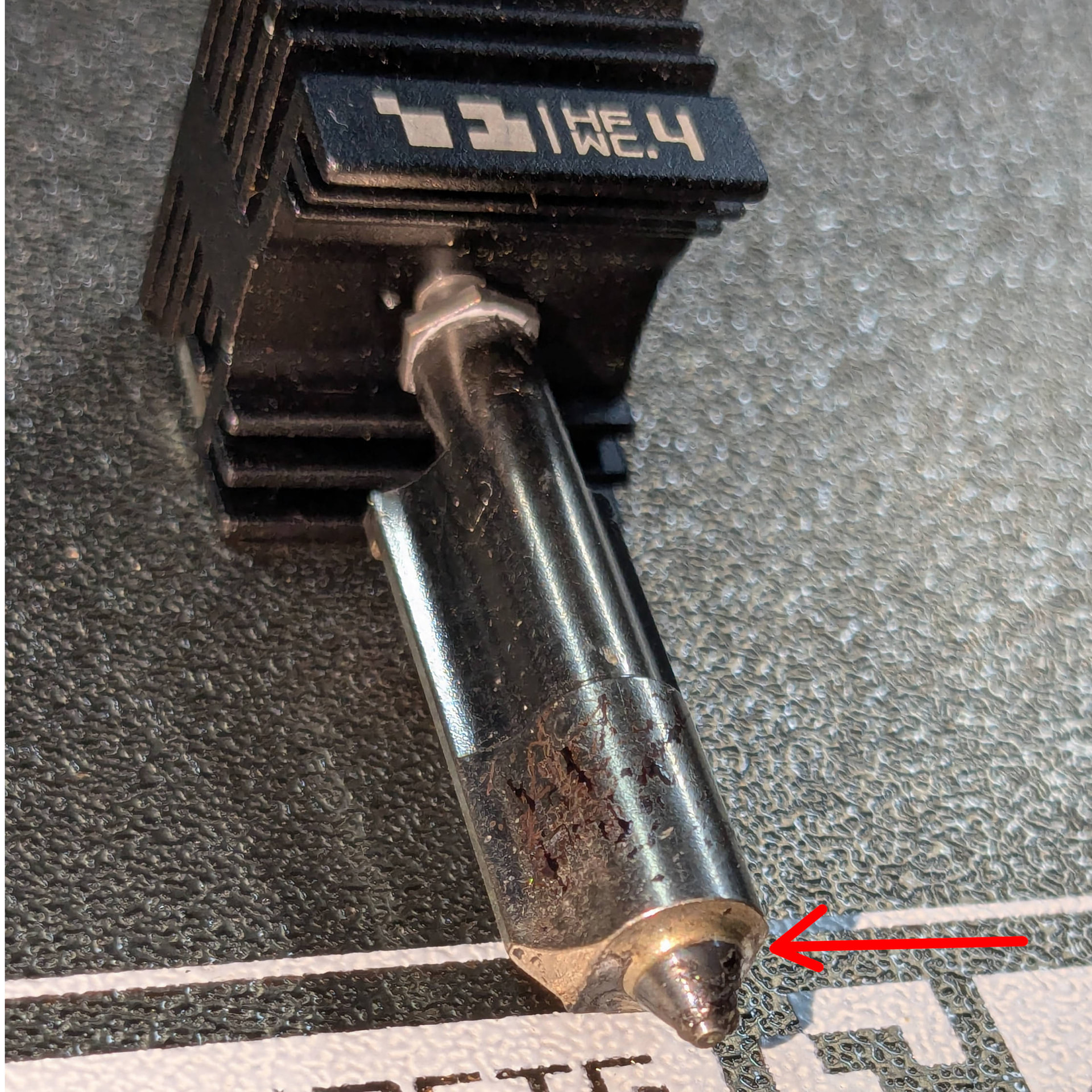

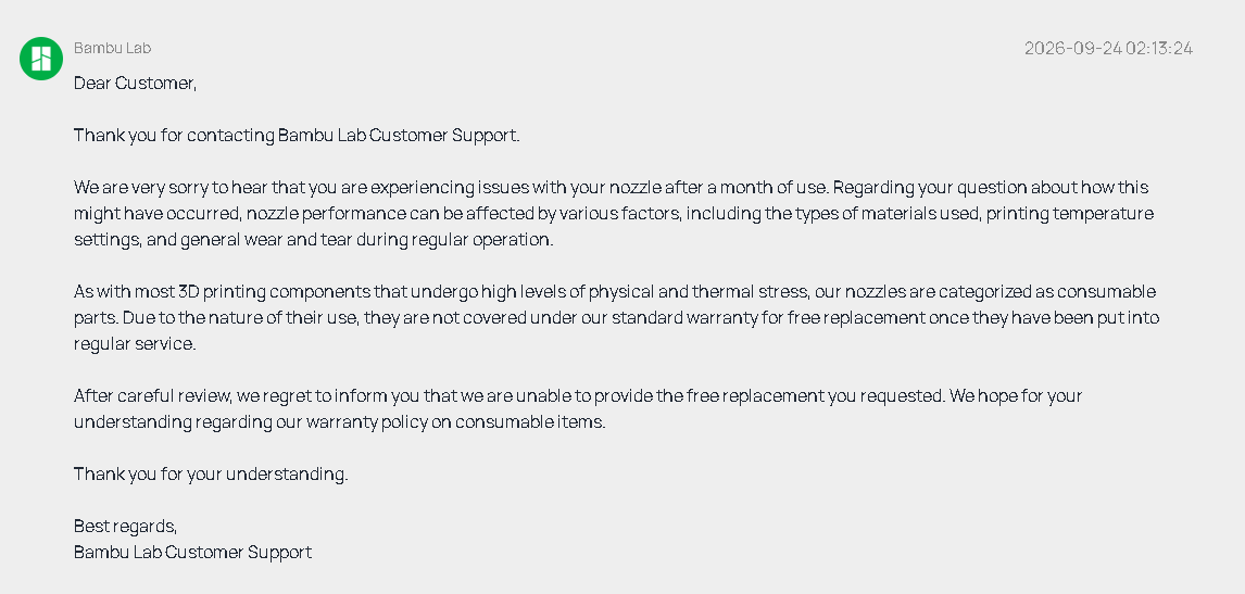

Anybody have/use any of the 0.6mm high flow tungsten carbide nozzles for H2D? Nozzle 45 days after purchase (purchased 8/2/26) blew apart (9/22) and Bambu says ‘no warranty’ on consumables… This isn’t a normal consumable failure when it blows apart at the braze joint…

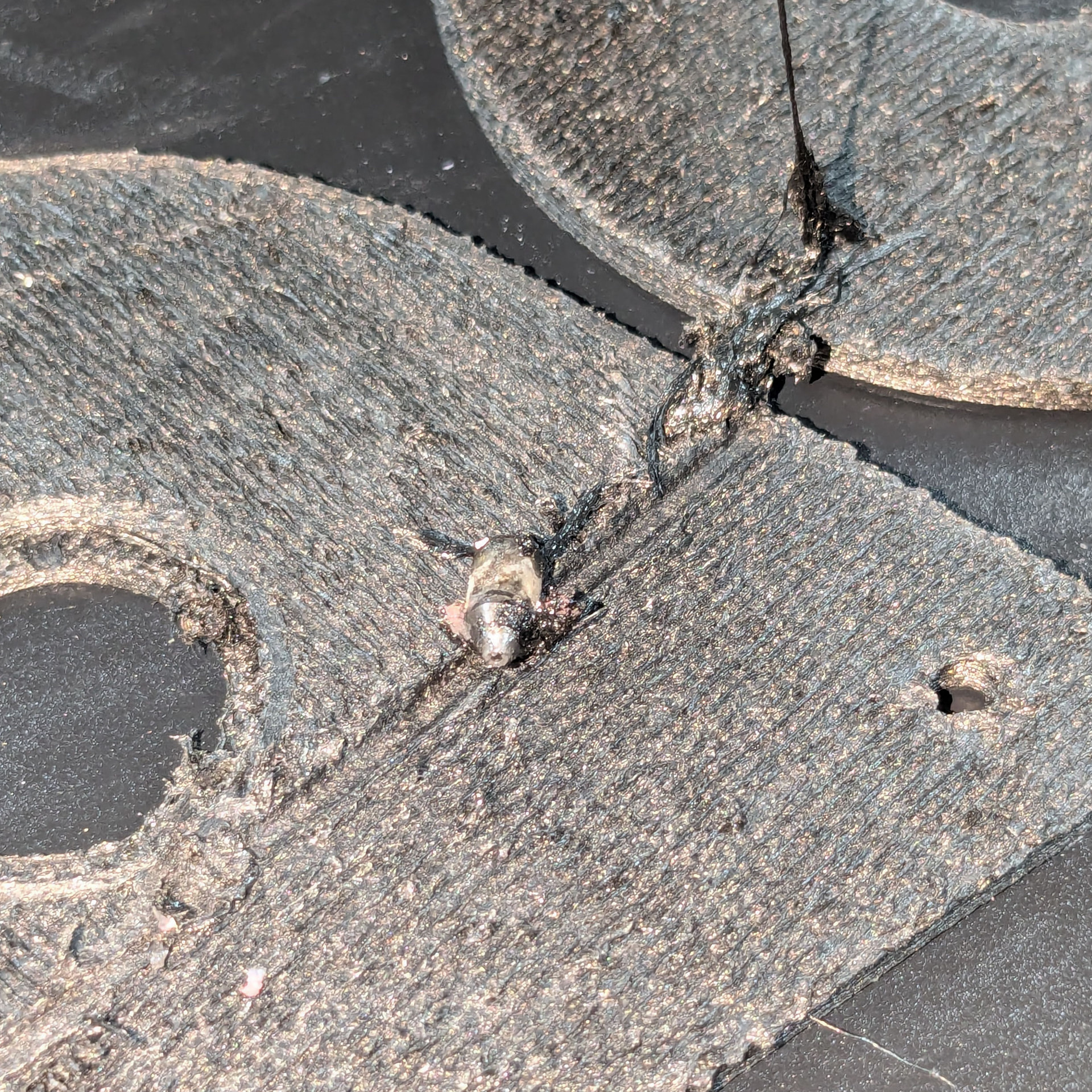

Material in print is Bambu PA6-CF, 3rd attempt for this part with extremely poor printing, then printer starts making horrible noises… go over to find this:

Unfortunately, this is a common issue with Bambu hotends. I’ve seen it happen more than once on my X1C. The nozzle itself isn’t soldered or welded in place; it relies on a very tight “hot fit” within the hotend body. If it is subjected to high pressure while heated to over 300°C, the nozzle can pop out of the hotend and go off on a journey of its own.
Given that this was an HF nozzle, it was subjected to higher-than-normal pressure. In any case, this points to poor build quality.
Sigh… that is not a wet problem (humidity was at 9-11%). Ever seen a print where the nozzle is moving around while printing problem before?
Was the nozzle loose and moving around on the first layer? The sidewall looks like very wet PA-CF. Just giving a tip. Ever seen hydro forming? Or have you ever made a bottle blow up using water and magnesium-iron alloy powder plus table salt? Hydraulic pressure is a ■■■■.

Last thing, if it had been loose for a while, filament will flow out of the gap and cover the whole nozzle. This looks like it popped of cleanly. Just for future reference.

It’s not even brazed…although that seems like a good solution to fix them.
Bambu OEM nozzles blowing apart when printing high temp is a known issue, and Bambu is really dropping the ball by not making this right. @SupportAssistant nozzles falling apart is not happening due to wear - this is a design or manufacturing failure.

Hi there,
Sorry to see that your nozzle has failed like this.
Can you please send me a private message with the ticket ID so we can look into this and find a solution?
Thank you

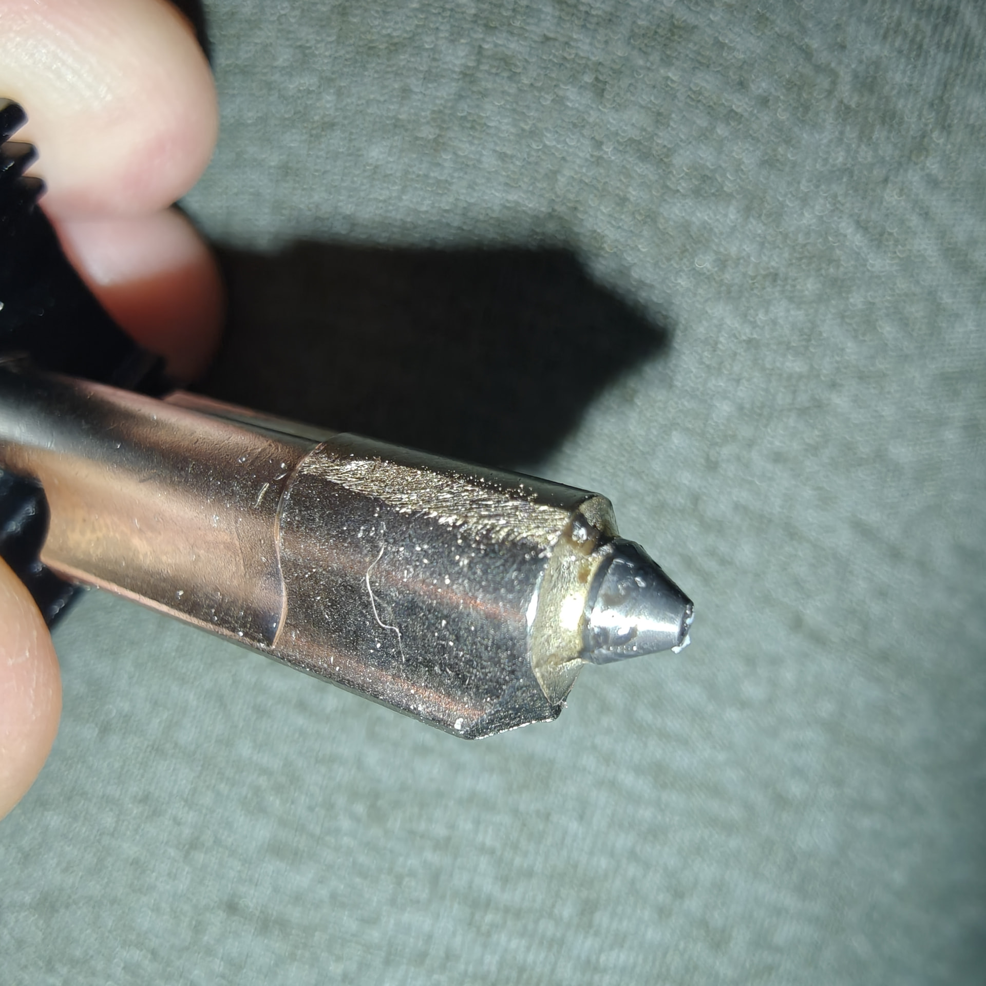

Immediately after I saw what happened, I grabbed my spare high flow 0.4mm carbide nozzle for inspection… Am I assuming wrong that this one is brazed? (I’m seeing the yellow bronze filler…or something similar?) Can’t say I actually examined the 0.6mm before installing it though. If it is not brazed, and only press/heat fit that would explain the situation completely…and it would be an absolutely stupid design/immediate recall situation. I’m going to have to clean up the 0.6mm nozzle pieces and see if that one is similar.

Message sent; Ticket No: US260923530001

What do they mean no warranty on consumables? Is this a joke? I call this a BS.

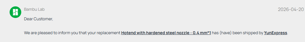

I went through a similar situation and their support replaced it without asking any questions. Here’s a proof:
That’s on a nozzle that was 6 months old btw.
Call it whatever you want…
@SupportAssistant take a look at this person’s case. Your support person on this case was on crack or something.
And yeah, the tip insert yeeting itself out is a 100% nozzle defect that has nothing to do with being consumable or wear and tear.

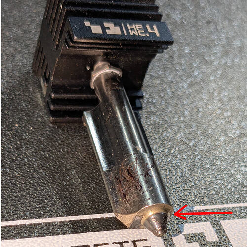

I think the main body of the hot zone is plated brass - it is extremely soft and files very easily, and is exactly the same color as the area you indicated.
If that’s the case, I think that area just doesn’t get plated.

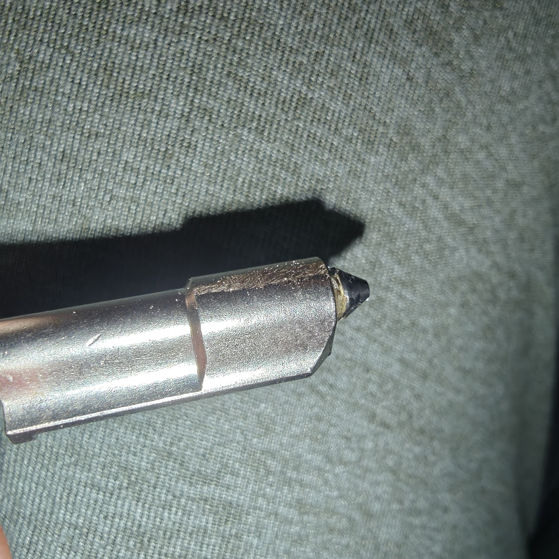

I don’t recall where, but I’m pretty sure the tips are just bonded in place with a high temperature adhesive.
Watching the tips of my WC nozzles, they seem to show a similar color flow zone where the 2 meet.
That indicates that they are brazed. I am not sure if glue would show the same visual zone.
When brazed, a poor Monday morning specimen could just slip through a quality inspection and end up in your printer.
It seems support is picking up this case already, as this case doesn’t fall under “consumed” imo. This is a failing product.
