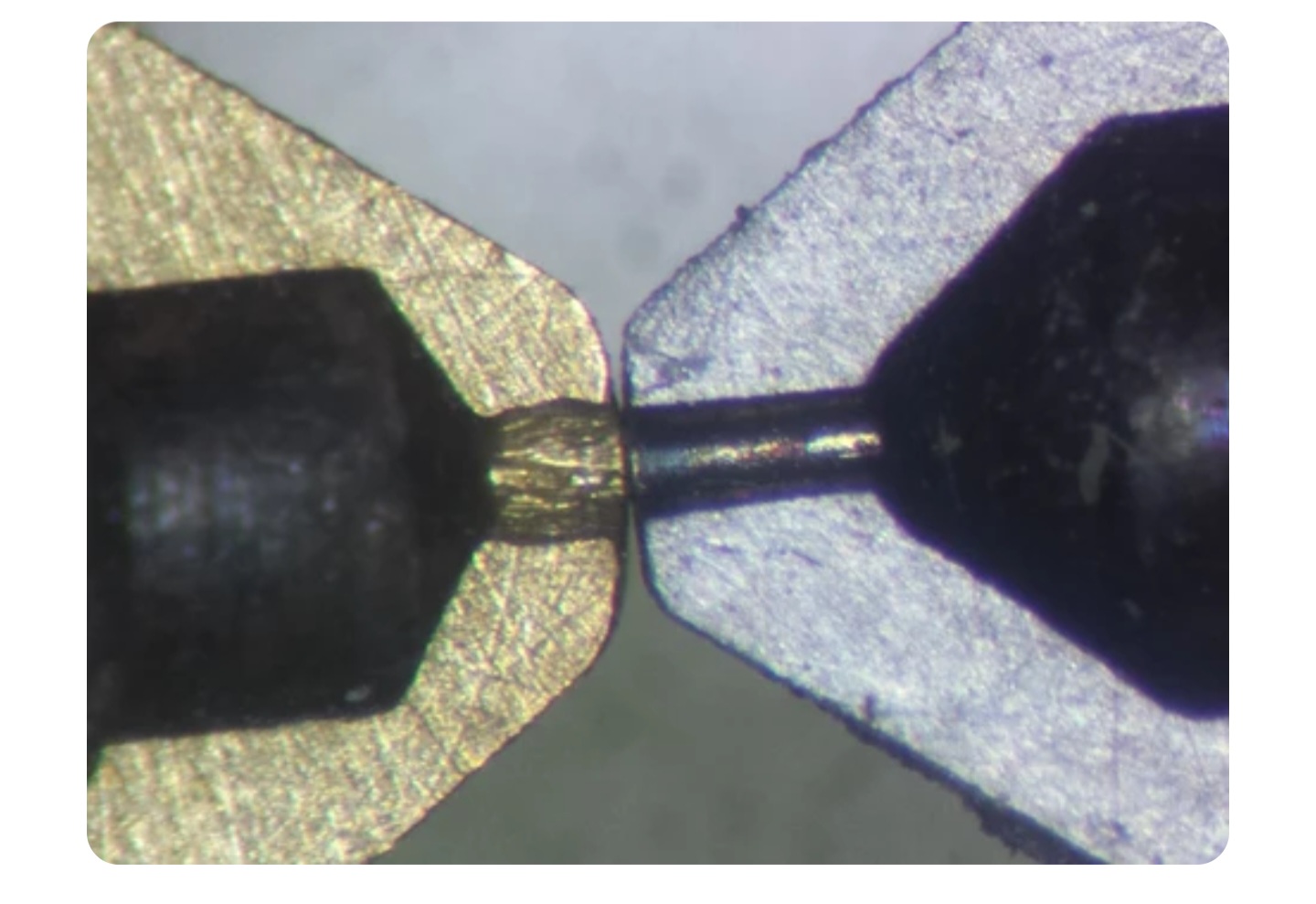

0.6mm high flow tunsten carbide nozzle failure

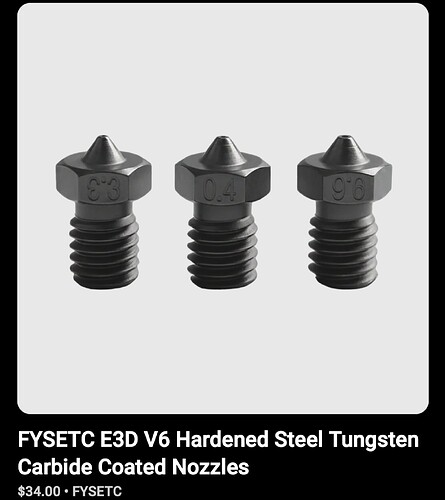

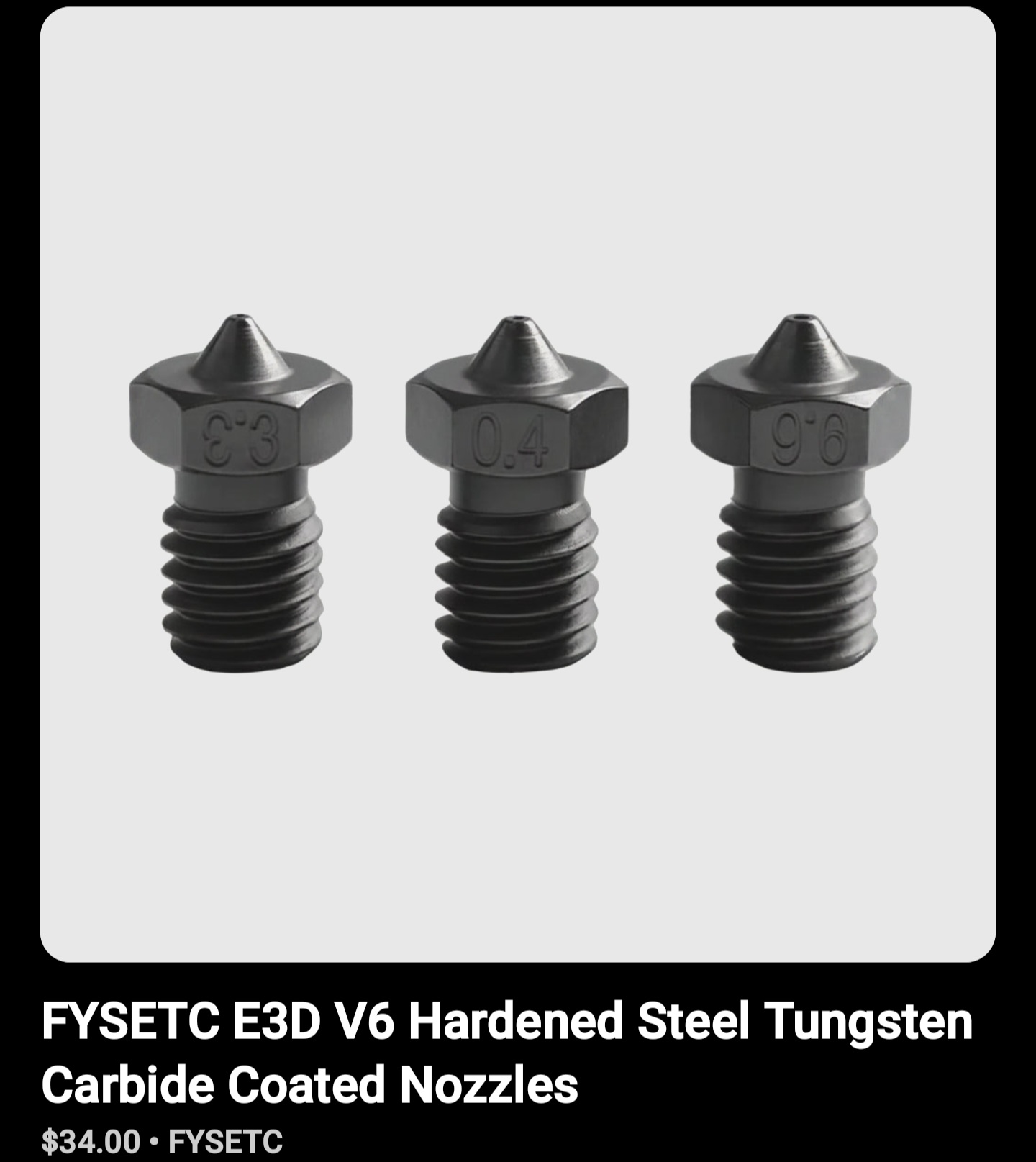

Oh nice. I guess they could just coat them then. Thankfully my nozzle doesnt drag.
I guess I was confused because everything ive ever read about them says its to protect the filament path from wearing down and widening
I dont really care if the outside of a nozzle wears. Weird product

I mean… you do. That’s exactly what’s increasing the nozzle diameter orifice that turns .4 pristine nozzle into a gaping ■■■ madness.
I would not put too much thought into this picture; at least not more than just a generic diagram of how Bambu’s CHT is “designed” to be.
All those colors are nothing more than just colors. No way they are the indication of the material used in the construction.
Fun fact(s): Did you guys know that only CHT Tungsten nozzle from Bambu has brass brazing on the tip? Regular nozzle doesn’t have that brazing. I suspect this is due to the earlier testing that resulted in an elevated defect rate of shooting tips out of the nozzle body.
Also, CHT Tungsten has bronze plated color, while regular has silver color. Why? Who knows.

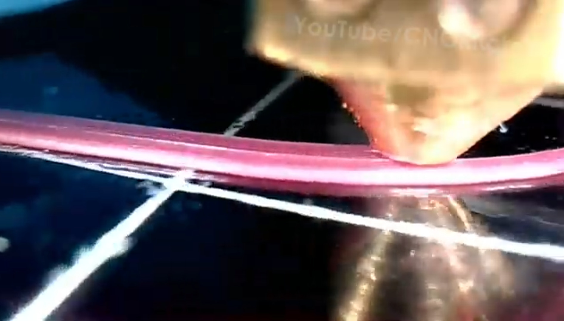

Weird how every single layer doesnt come out ironed. You need a closer shot to show whats happening. I had a macro picture a few years ago but can’t find it
Oh ok. I was thinking you could literally sand a mm or two off the tip and the ID would still be the same. The nozzle would just be shorter. My weird brain was thinking the constant sanding of the internal tube was what caused the internal tube to grow.
I found this interesting video. Not sure if it’s an animation or truly recorded as it seems physically impossible, but looks great nonetheless
Eventually the internal diameter will increase also.
It starts internally where the larger diameter transitions to the nozzle diameter. That is the location where the pressure on the surface is the highest.
So eventually your 0.4mm nozzle will become a 0.6mm nozzle.
How much the tip wears also is strongly influenced by the layer height. The smaller the layer height, the higher the wear.
As you can tell, they are 2 different nozzles, but it shows the inside of the nozzle tip. Its larger(worn), before the nozzle tip face wore down to the point that the internal tube widens. The tungsten one is still the same size…Inside the nozzle. It creates a situation where the nozzle is laying down a wider strip of filament than the printer has planned for. Means tight gaps get closed. Print in place parts no longer work etc. Now look how far the nozzle tip surface would need to wear before it got to the larger internal melt zone.

Surely the tip diameter increases also as thee fibers that are pushed around the sharp corner between diameter and tip face.
But the wear of the tip itself counteracts that partially.
The left nozzle btw. Is a very poor design with a standard drill tip angle for the larger size.
I bet we find that both are correct but everybody wants the other person to be wrong. It most likely protects the tip surface and internals. Good conversation either way.

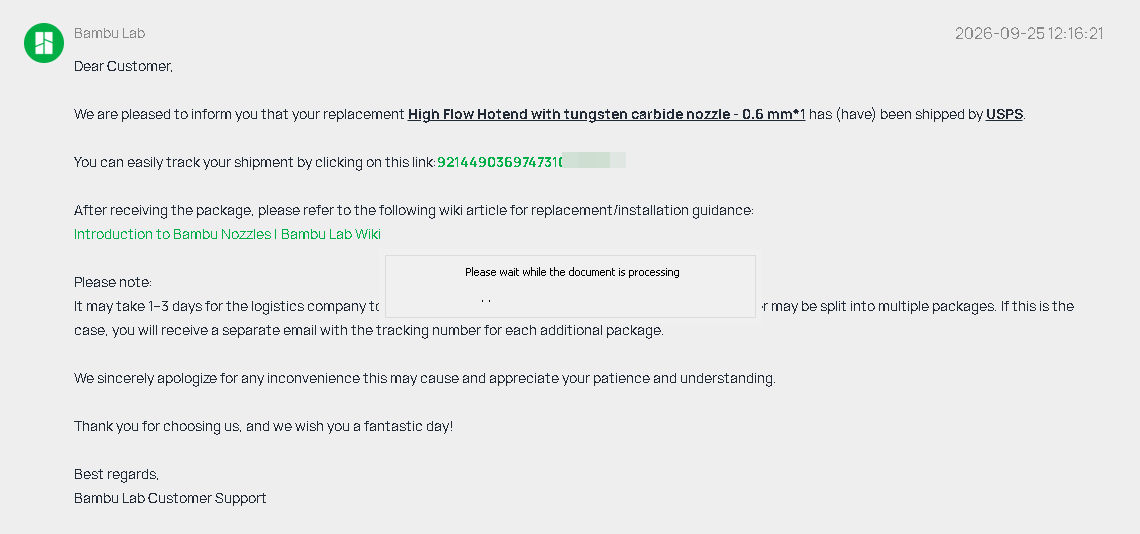

Seems Bambu has had a change of tone on the replacement, thanks to SupportAssistant

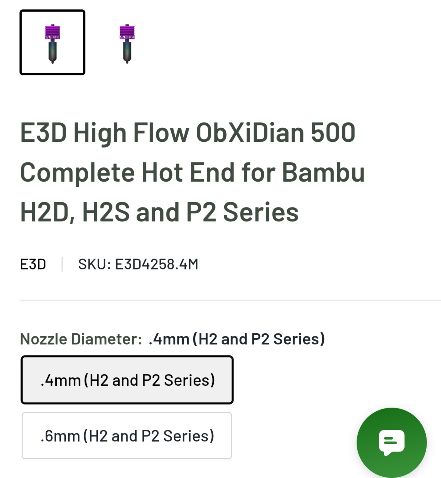

Any recommendations for a USA based seller of the ObXiDian 500? Seeing E3d, but no stock of the 0.6mm. Same with Matterhackers. Do you have any info on the actual tip material on these? And how to do you unclog them [with their 4-channel design]?
Can’t comment, I’m Canadian, but they should be very easy to find in the US.

@Abbey-Lubber try west3d.com for the nozzles

I order directly from them. Their shipping from the UK is super fast.
