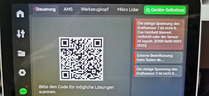

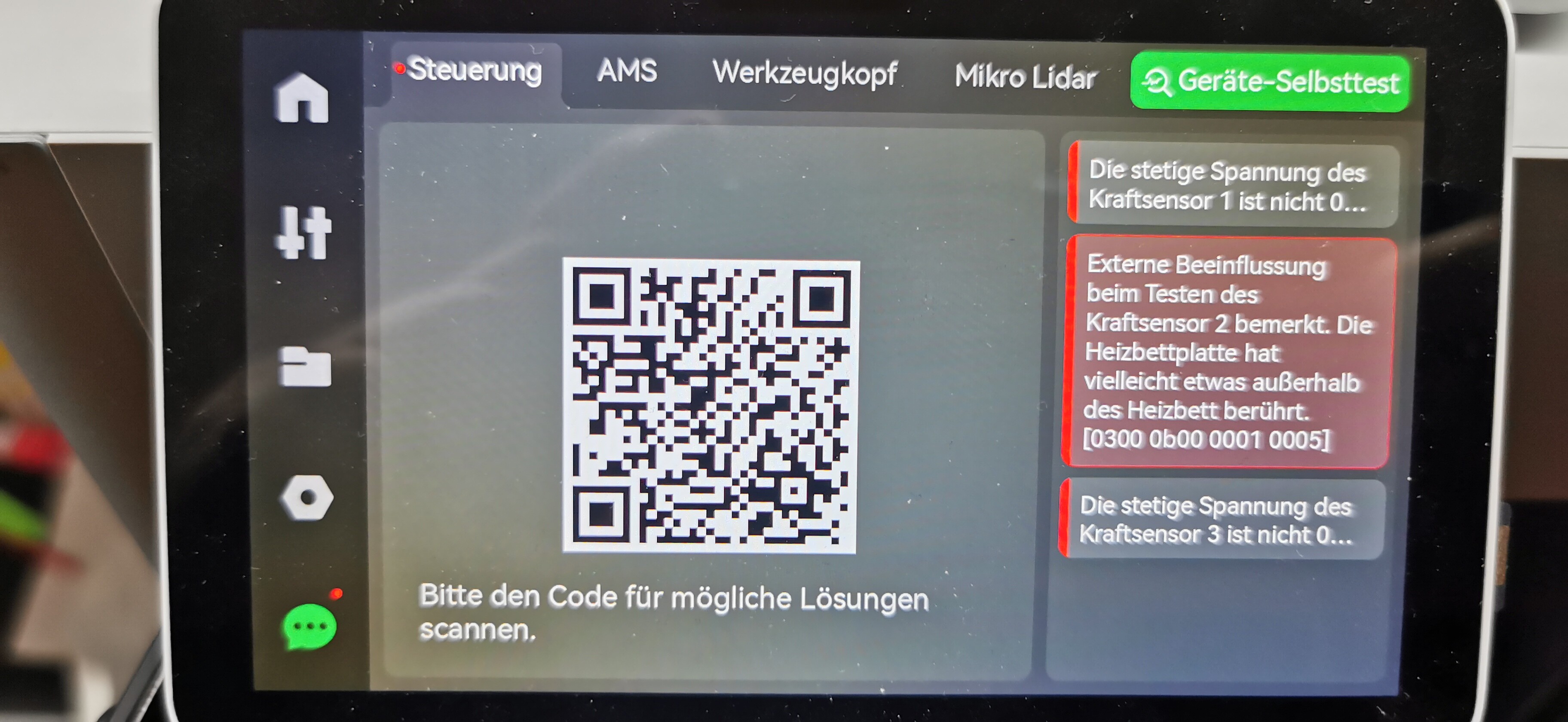

So, after using this wonderful printer for several weeks now and printing tons of stuff it suddenly stopped working yesterday.

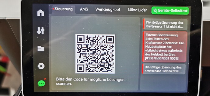

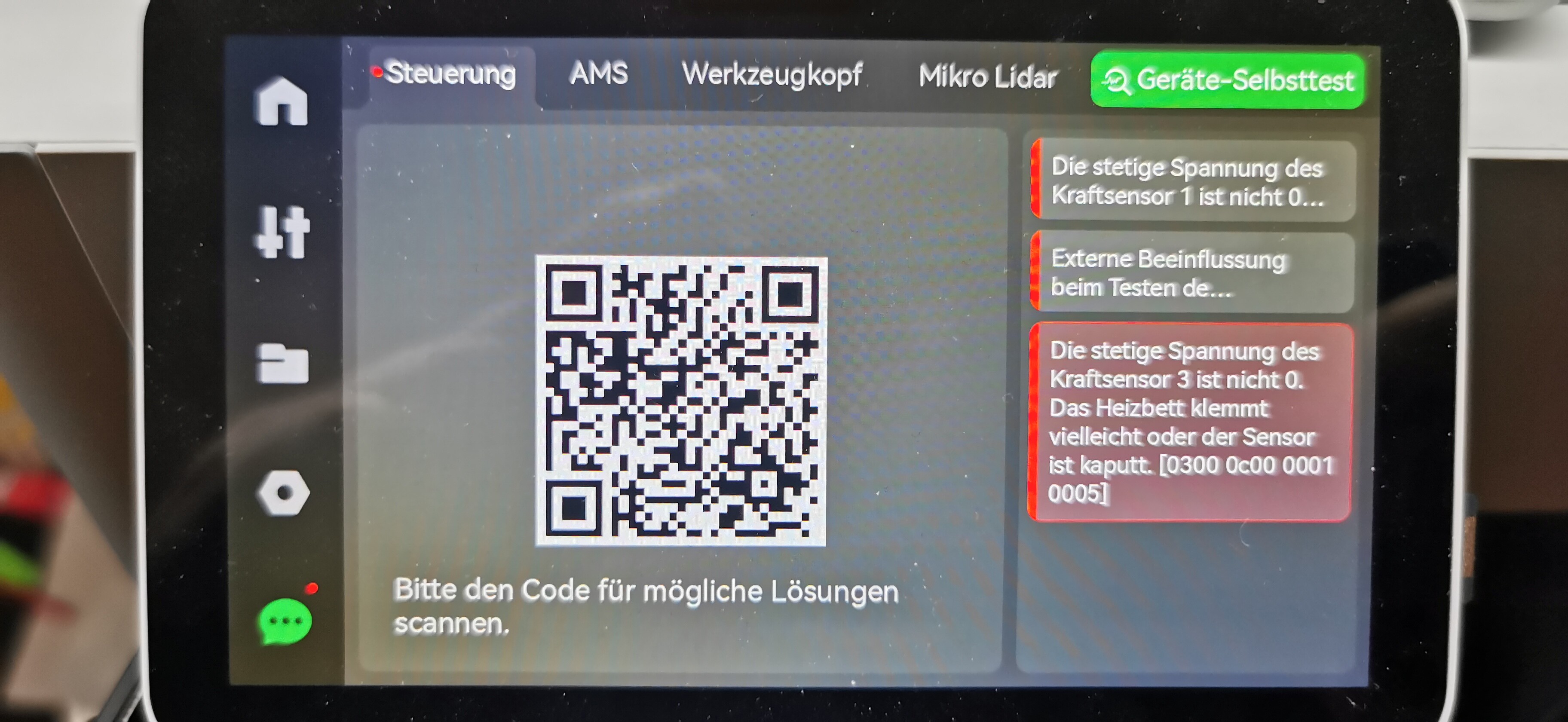

I’m getting the 0300 0a00 0001 0005 “Force sensor 1 detected unexpected continous force. The headbet may be stuck, or the analog front end may be broken”. This is for all 3 force sensors.
Checked the wiki and so far their only suggestions is to “clean” and make sure that the build plate is not getting stuck on the chute or the back of the inner liner. But it isn’t and I can actually manually raise the build plate up to the hotend and all the way down. So it isn’t stuck.
Unfortunately at the end they says “If not , then there might be some real hardware issue, see.” and nothing more :). What should I see?

Ich habe genau das gleiche Problem. Alle 3 Sensoren.
Aber alles ist sauber, das Druckbett fährt manuell rauf und runter und nichts ist fest.

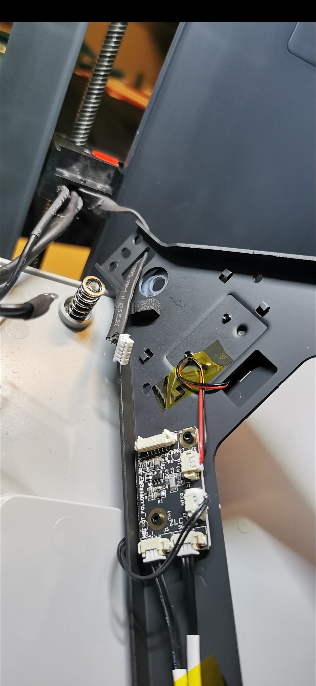

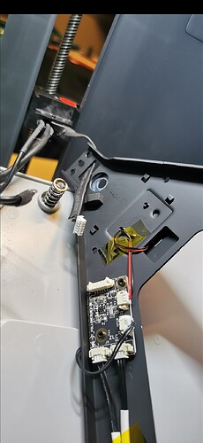

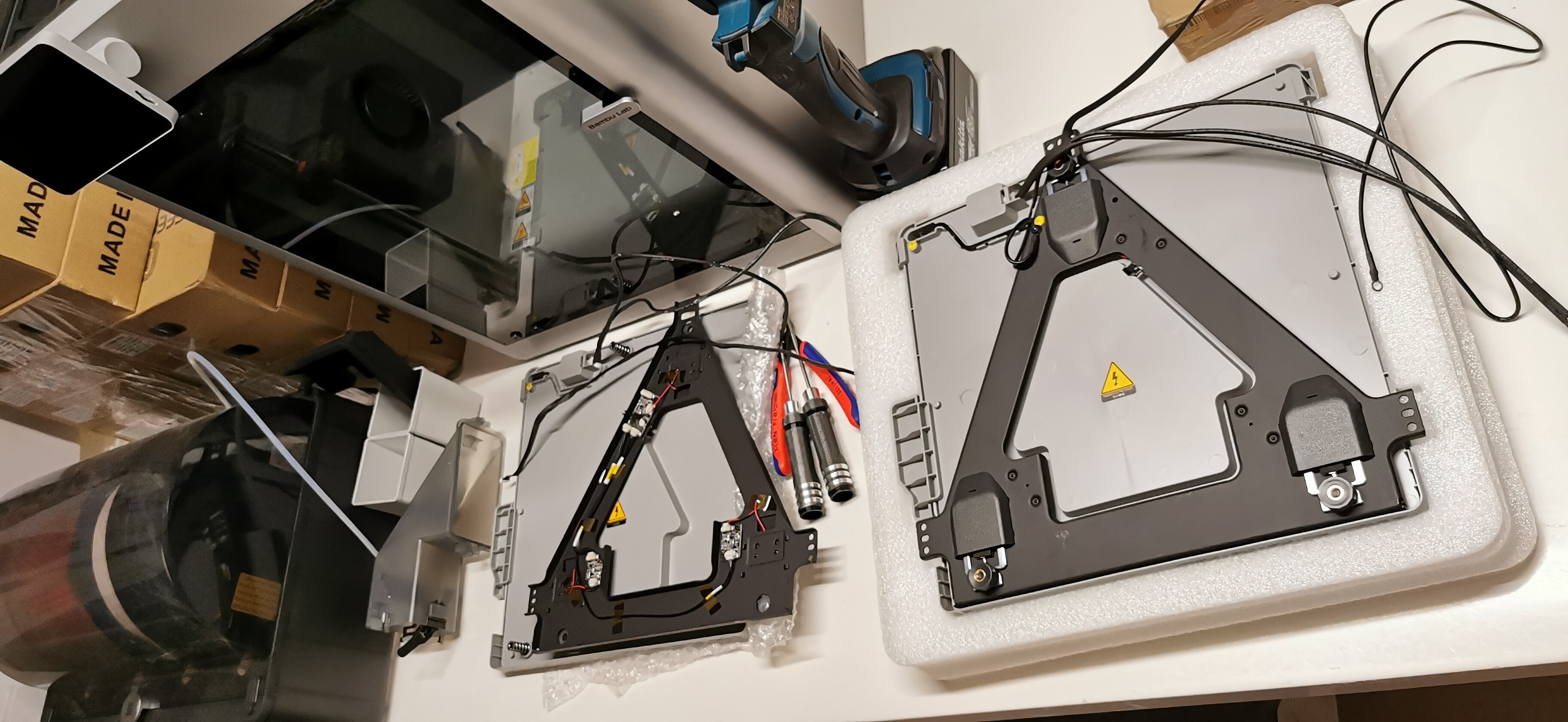

I received a reply on my ticket for this and they want to send me a new heatbed signal cable because from the logs they think it is broken. A bit annoying to have to try to swap it on such a new printer. Looking at the wiki it also looks like a quite complicated swap as I need to remove the whole heatbed.

Jetzt habe ich mal das Bett abgeschraubt, aber die Kabel bekomme ich leider nicht ab.

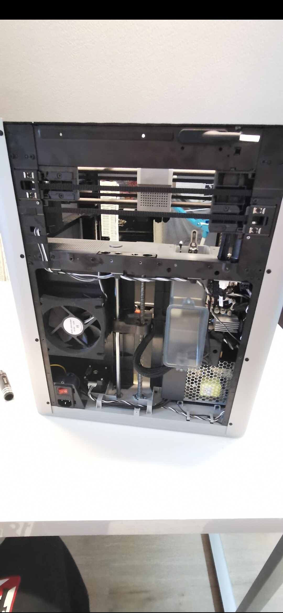

Ich habe heute den ganzen Tag den Drucker zerlegt, alle Kabel und alle Stecker überprüft. Danach mit dem Bambu g-code das Bett neu nivellieren wollen, was nicht funktioniert hat, den es kamen sofort wieder alle 3 Fehler mit Sensor.

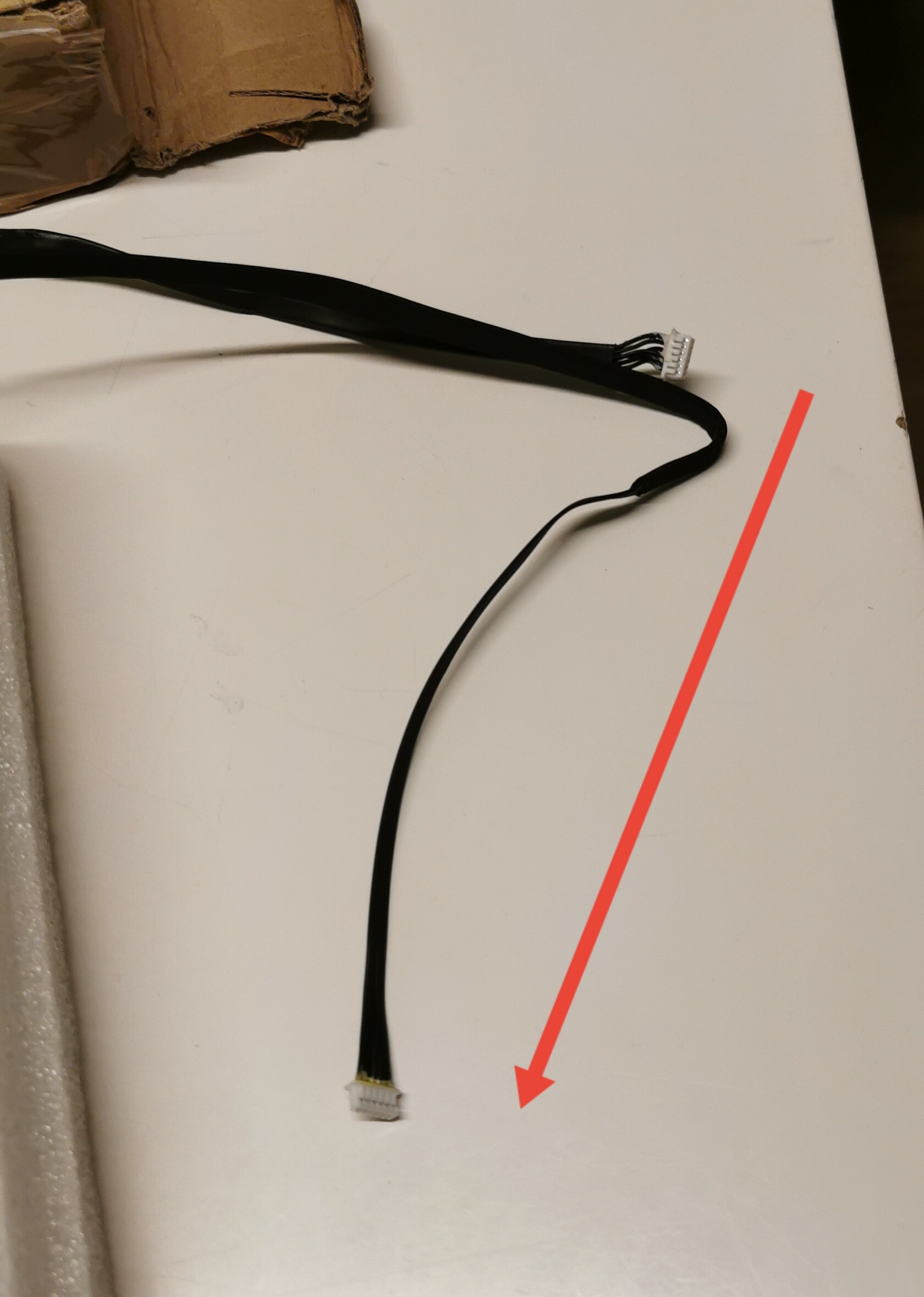

Bambu schickt mir nun ein neues Sensor Kabel.

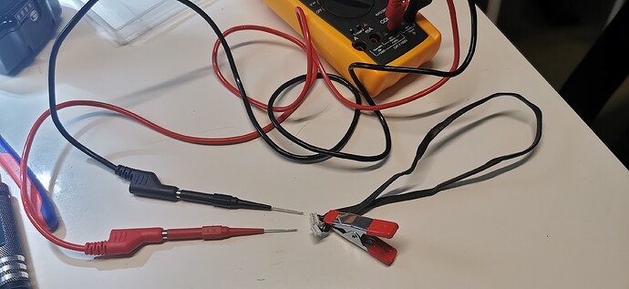

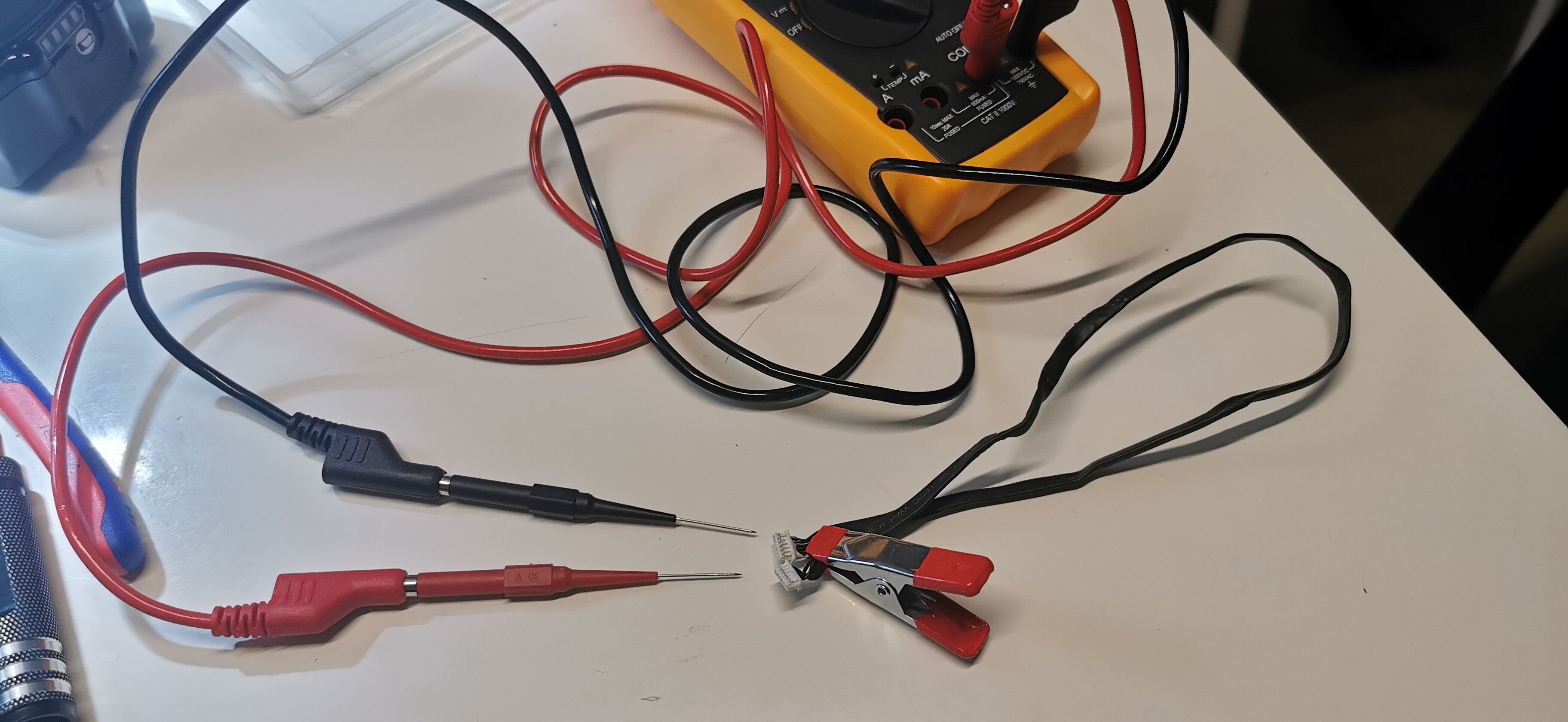

Das alte habe ich komplett ausgebaut und gemessen.
Es ist NICHT defekt.
Was soll ich dann mit einem neuen Kabel?

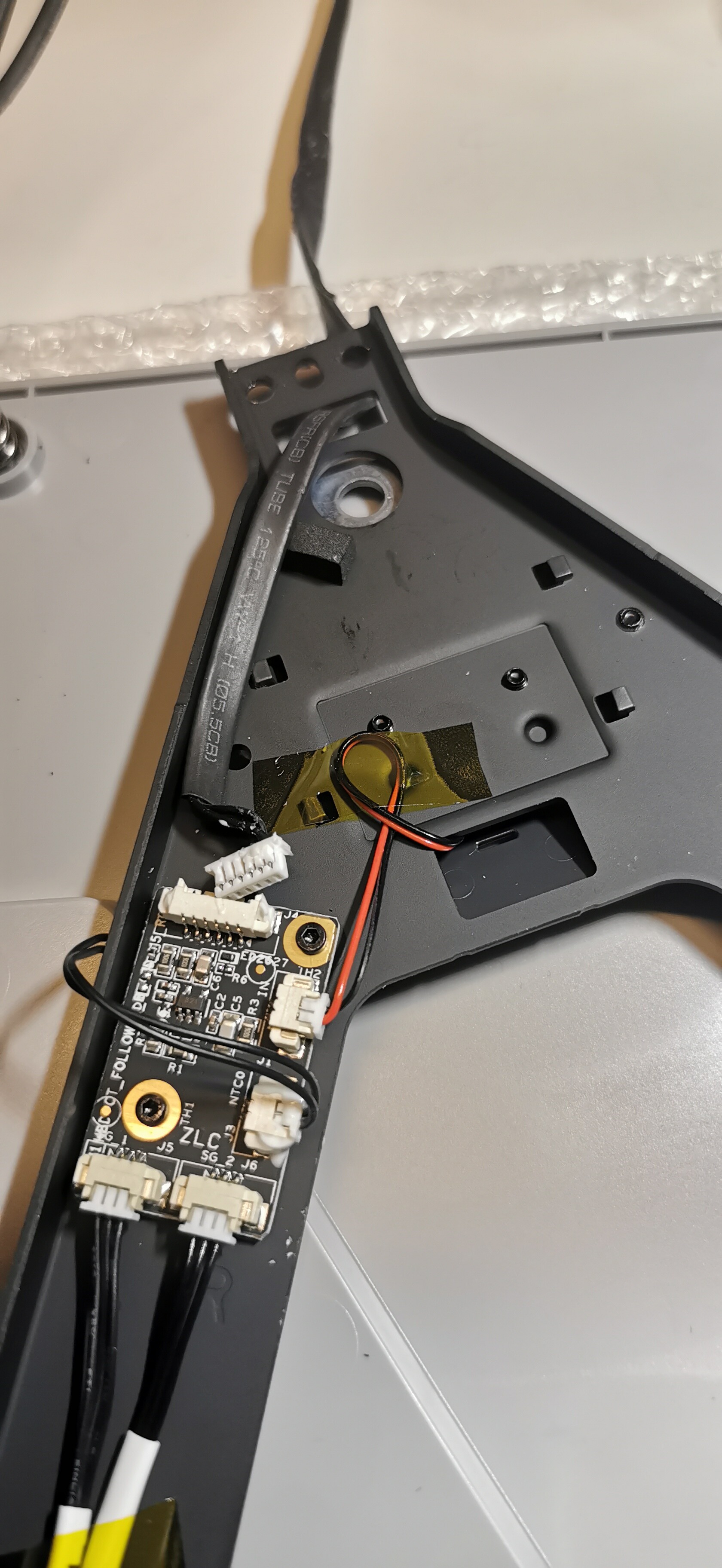

They responded within a few days (it was the weekend) and after checking the logs decided that it was my headbed cable and shipped me a new heatbed which arrived a week ago. I just need to take the time to install it :). So no idea if it fixes the error but I’ve read at least one person where it helped.

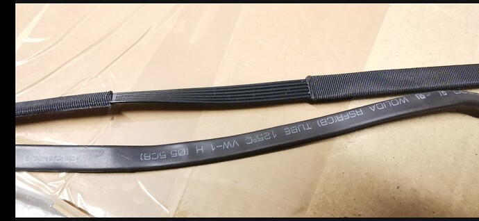

Bambu hat mir nun ein komplett neues Heizbett geschickt und nun läuft er wieder.
Am neuen Bett ist jetzt auch ein längeres Sensorkabel verbaut, das nicht mehr von einem Schrumpfschlauch ummantelt ist.

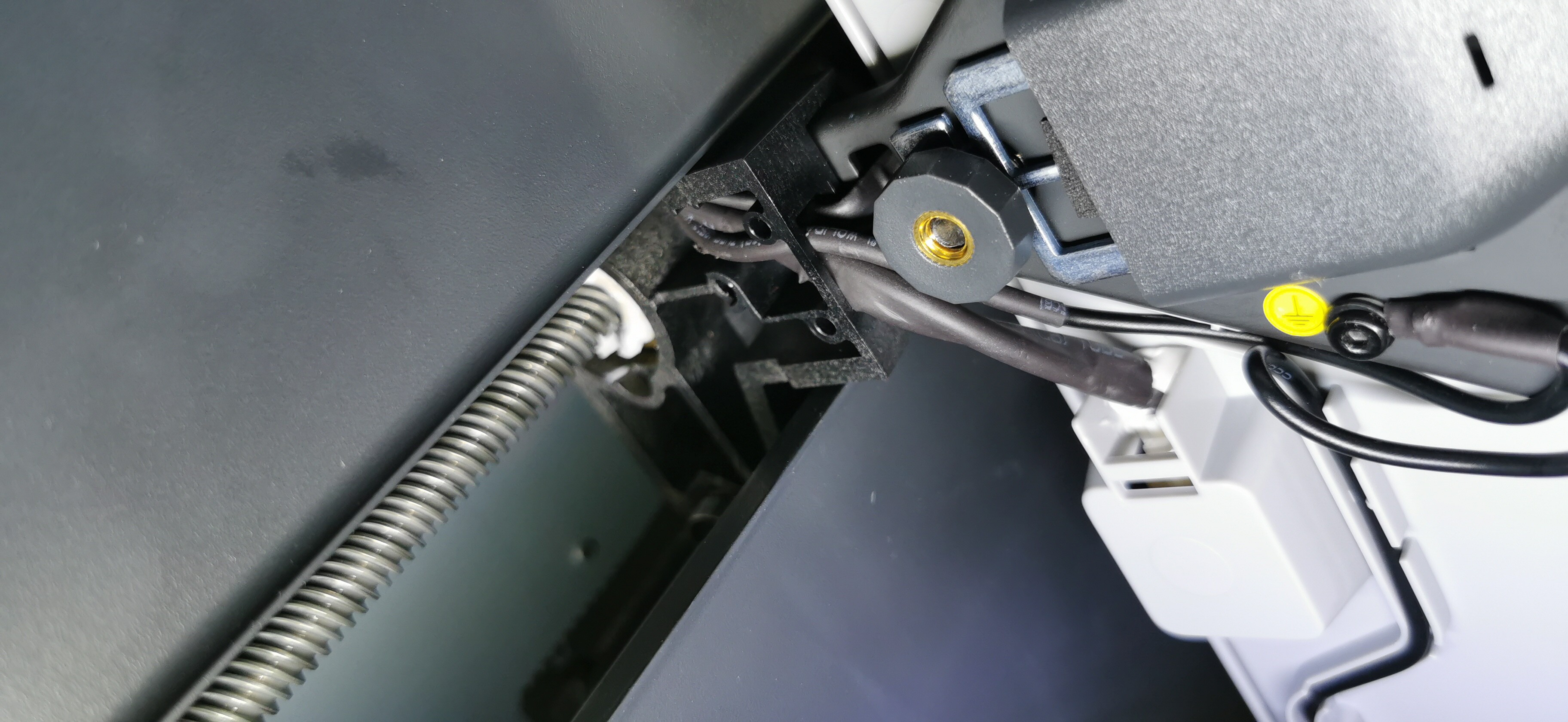

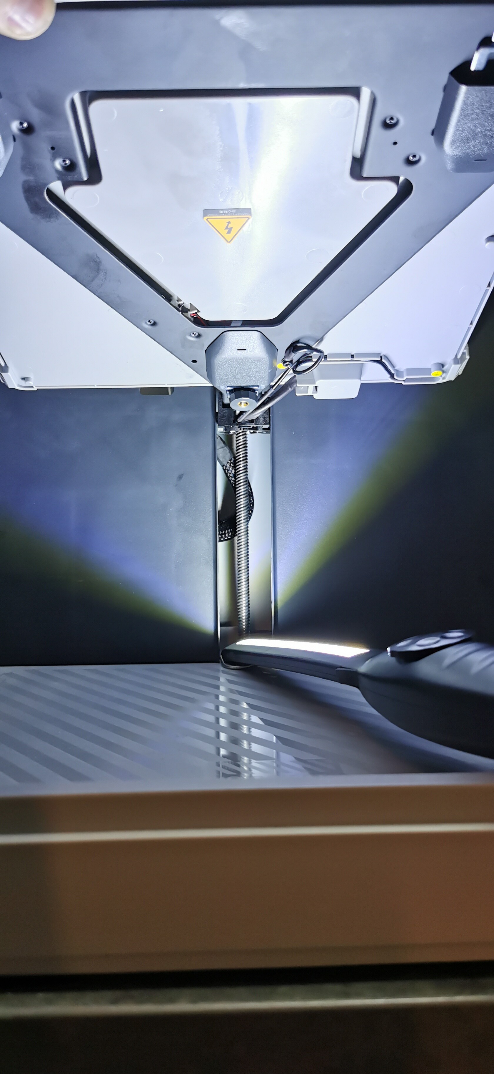

In case anyone else comes across this, They determined it was a heatbed cable issue for me, but rather than the whole bed assembly I only received a new cable. There is new cable routing documented and a longer cable which should hopefully help prevent this issue in the future. Whole process took 12 days for me as they had me tear down the bed and try to reseat the cable first. After testing my old cable further the failure point appears to be the 90 degree angle where the cables pass through the z screw mount.
