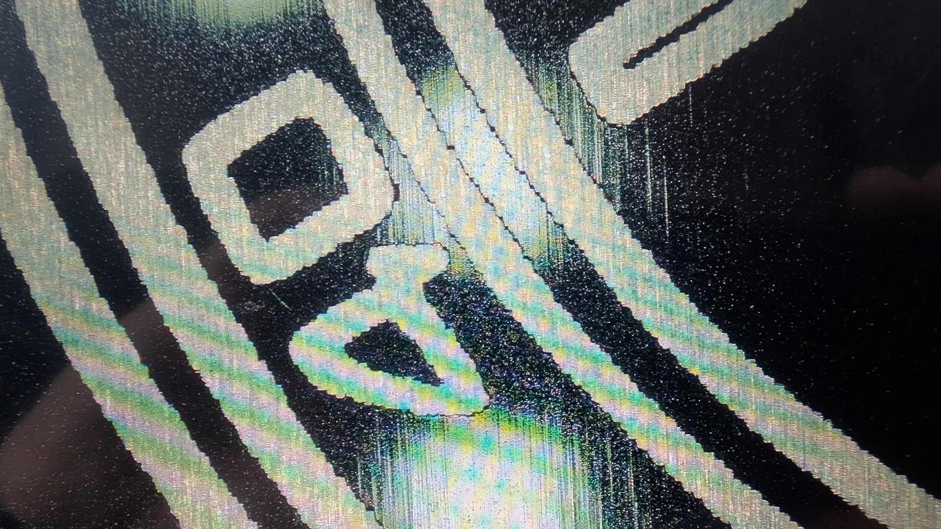

Comparison on white card stock, business card using 10W only and a series of microscope images of each type of laser and the dual pass.
The 2 pass 10W despite having the 2nd pass does have cleaner lines compared to the 40W, it’s set to 90% power output by default and I could tweak the power output or speed to achieve the same result as 2 passes.
Business card was all stock settings only using the 10W laser, zoomed in shot is from a digital microscope. When scrolling through the larger images it is in the following sequence: 40W, 10W single pass and 10W dual pass.

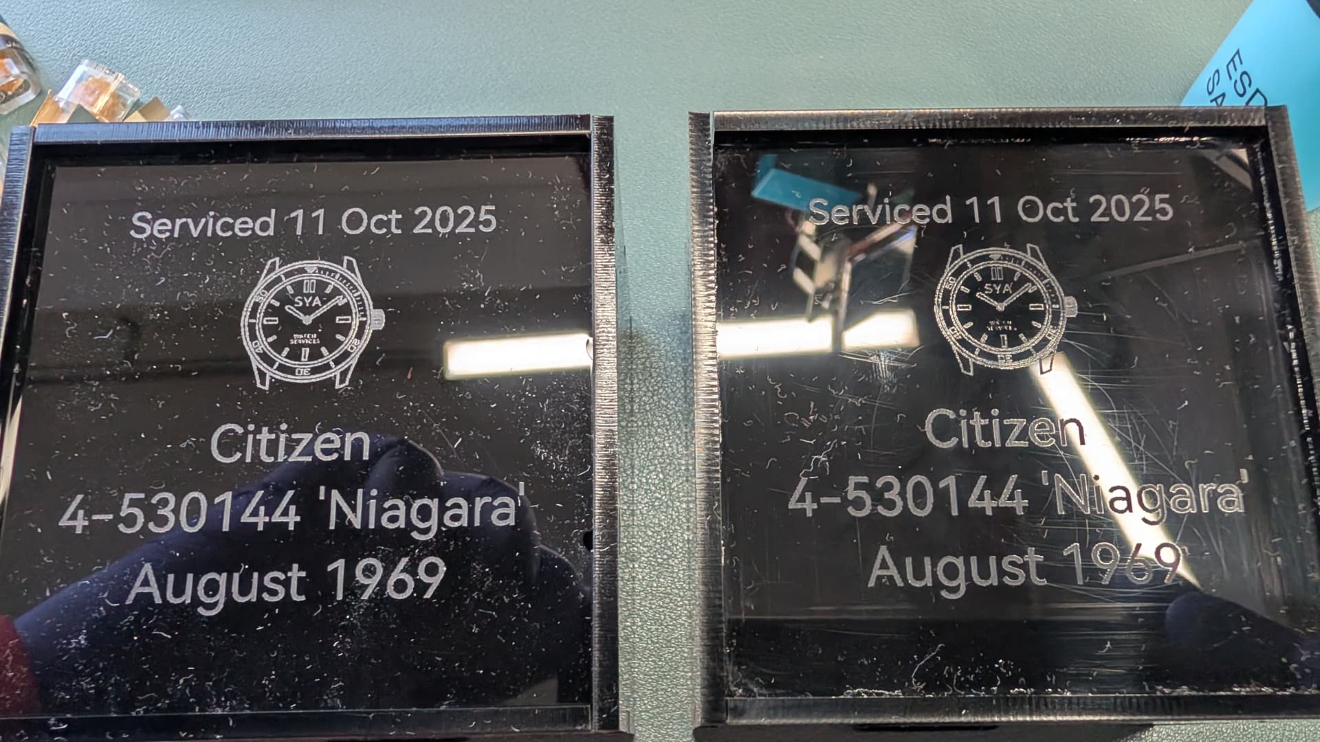

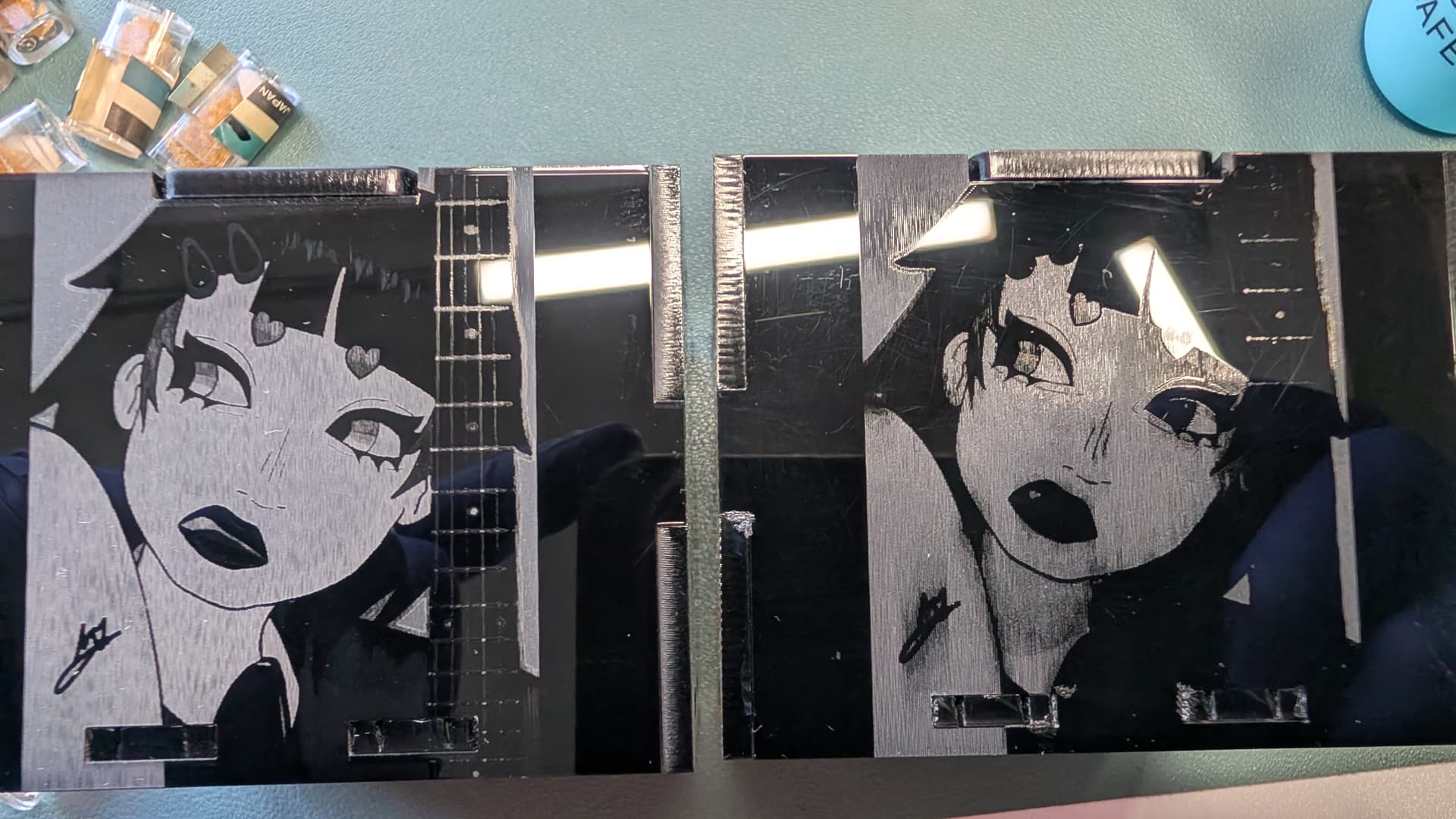

Update as I used some black acrylic and the difference between the 2 is very noticeable. The 40w has crushed a lot of detail on both etched images, the hair grips are gone and the guitar neck has lost a lot of detail, zoomed in shots are from a microscope.
Same with the image and text on the bottom of the box, some of the detail is crushed.
Used the 10W for the whole job, it’s not done as good a job at cutting as the 40W, couple of distortions in the plastic where its got hot on the edges during cutting which were not there on the 40W.
I guess the issue with lasering images onto wood is there will be a bit of burn which makes the image larger - so the difference is less noticable.
On metals and acrylic you can really see where the 10w is a much more suitable tool.

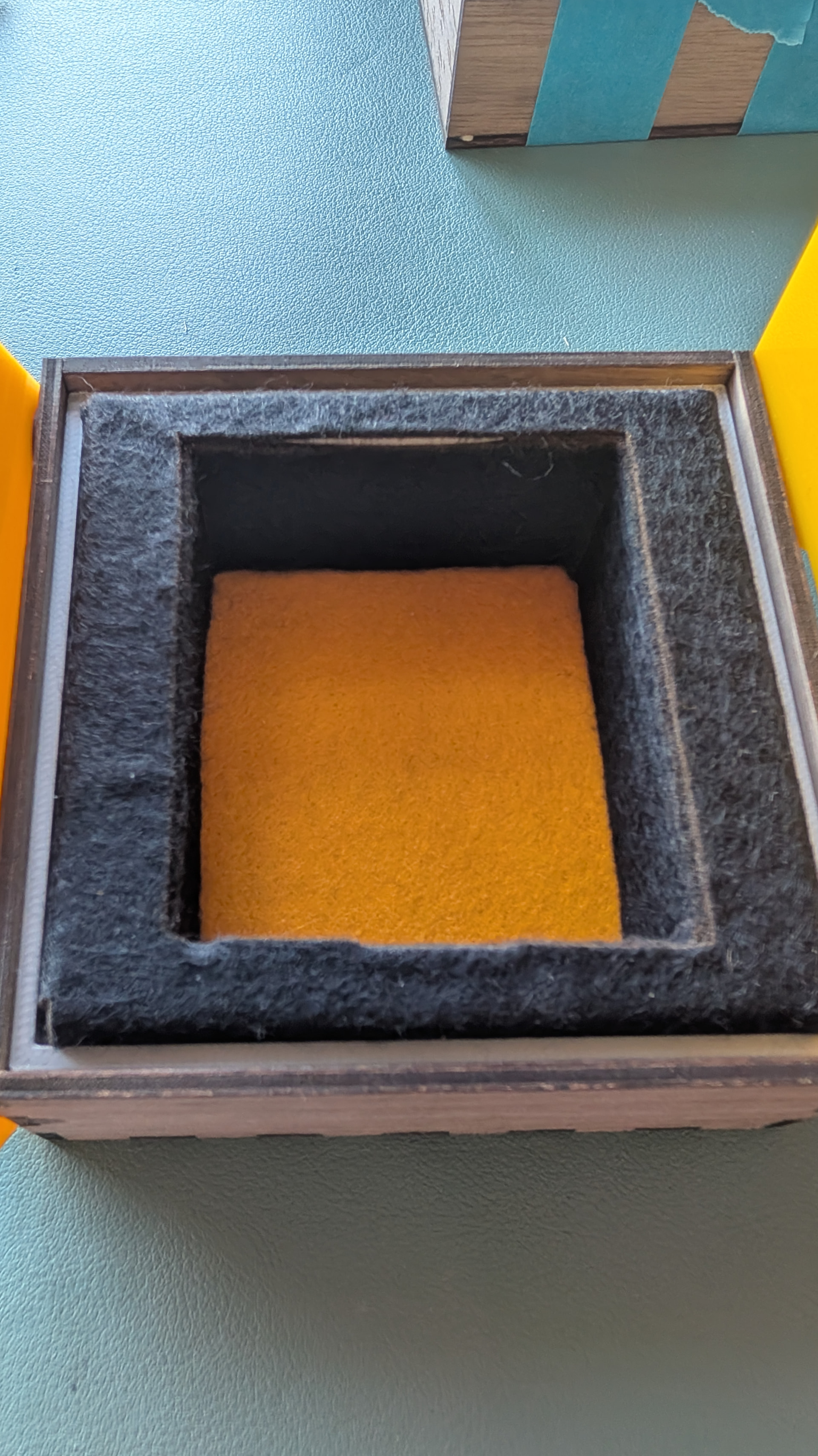

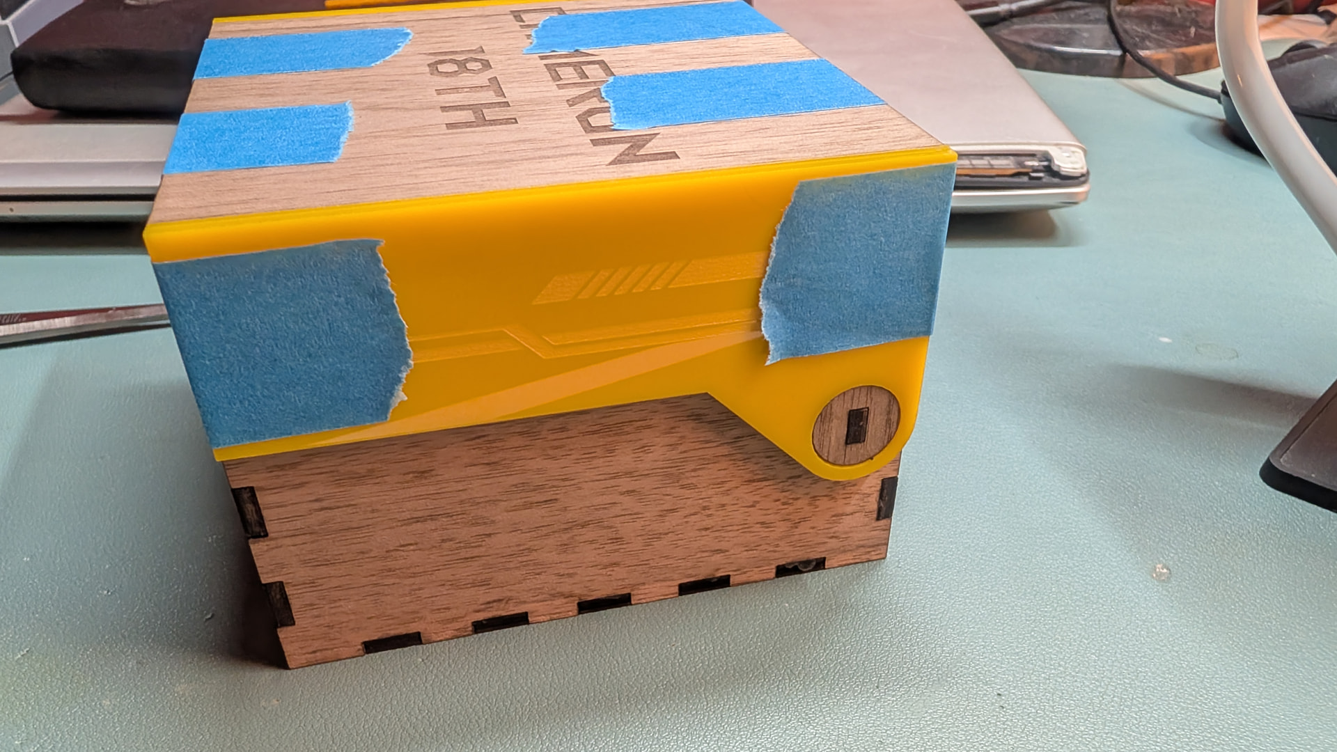

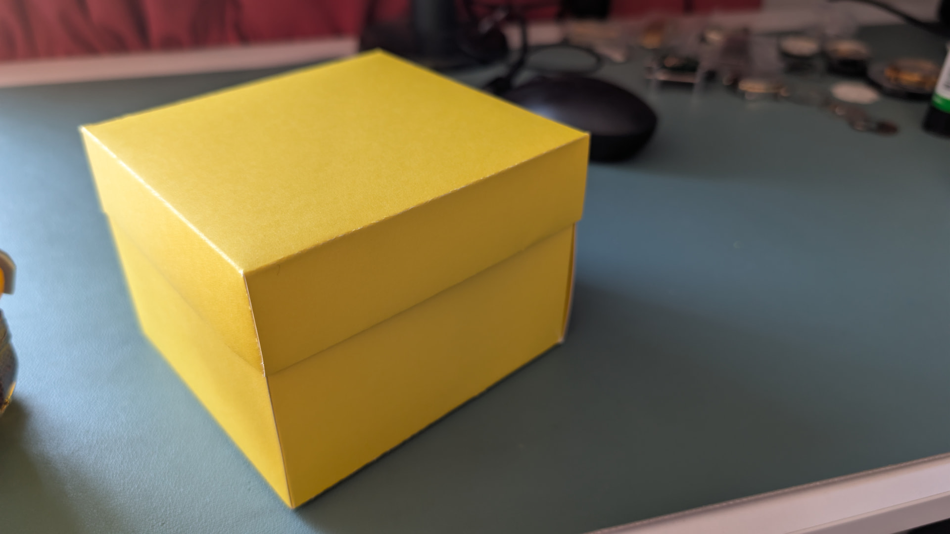

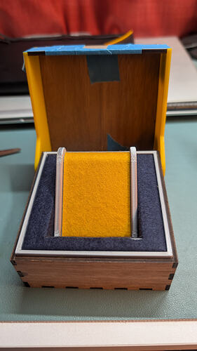

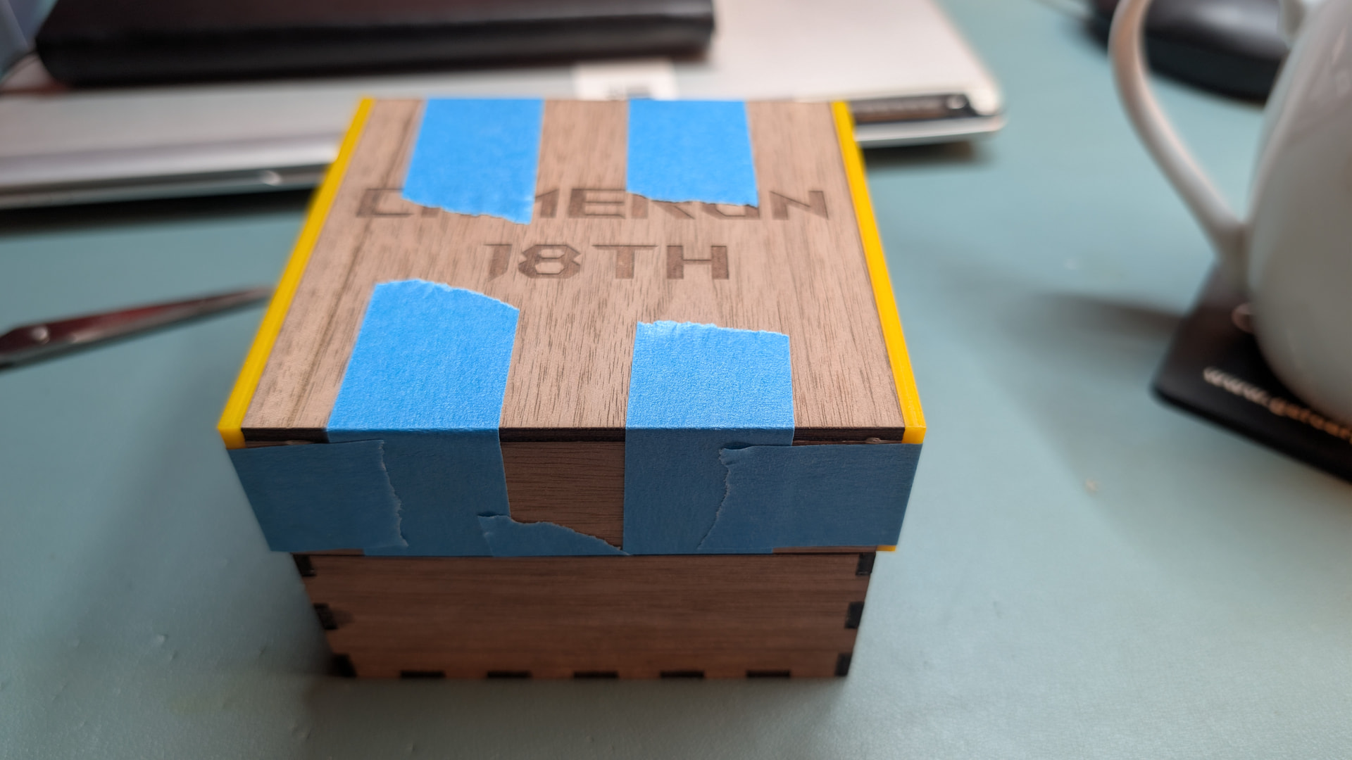

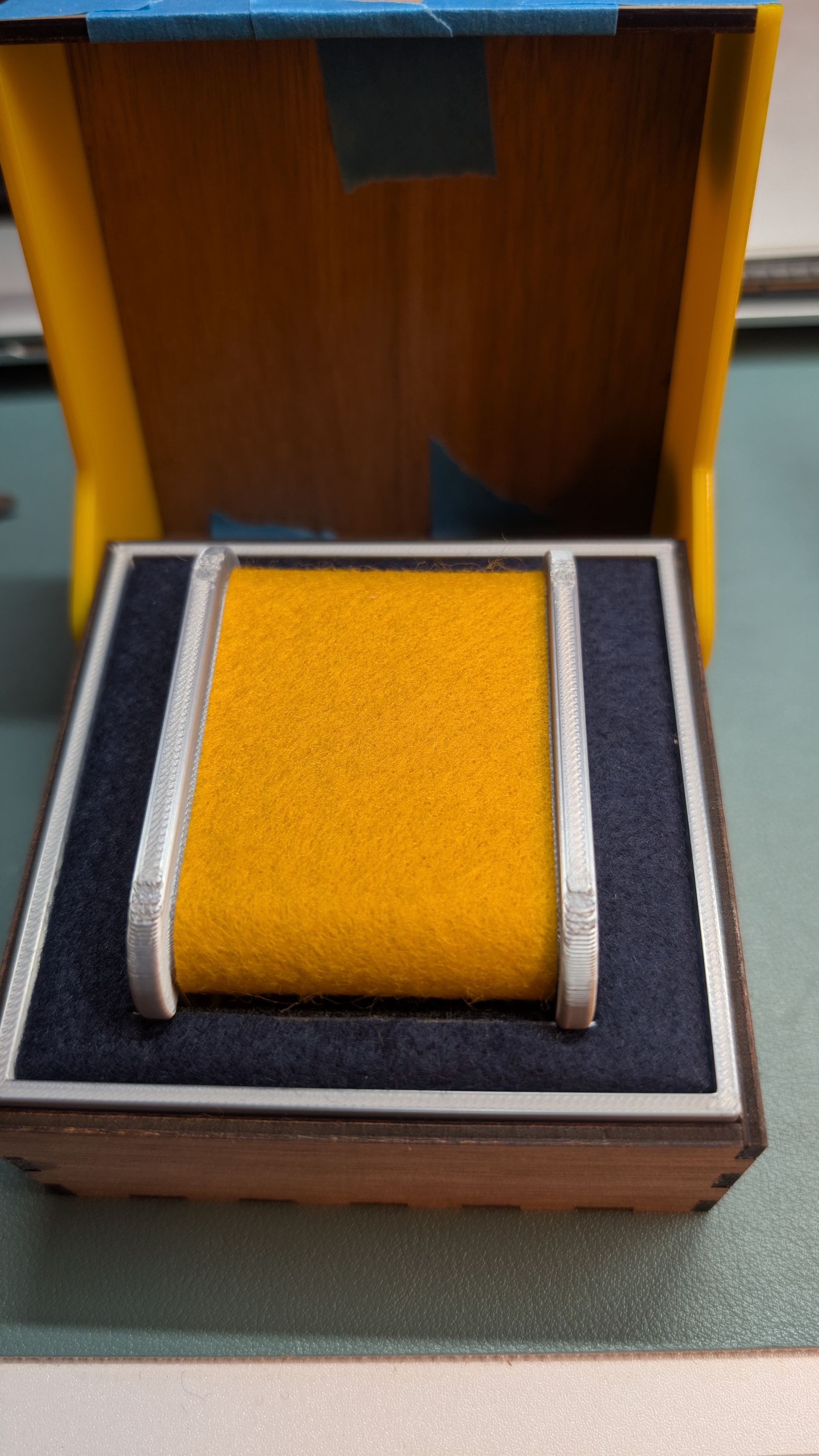

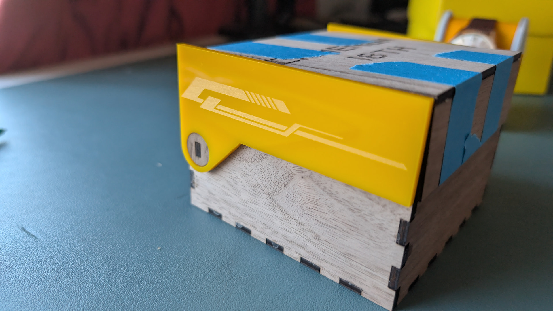

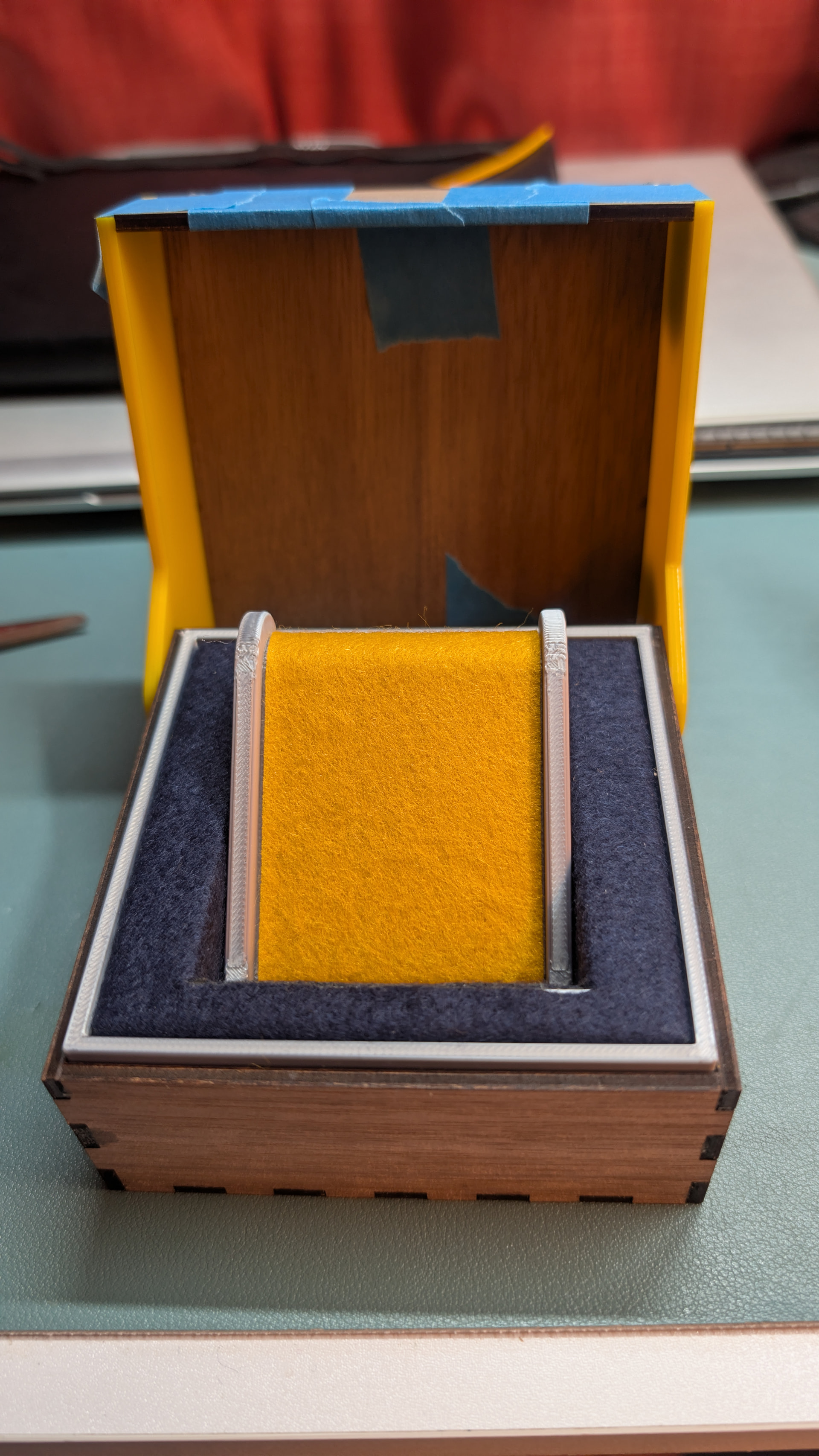

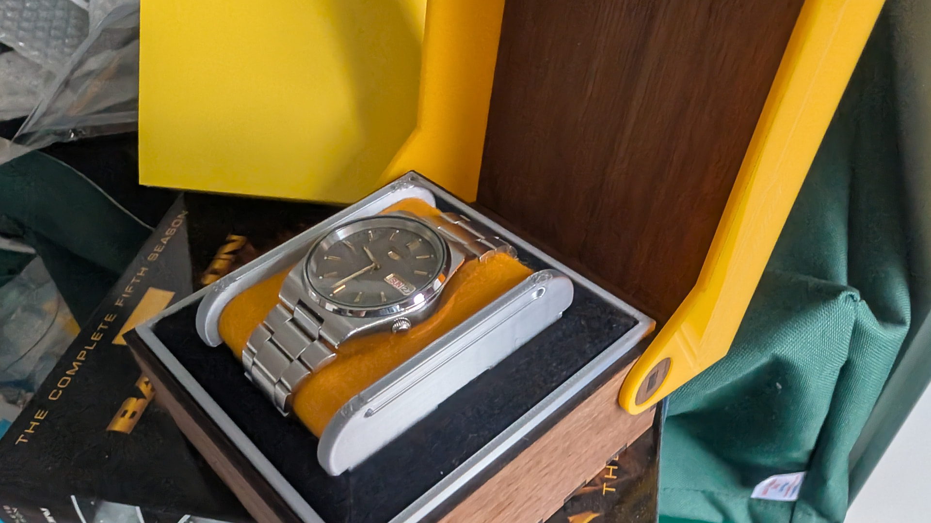

Custom watch box with inserts using multiple materials, the insert is a 3 part 3D print, cloth covering is laser cut and the box is from a parametric model online scaled to suit.
Also use the drag cutter to make an outer cardboard box for all of it.
Photos of the evolution of the design and adjustments to get it all to fit.
Need to improve my process when applying glue to the box but its doing what I want it to on the whole.
Biggest pain was the cloth that covers the insert (not the watch/strap puck) as trying to prevent obvious cutting/gaps - ended up with 4 separate pieces which makes it a bit fiddly when assembling but the overall look is much cleaner.
