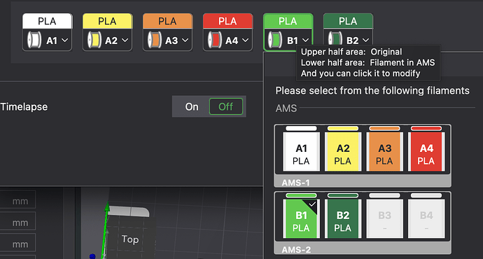

I have a P1S Bambu and had hooked up a second AMS that had been working perfectly fine for months, even got it up to 16 colors. Recently I haven’t been able to get it to print even 5 colors. It’s a work printer and I believe it may have been unhooked for maintenance and after that it stopped working. I’ve unhooked every cable and switched them around in any way I could. I tried messing with the settings on the Bambu Studio and testing colors but the printer always skipped any and all colors from the second AMS. I’m wondering if the AMS Hub itself it not working anymore, has anyone else had this problem? Any tips will help ! Thank you!

It seems to be recognizing the other 2 filaments (B1 B2) and the lights turn on. It’s able to print an object only using B1 (we tested it to make sure it worked and it can take filament from it) but if i make it 5+ colors, it prints everything else but the colors from the 2nd ams, like it just skips the colors and leaves gaps where the color should be in the prints. No error messages or lights or anything like that
What firmware is the printer and both AMS’ on? Are you sure you’re not getting any errors?

In the meantime, can it print only from B2? And does it pull in B3 and B4 when spools are (re-)inserted? Does it read B3 and B4 itself or can you at least specify the material in B3 and B4 using the printer menu? If yes, it may the RFID antennas playing up.

They are all on the latest version of firmware. No errors, it would show
" filament loading…" when it was supposed to be printing from the second AMS but then it would cut the print short and say finished
