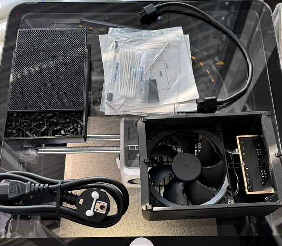

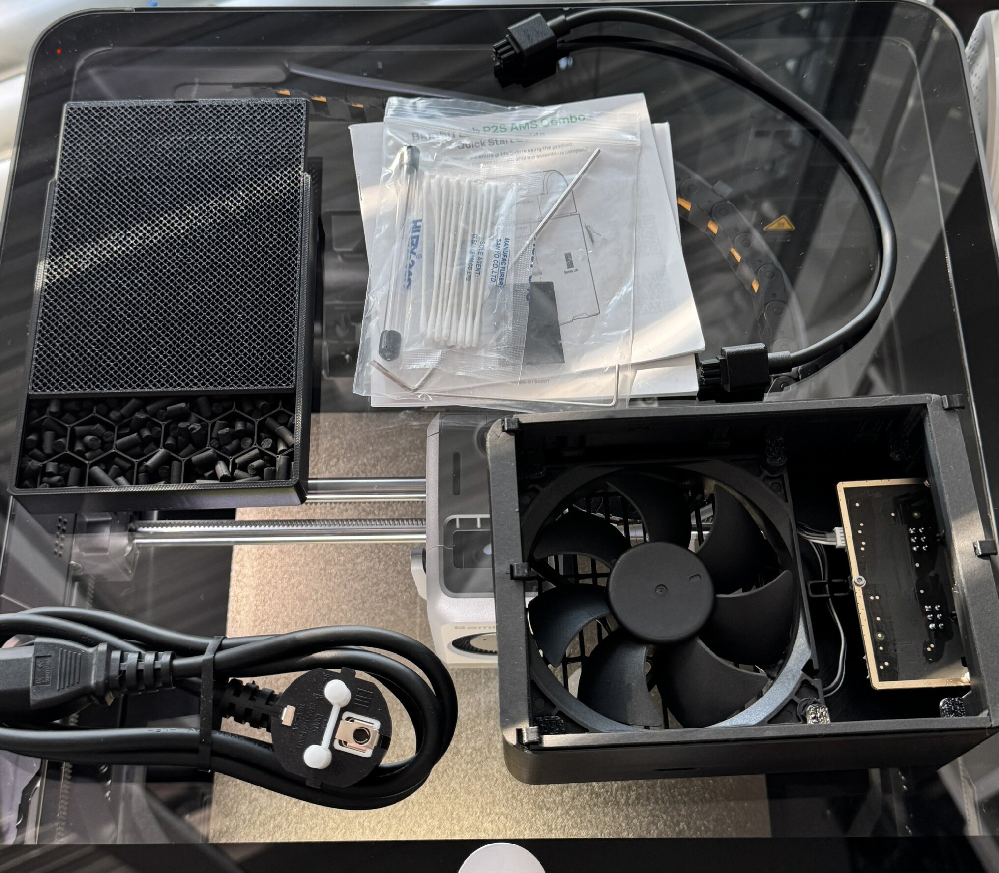

X2D with second external Fan (left over from P2S) and getting constant certification error…
Updated the firmware on both of the external fans by connecting only one of them (everything is fine then)

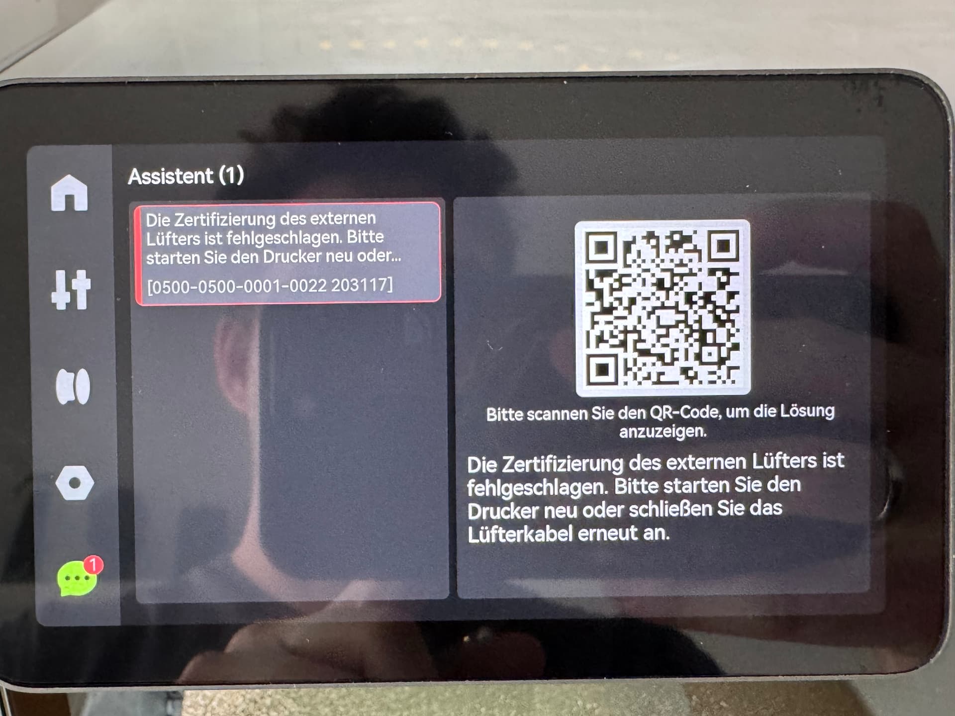

As soon as you connect a second external fan, no matter the 6pin ports i use, i soon get an error (shown in the picture)

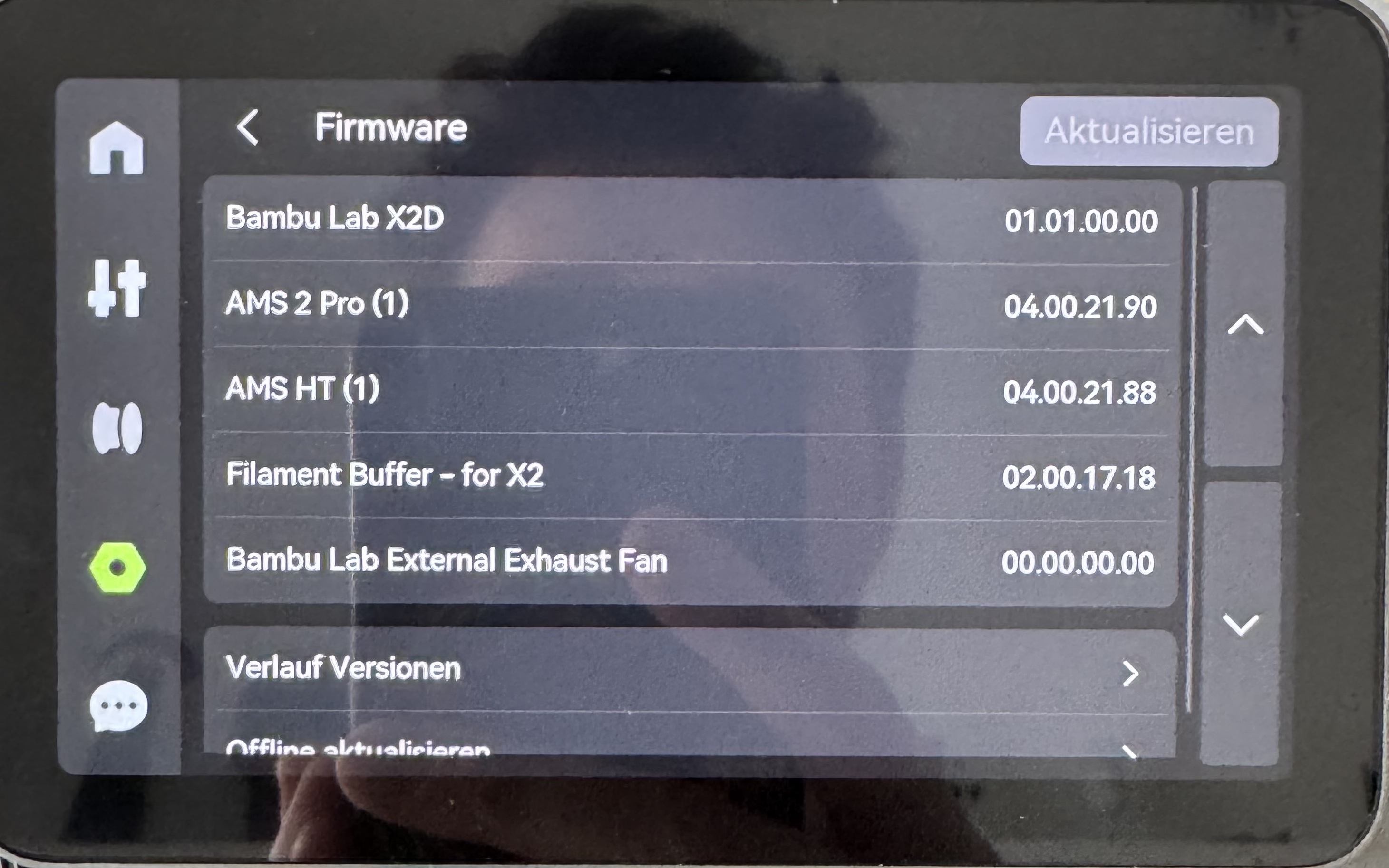

In the menu he is showing the firmware/serialnumber with the right numbers, the next second he only shows 00.00.00 for the version/SN and switching back and forth. Looks like it he cant handle 2 external fans at this moment/firmware version.
Would love to be able to use my second external fan with my new X2D, mounted it on the optional mounting point.

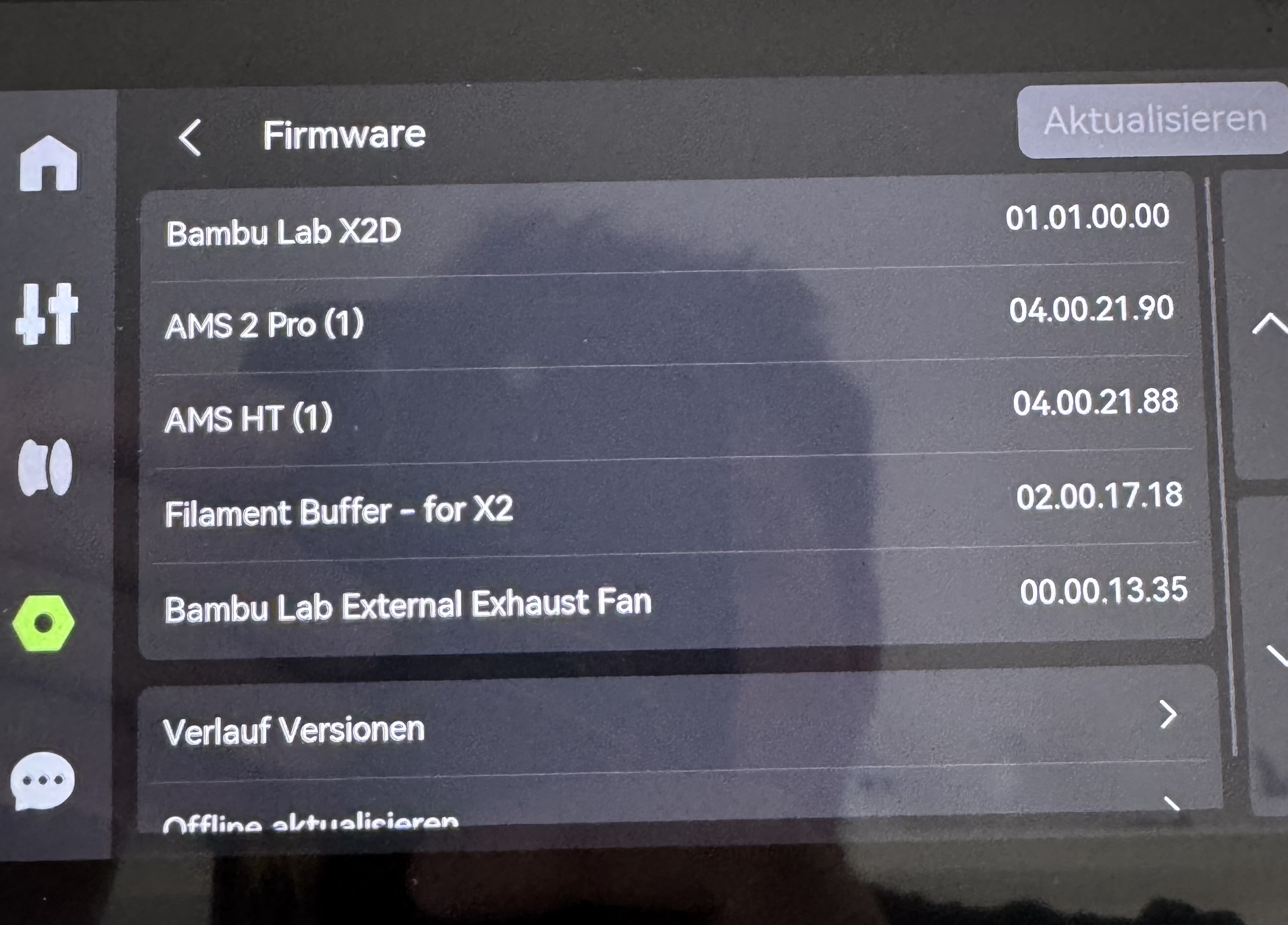

Here is what the X2D shows if one FAN is connected
Here is what the X2D shows if two FANs are connected
It sees fan/s but dosent show or can read the firmware (neither the serialnumber → nor the certificate) of both of the fans and i guess therefore very soon showing “0500-0500-0001-0022 203117”.

Only 1 month ago i bought the P2S and for that printer i bought and made the external fan, printed it with PETG in good quality, even printed the filter and bought actived filter material… X2D came, sold the P2S without the AMS 2 Pro and the Fan/Filter.
Now running X2D with 1x AMS 2 Pro for primary nozzle and for second nozzle running a AMS HT. No matter how i connect the second fan, even without any AMS, jus fans, order of the 6 pins, nothing changes the outcome, soon the error appears as soons as second fan is added in the system.
By using both fans i could turn down the exhaust fans RPM / noise, without losing cooling performance, please look into this :smiley:
