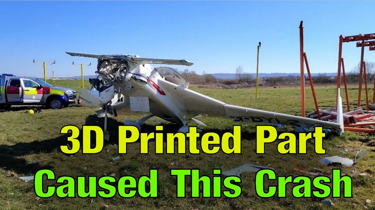

I was checking out something unrelated and stumbled across this video. It’s a discussion of a homebuilt aircraft crash that luckily wasn’t fatal but easily could have been.

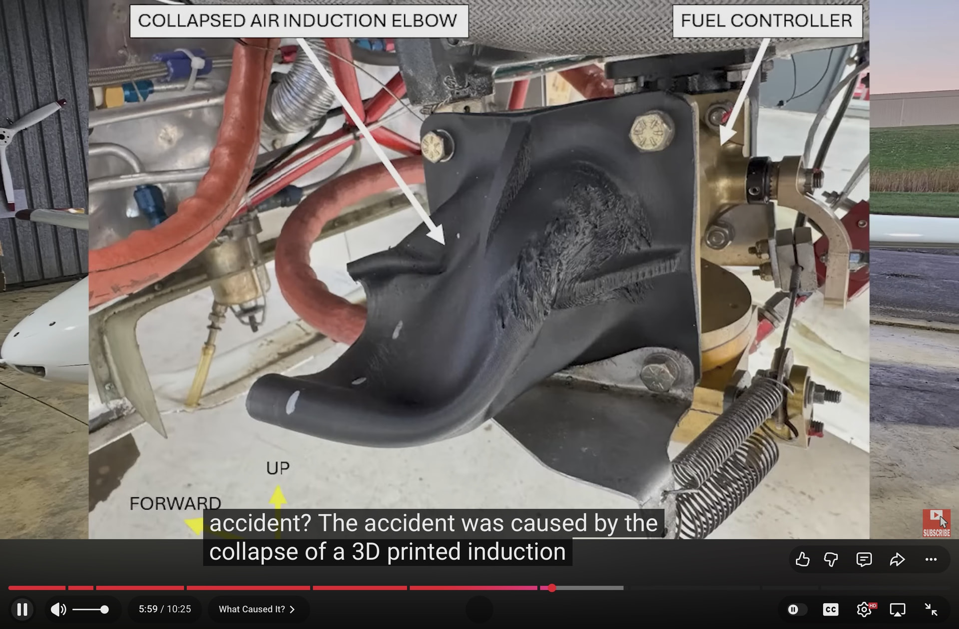

Somebody was going to fly-ins and selling a 3D-printed air intake piece for certain aircraft engines claiming strength, light weight, and temperature resistance. They claimed it was carbon fiber-filled ABS.
It turns out it wasn’t ABS at all. It was PLA and during a flight the engine compartment got warm enough that the PLA softened and collapsed from the pressure differential across it. With no air the engine quit and the pilot was only able to glide to the airport but crashed into runway approach lighting.
I doubt the person selling the parts is here, but for (name your diety’s) sake, you don’t 3D print important aircraft parts - especially engine parts - out of the wrong plastic and even then, make sure plastic is even appropriate. Go substituting 3D prints for critical parts and you can endanger your own life or others.
The swapping of PLA for ABS should have been obvious to anyone skilled with ABS and PLA so I can only assume the swapping was intentional and the person selling the parts thought it could make printing easier and “mo money, mo money, mo money”. It’s for an induction part so not really hot right? They failed on about every aspect of making something safe for sale and nearly killed someone.
There’s likely a number of aircraft out there with this same time bomb ticking away. The person who decided PLA = ABS could still kill people with this. It wasn’t even a good print. There’s support defects big time visible in the photo. Likely just some inexperienced clown with a 3D printer that thought he could pay for his trips to fly-ins. Bad print out of the wrong material sold for aircraft use. What could go wrong?
Here’s the after crash photo of the collapsed intake part and a link to a video about the crash. Video is from last December. That flattened area is supposed to be a tube.
