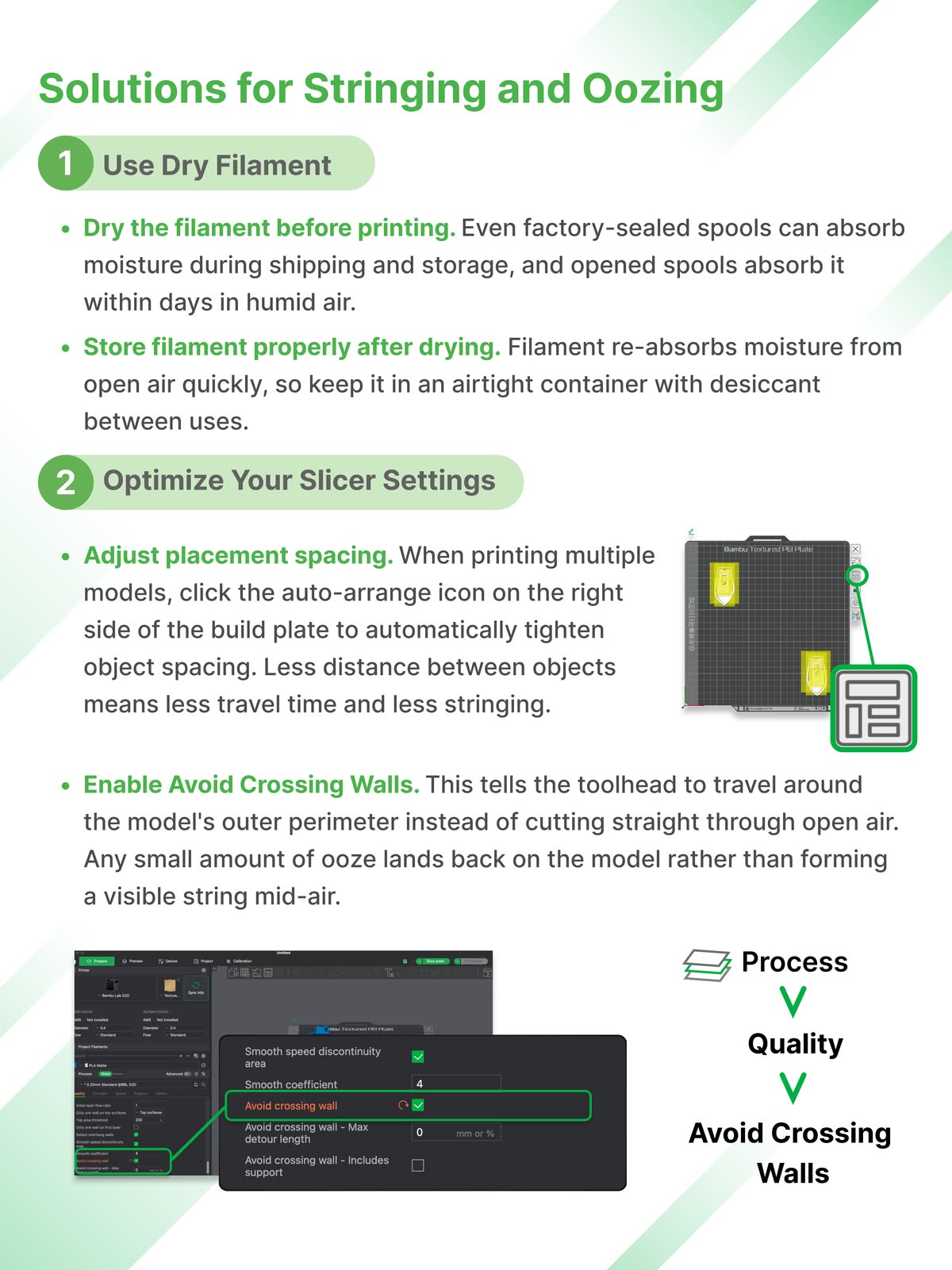

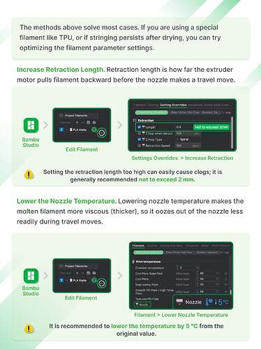

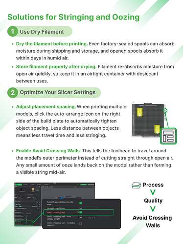

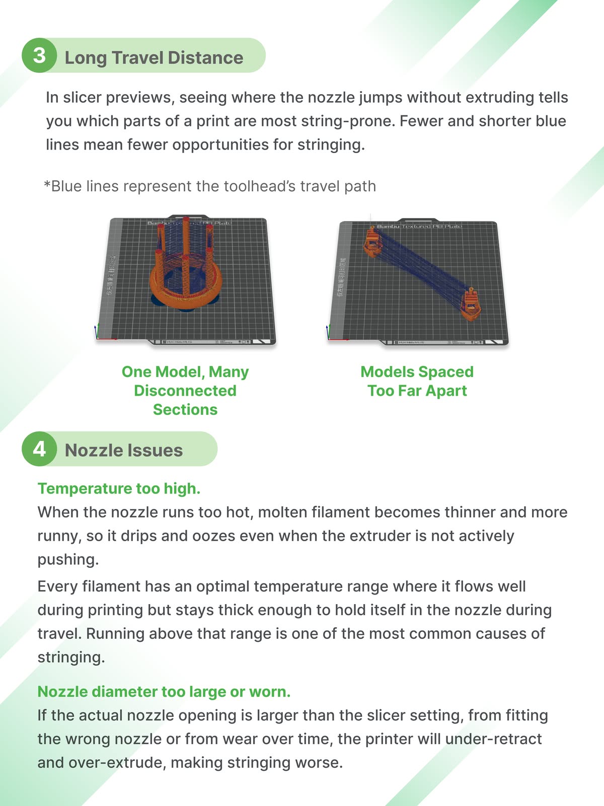

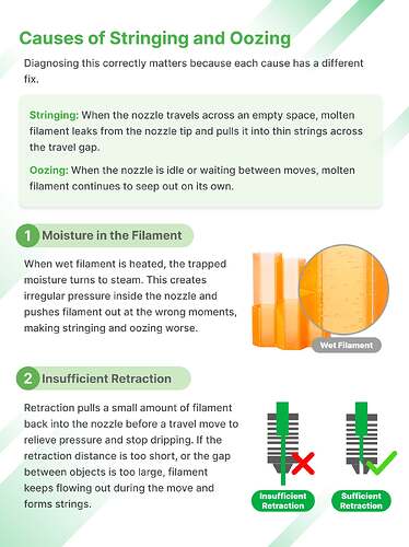

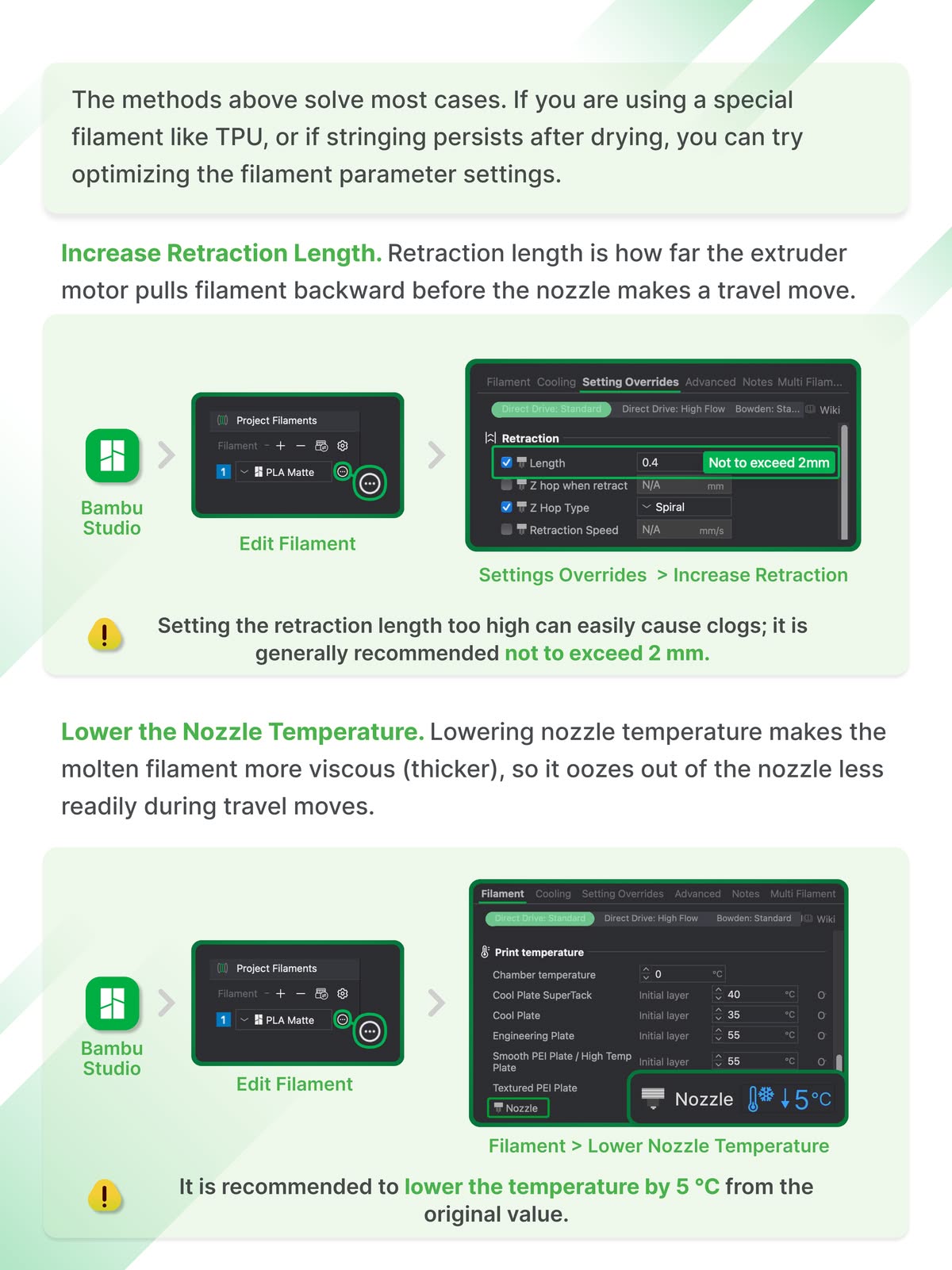

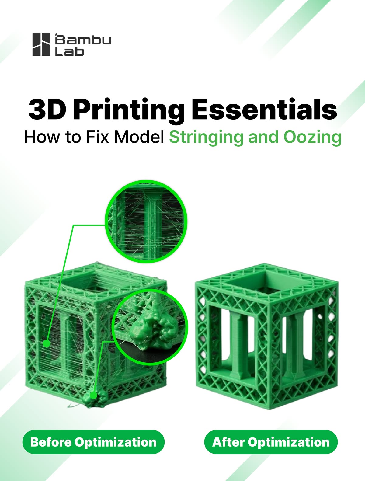

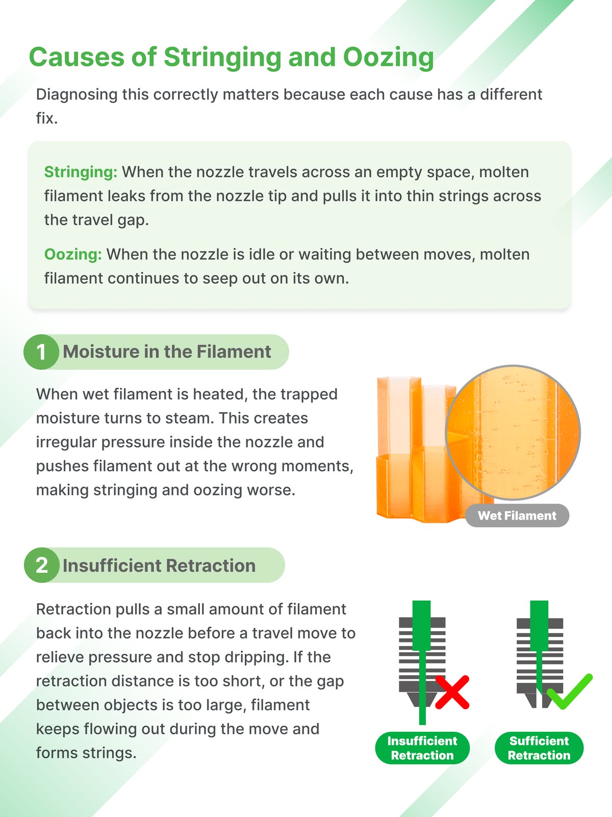

3D Printing Essentials: How to Fix Model Stringing and Oozing
Great guide! Should also be mentioned that HF nozzles can increase stringing and oozing due to their internal geometry being more challenging for retractions.
