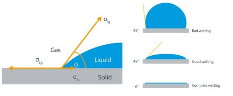

3- Flexibility decrease the effectiveness of coating. There are lots of debate about the safety of coatings but let’s leave that to another day. The coating should be very though and rigid to protect. In that regards, there are several resins; we home users, can work with. But flexy nature of the object just breaks these coatings. Besides PETG is one of those materials that does not want to fuse with other chemicals. So the efficiency of coating will always be questionable.
