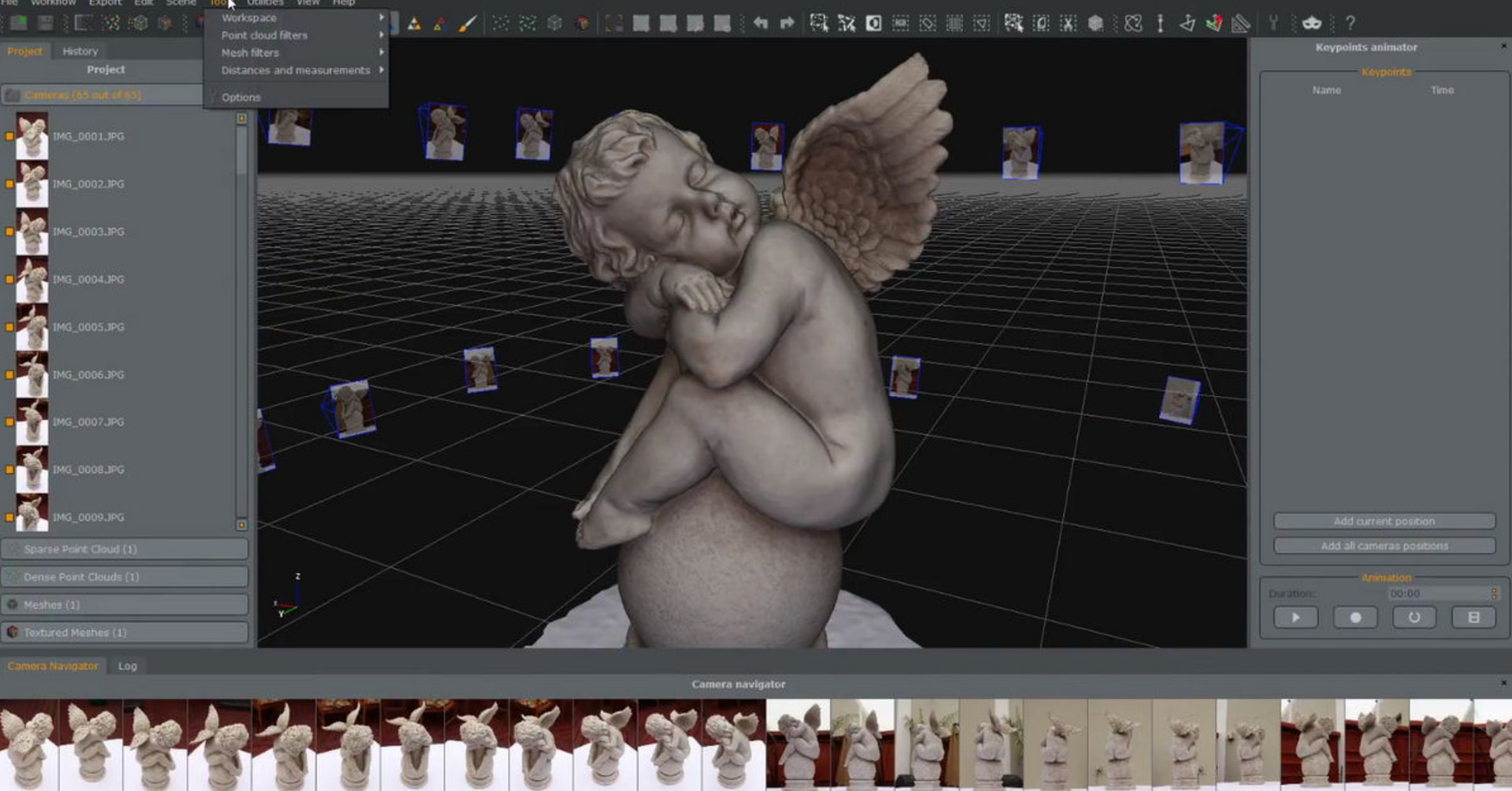

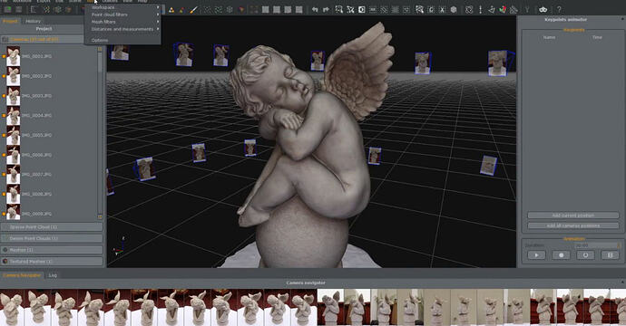

If you’re interested in exploring 3D scanning, I highly recommend this free programme: 3DF Zephyr Free. Although it was developed for architecture, it also works well with everyday objects.
You can start by using it with a standard mobile phone. This will give you a good understanding of the workflow, including what a point cloud is, how to convert it to STL and how to fix the measurement errors in Blender that will occur.
Basically, how to convert a point cloud into an STL file, fix any errors, and make it printer-friendly.
