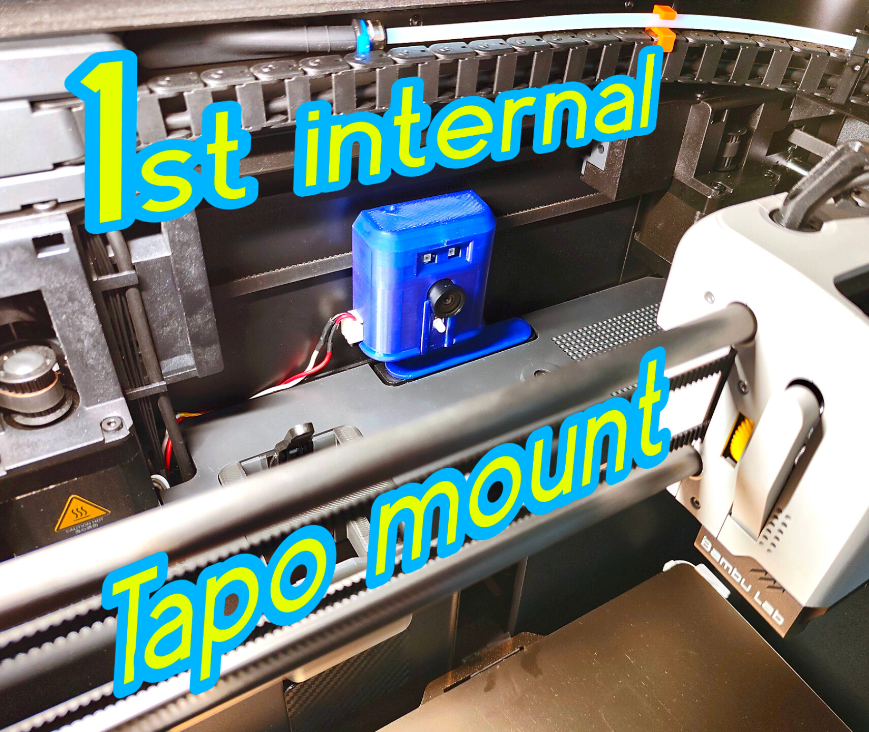

I made good experience with a Tapo C110 cam and the case ifrom Magnetic Camera Mount for TP-Link Tapo C110 by soerenharaldsson - MakerWorld
The camera connects into your wifi and can also be used cloudless.
I embedded its stream into my Homeassistant dashboard.

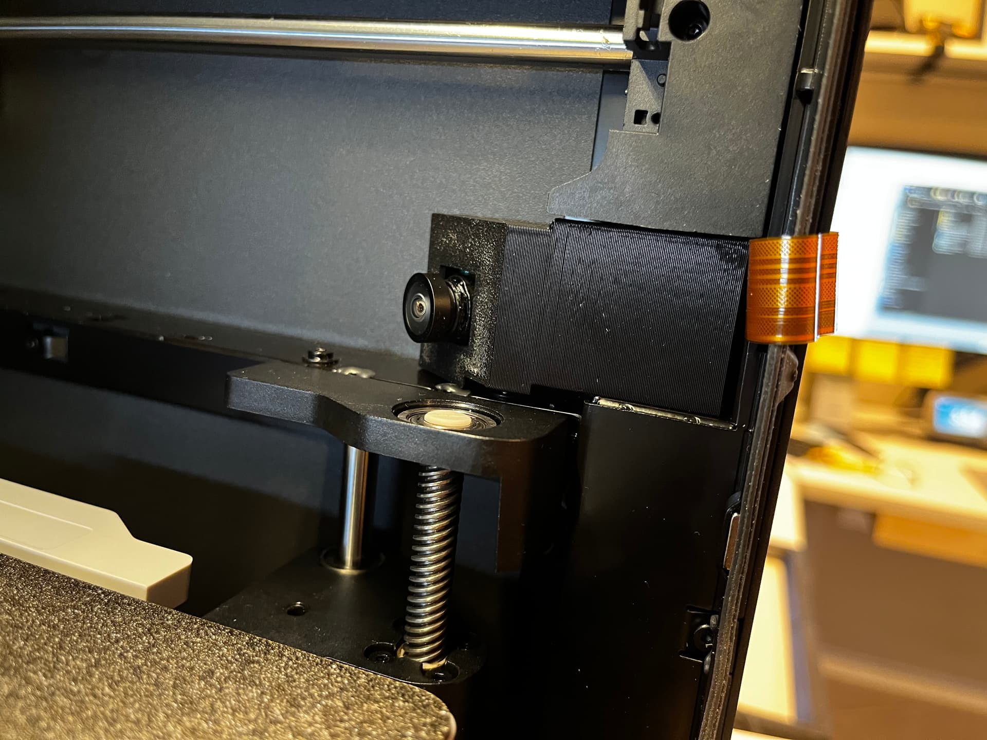

I’m using this from Arducam: Arducam 8MP IMX219 175 Degree Ultra Wide Angle for Raspberry Pi Camera Module, Compatible with Raspberry Pi 5, 4 Model B, Pi 3/3B+, and Pi Zero 2W, and running it on a Pi Zero 2W. I’m still tweaking the settings, e.g. focus, brightness, etc. but so far happy with it.
I’ve tried other Arducam cameras, but the focal length and lack of focus made them less than useful.

  1. I’ve found that fixed focus works better, especially with the camera I’m using. The focus is adjustable manually, so you can easily control the focus (which seems necessary in such a tight space.)
  2. I remixed another mount to place it in the right front corner of the P1S. Overhead lighting is necessary, which is a work in progress. I’ve printed an LED riser, found here, waiting for the LED to arrive. Printables, but am using a different LED shield for it found here: LED Blocker for BLLED Riser Remixed by cheshire - MakerWorld

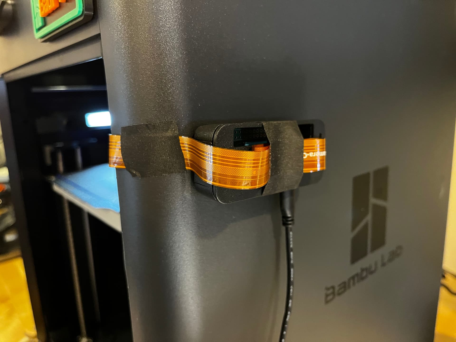

  1. Basic Raspberry Pi OS for the Pi Zero 2W - no desktop. To share the cam, I’m using MediaMTX, found here: GitHub - bluenviron/mediamtx: Ready-to-use SRT / WebRTC / RTSP / RTMP / LL-HLS media server and media proxy that allows to read, publish, proxy, record and playback video and audio streams. - I used the standalone binary method, which seems to work best and is the easiest. The Pi is temporarily mounted until I figure out a better place. I’m considering putting it inside once I figure out where to run the Pi power cabling.

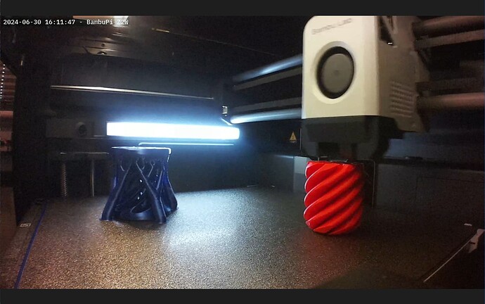

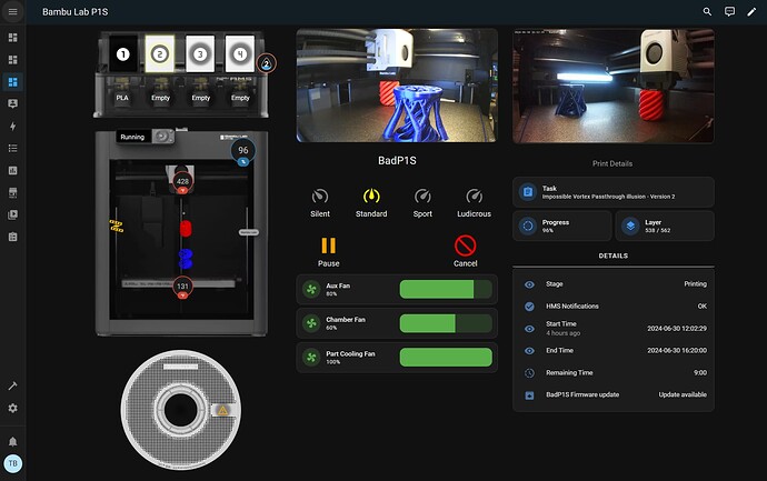

  2. To get the camera feed from MediaMTX, I’ve used a Webpage Card, simply pointing to the URL of the feed, e.g. HTTP://198.168.20.200:8889/cam
For my “Bambu P1S” dashboard, I’m using this integration: GitHub - greghesp/ha-bambulab: A Home Assistant Integration for Bambu Lab Printers - however, HA integration isn’t necessary, as you can get the feed from any browser, including your phone or tablet. But I like the overall dashboard that I get with this dashboard setup: Bambulab Home Assistant Dashboards (see below)

Raw feed in Browser
HA Dashboard
Left Camera is P1S, Right camera is my addition using a Webpage Card. The Webpage card can be placed anywhere.
