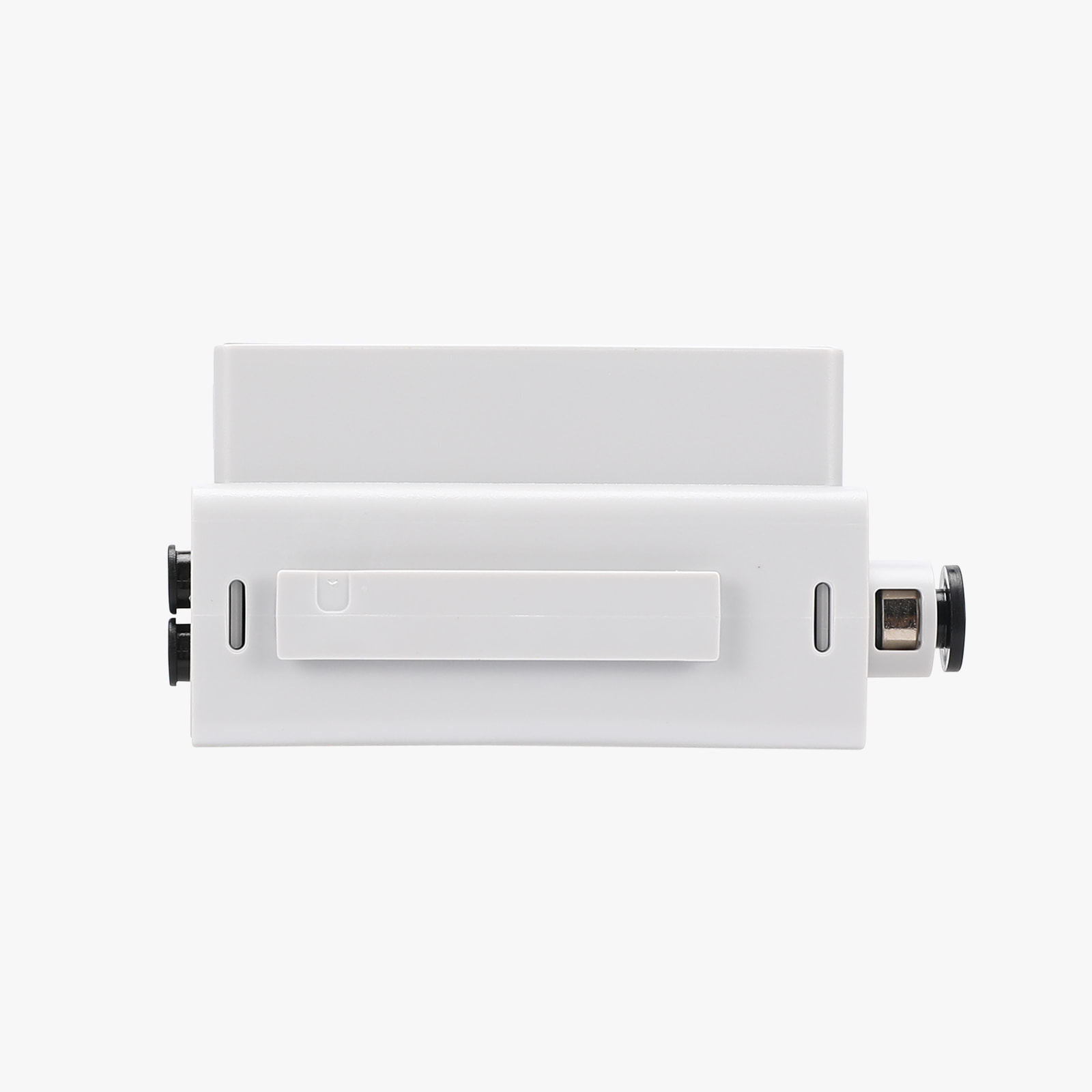

I’m going to ask an annoying question, but only because you didn’t mention it. Did you add the special A1 AMS Hub? It looks like this:
I’m honestly a bit surprised that the control signal could be degraded this badly to the point of not working at all. I do know there are shorter and longer versions of the AMS cables, perhaps try asking Bambu support to send you a set of the shorter ones?
