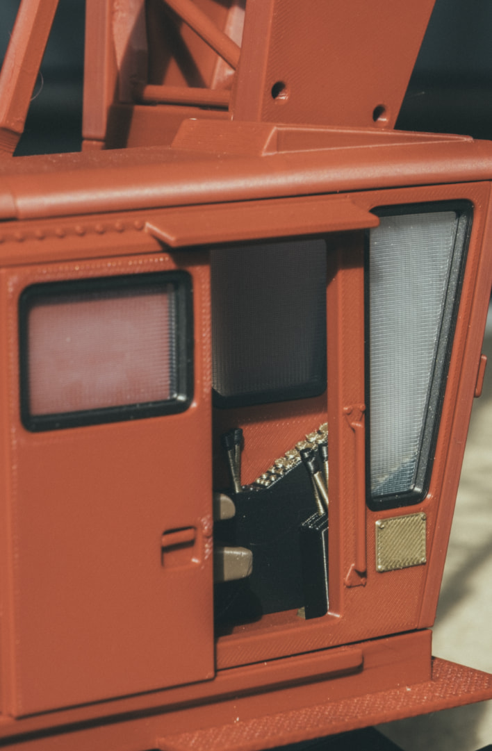

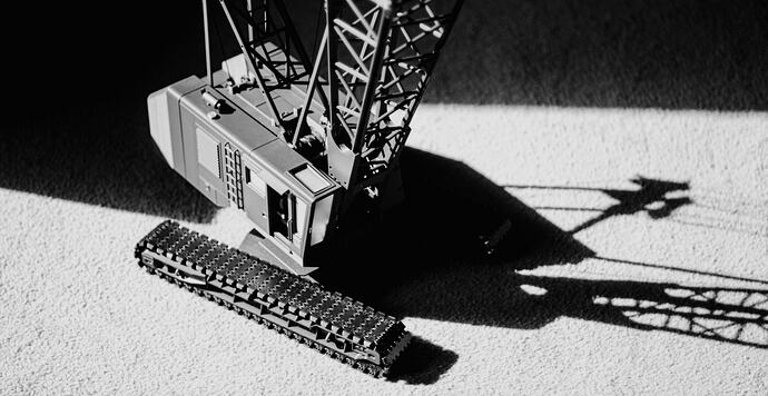

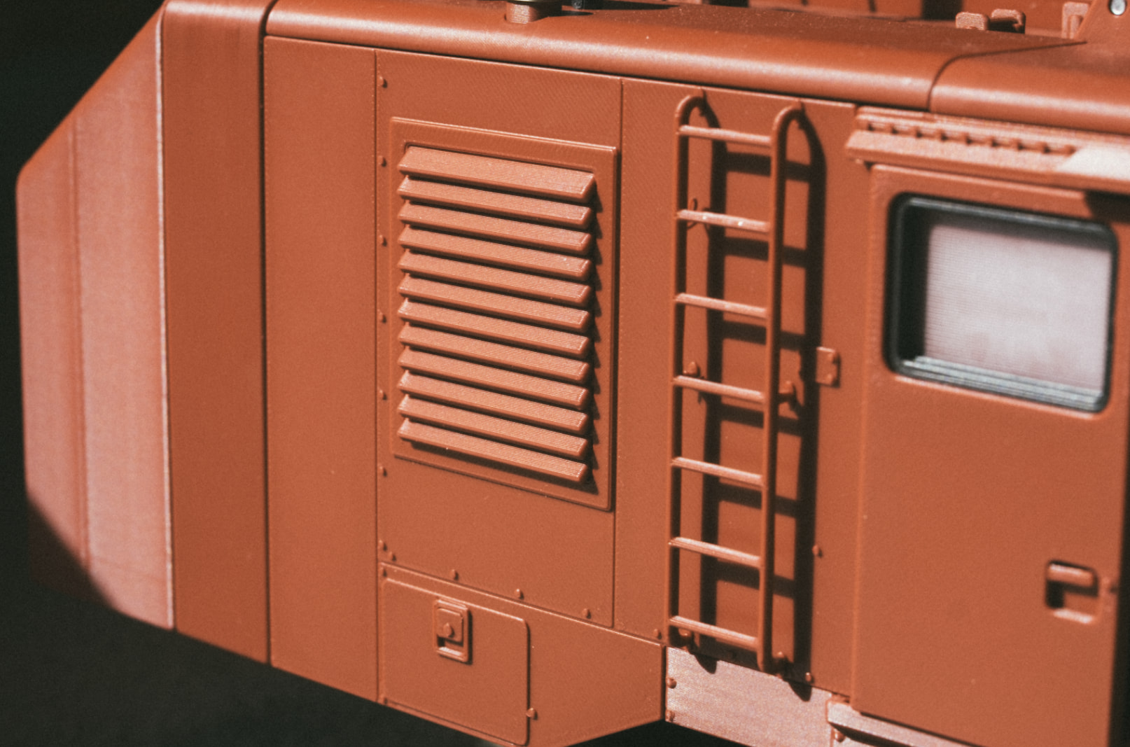

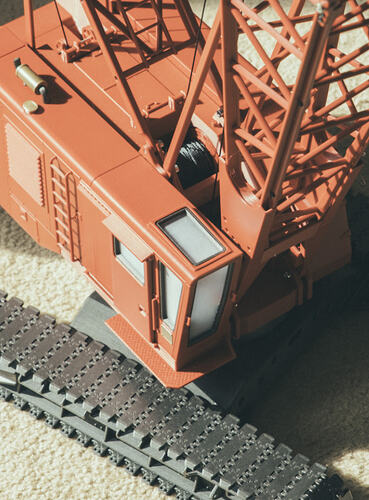

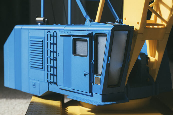

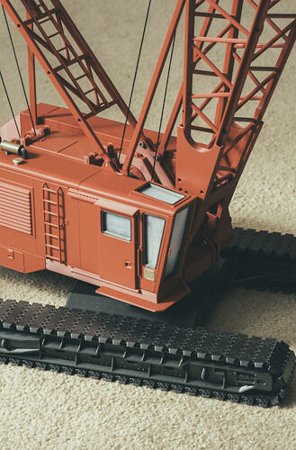

You guys! It’s here! I finally got it published. I’ve got some extra work to do, but all the main print profiles and the main assembly instructions are up.
I’m gonna link to this thread on the Makerworld page, and encourage anyone interested in building the crane to come talk about it here.
Keep scrolling for more photos too! I’m gonna post a bunch of extra photos up on here.

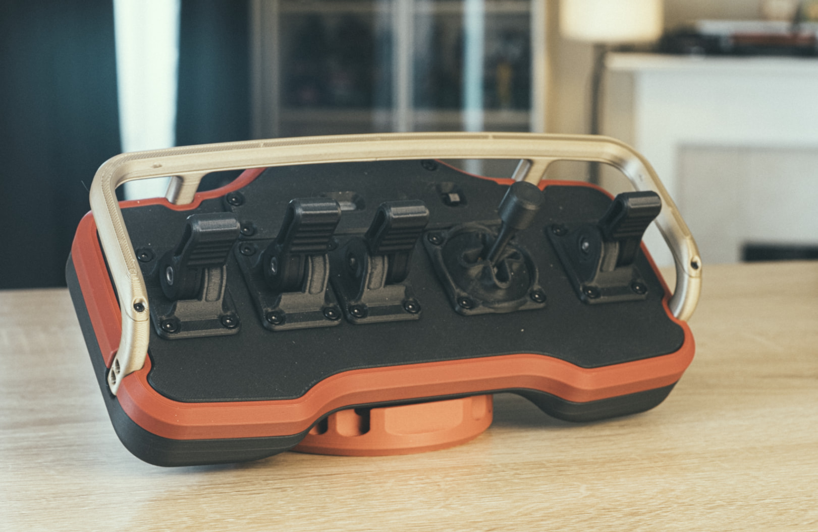

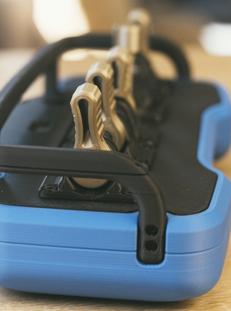

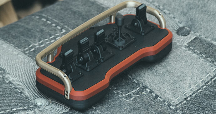

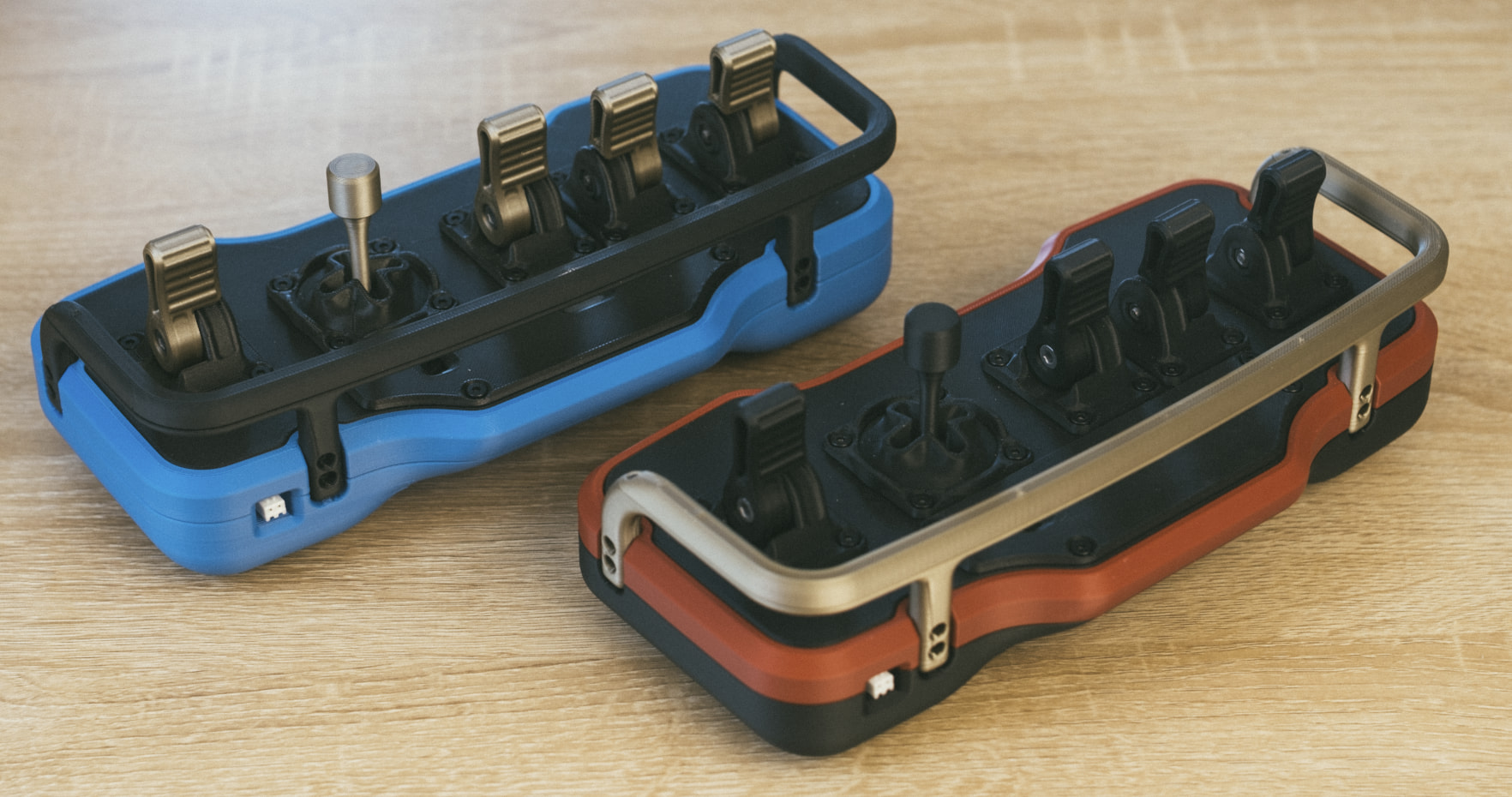

A few photos to show off the controller a little closer up. I have this idea in my head that with every Cyberbrick project I approach, I want a custom controller for it. I think the controller is part of the experience, especially for a model like this. I wanted something that made you feel like a crane operator, that pulled you further into it, into the fun.
Ahh, I need to take a few more photos of the battery bay with the latch. It uses a spring plunger, and has a nicely satisfying click to it as you rotate it into and out of position.
I also incorporated a charging port! No having to disconnect the battery!

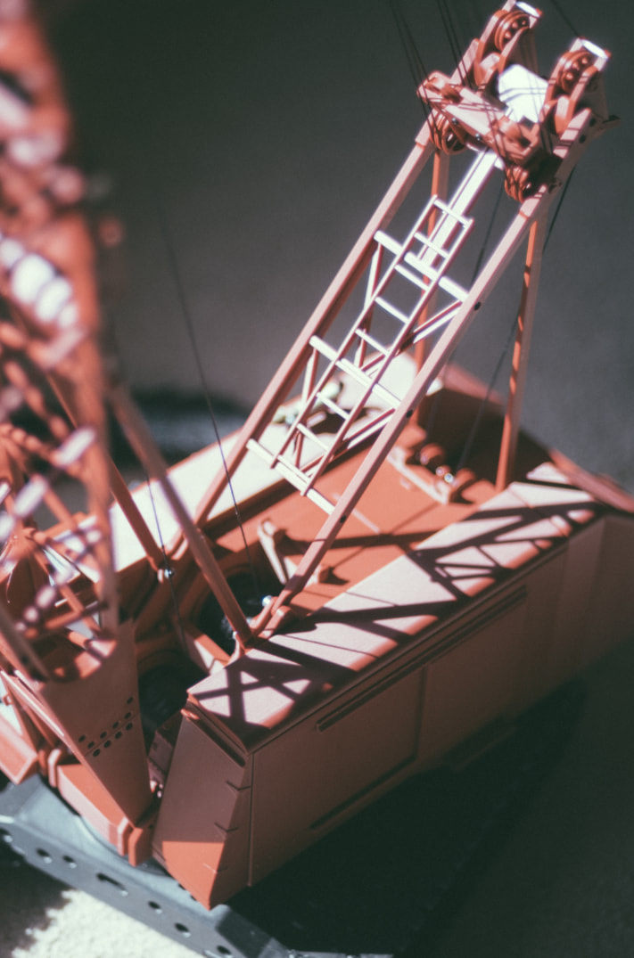

I had another photo session this morning, haha. The ones I snapped yesterday weren’t enough.

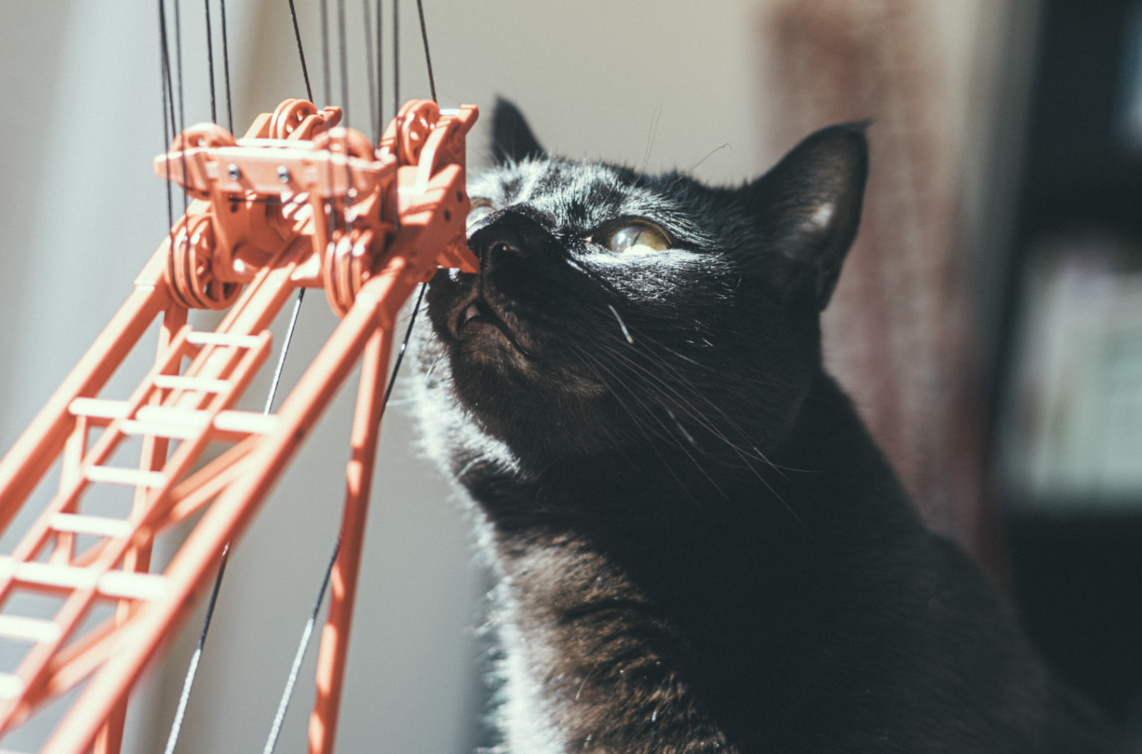

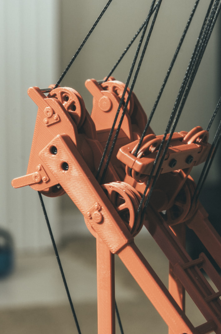

Hello, I had a quick couple questions. I think I might be over looking what material, and a rough amount of rigging was used for the crane cables. Do you have a certain brand or material you use?
I still gotta get the description fully flushed out! So you didn’t over look anything.
I’m using 1mm braided fishing line. (This one). With 100m of line, it was enough for two cranes, roughly.
Also, I saw your comment on Makerworld. I’m surprised only the magnets were out of stock! I’ve been watching stock levels as I built the BOM. There were a lot more things out of stock. Luckily with the magnets, those can be sourced elsewhere easily enough.

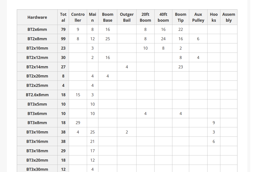

Oh sorry. Thanks for the information on the line. I will def. Pick some up. That’s a lot of help! Yeah I usually never get that lucky when ordering things, but I did outsource the magnets from Amazon. Just to make sure the link you click on for makerworld with add hardware to cart list, that is basically the amount and all bolt needed. Is that how that works? I only been printing for a couple weeks now and only thing I really been working on is my droid division b1. So not sure about how parts work through makerworld. Thanks again for the response.
More or less. They don’t sell exact amounts. So like with screws, most of them come in packs of 20. So, you’ll end up with extras. Hopefully I got everything listed correctly! :grimacing: Feel free to come yell at me if anything is missing.
I added a table to the description that gives the hardware breakdown and the filament usage breakdown. The hardware one goes a bit further than I can reasonably take a screenshot of, haha.
Wow! Thank you! I would never be upset about any of this or yell lol, you have been very helpful, and you’re the one who was kind enough to share your work. I really appreciate the help so far, but hopefully you won’t mind when I start working on it if I have more questions.

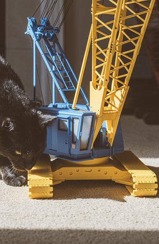

Got the first video up. Just a little short!
We need a full length assembly video
Including a demonstration of the crane lifting a cat

I wanted the project as a whole to be up there with the level of quality you expect from 3dsets! I tweaked a bunch of little things with how my documentation is done. I hope it’s all clear enough. Like I mentioned previously, I’ve assembled several of these now, so it’s easy and straight forward to me. I’m waiting on the edge of my seat to see how it goes for others.
It’ll give you some extra screws too for all my other crazy projects. :sweat_smile:
Although, the screws used for the booms are right at the limit of what’s supplied, so you might want some extra M2x6, 8, and 10s, if you want a extra boom section.
