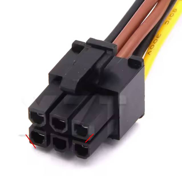

I’ve searched the normal sites and Amazon without success. Has anyone found or made a 90 degree angle connector for the back of the AMS to allow it to be pushed closer to a wall for example? Unfortunately I have limited space for my units on the shelf and the way the cord sticks out of back of the unit doesn’t help.

Just to be clear this is the 6 pin connector, not the power connector.
AFAIK, this does not exist.

  4. Use a molex connector and rewire an AMS 6-pin cable to it, it will not protude and give you more clearance than the original. You can use the below link which from the picture shows the right coding of each single connection.
https://www.aliexpress.us/item/3256805261455975.html
or use a standard graphics card molex connector as long as you cut 2 angles to make it fit as below:
