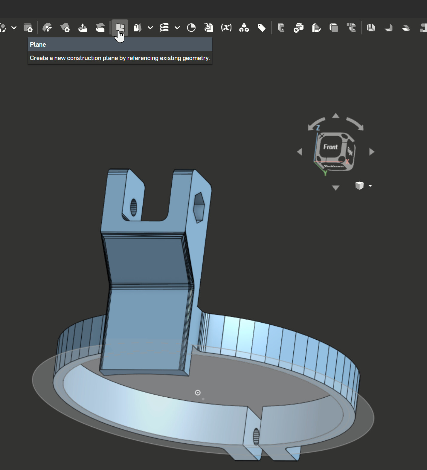

Example; I need to make a part at 45 degrees off the X axis. Just making the 45 degree plane was difficult. Once made, now to thee adventure of locating the part to where it needs to go. I cannot lock into a view 45 degrees off the X like selecting “Top” and you’re there.

From your description, it sounds like you want to create an angled offset and extrude from it. The easiest way I found is to create a plane at the angle you need. For example, for a 45° bracket, I’ll create a plane offset from the X-plane at 45° and sketch on that. Note there are fancier ways like picking a geometry point on a feature and then selecting the angle from there. My brain is simply too old to grasp that trick readily, so I keep reverting back to creating offset and angled planes.

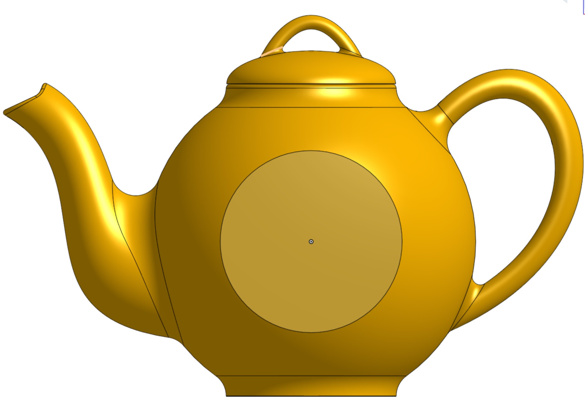

Anyway, I got through it and made my teapot as shown in the picture shows and 3d printing it right now. I do not mean to say that I mastered all the constraints at all. What I basically did was I got accustomed to how OnShape worked and accepted a new way of doing things. And I remade my model from scratch. I did not delete anything out, but I basically started fresh and as I went along, I put constraints in. When the constraint lines turned black, I knew my model was clean. That built confidence.

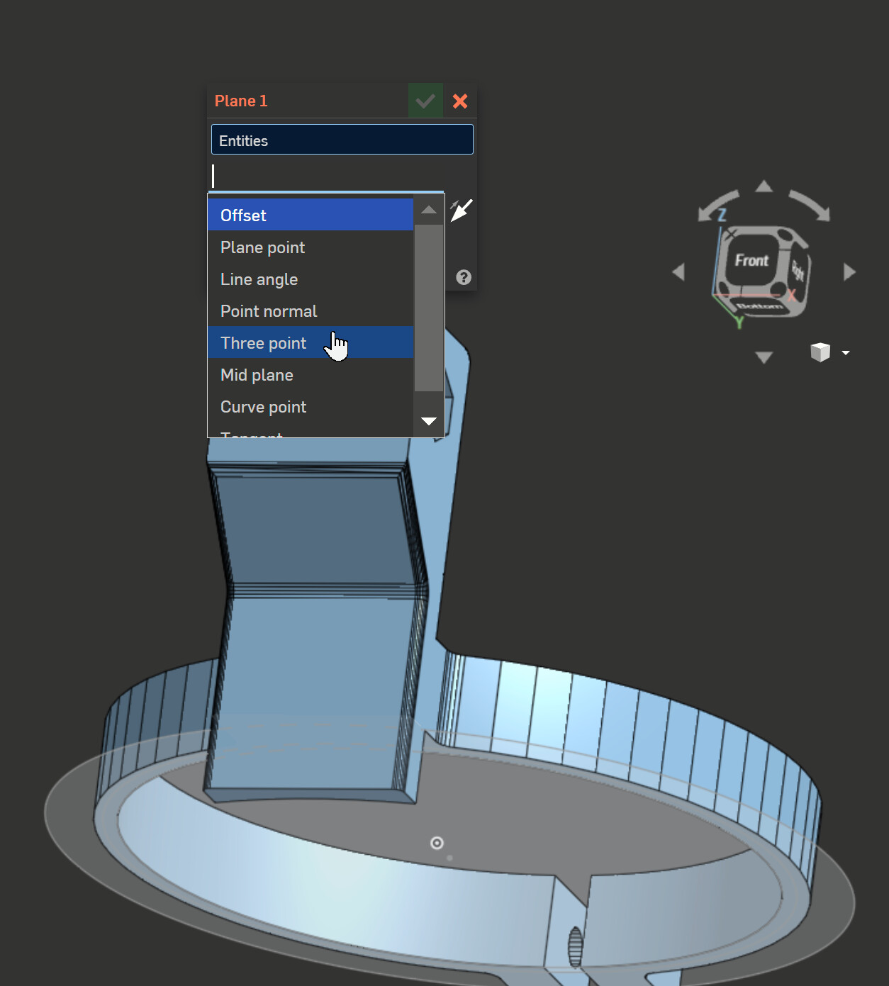

Anyway, a few things I would like to see in OnShape. One thing I do miss is miss is in Unigraphics is I could put three points on a edge and develop a plane from those three points or create a curve off the edge or a plane with the three points. I found that feature useful as we worked with translated data in which nothing was parametric. Maybe I could get OnShape to include that.
Take care!

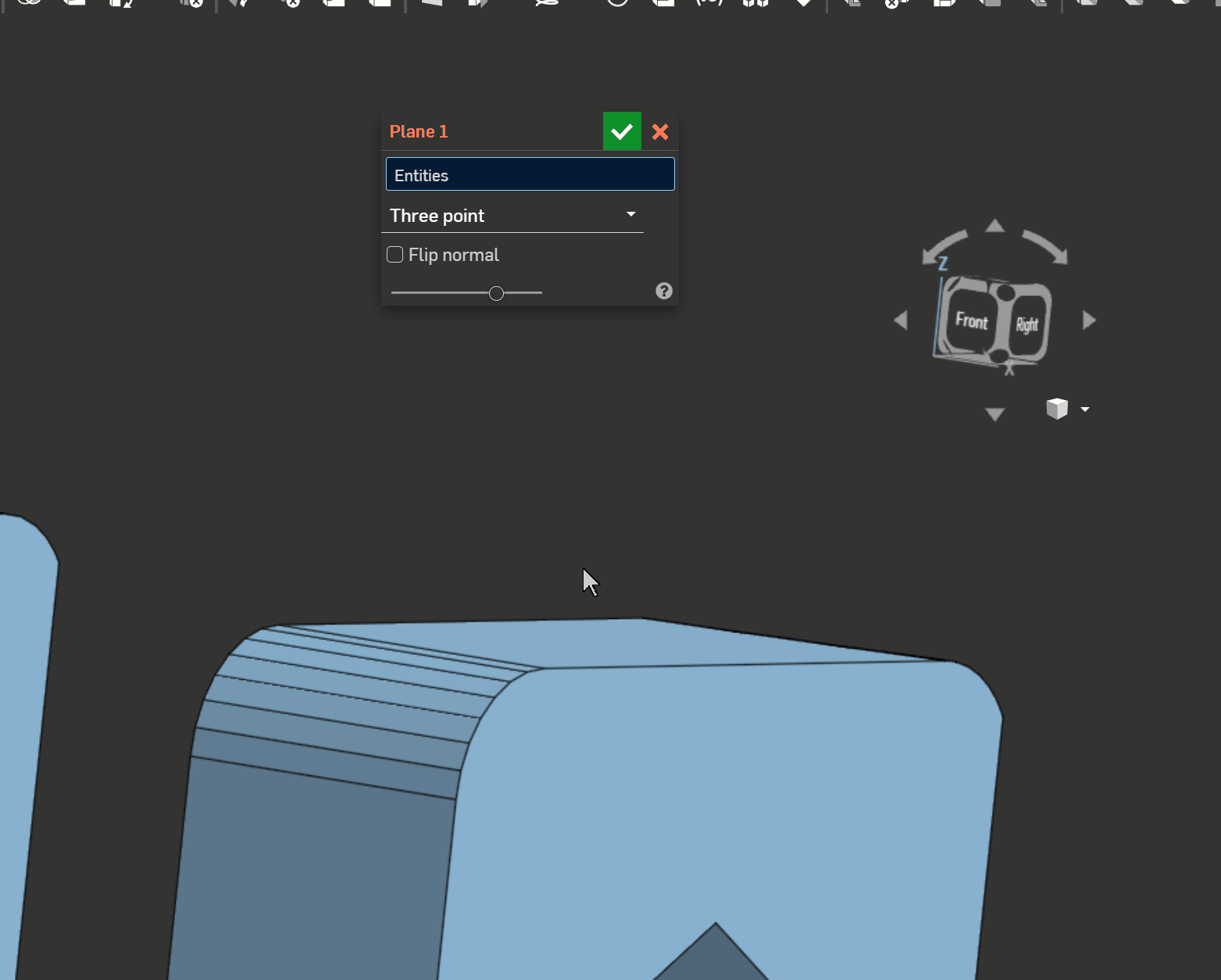

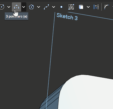

I’m pretty sure you can create a plane from 3 points.
3 points

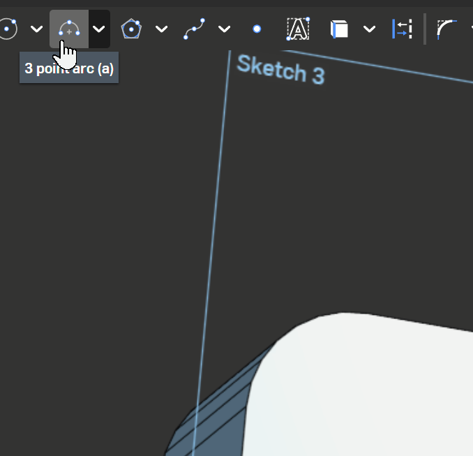

With curves, there are multiple ways but I’ll show just the simplest using a 3 point arc. You Could do this as easily with a 3 point circle or if you were trying to do a multipoint curve, you could also use a spline but that is more advanced.
3 points curve

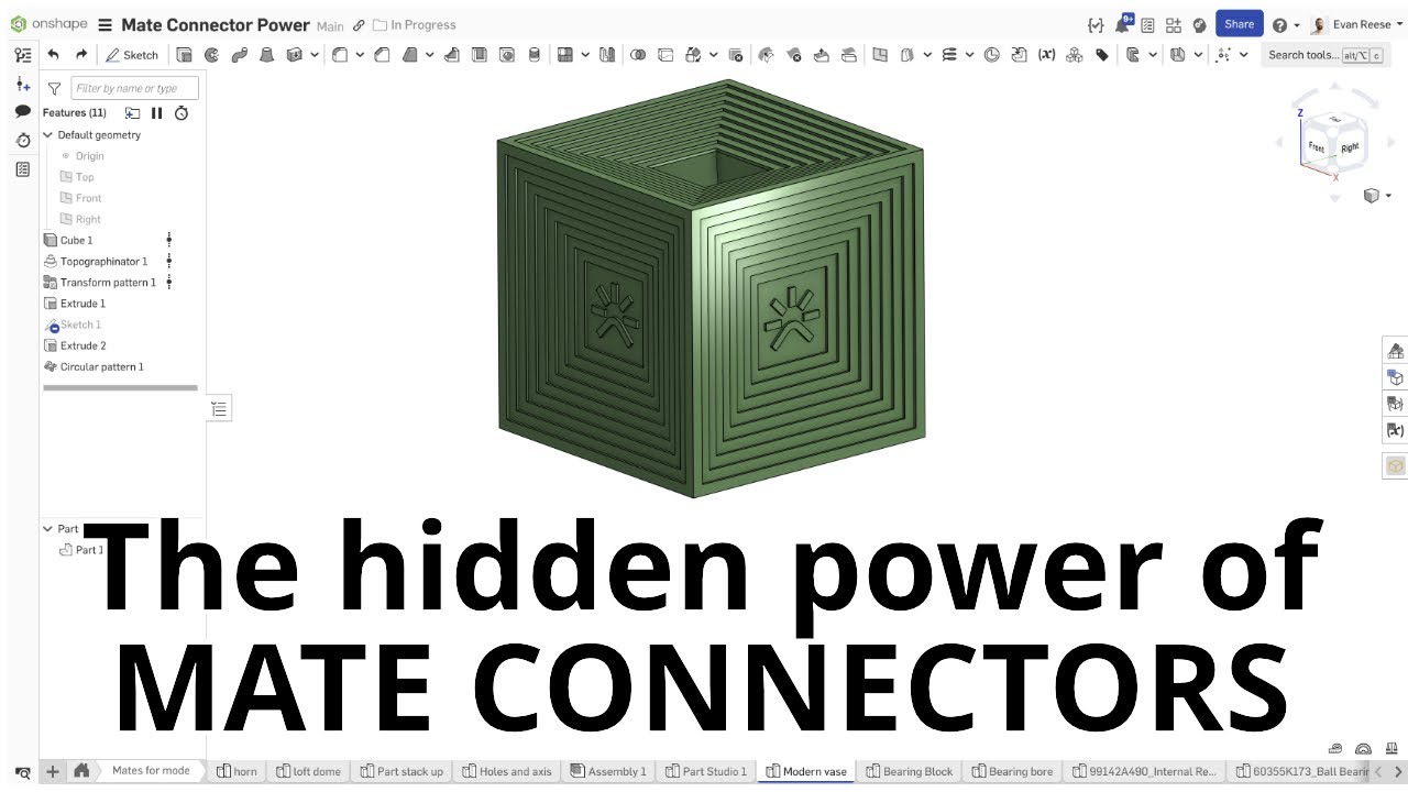

I recommend this video on mates that he did a couple of weeks back. There he shows some things with using points, curves and lofts that my brain is still trying to digest but it really shows off the power of OnShape’s curves and planes in a non-linear manner.
Yes, I was able to create a plane! I was trying to use the point feature to create the points on an edge first. There’s so much to learn. I’m on the free OnShape software and find it is surprisingly high quality. Much to learn. Thanks!
