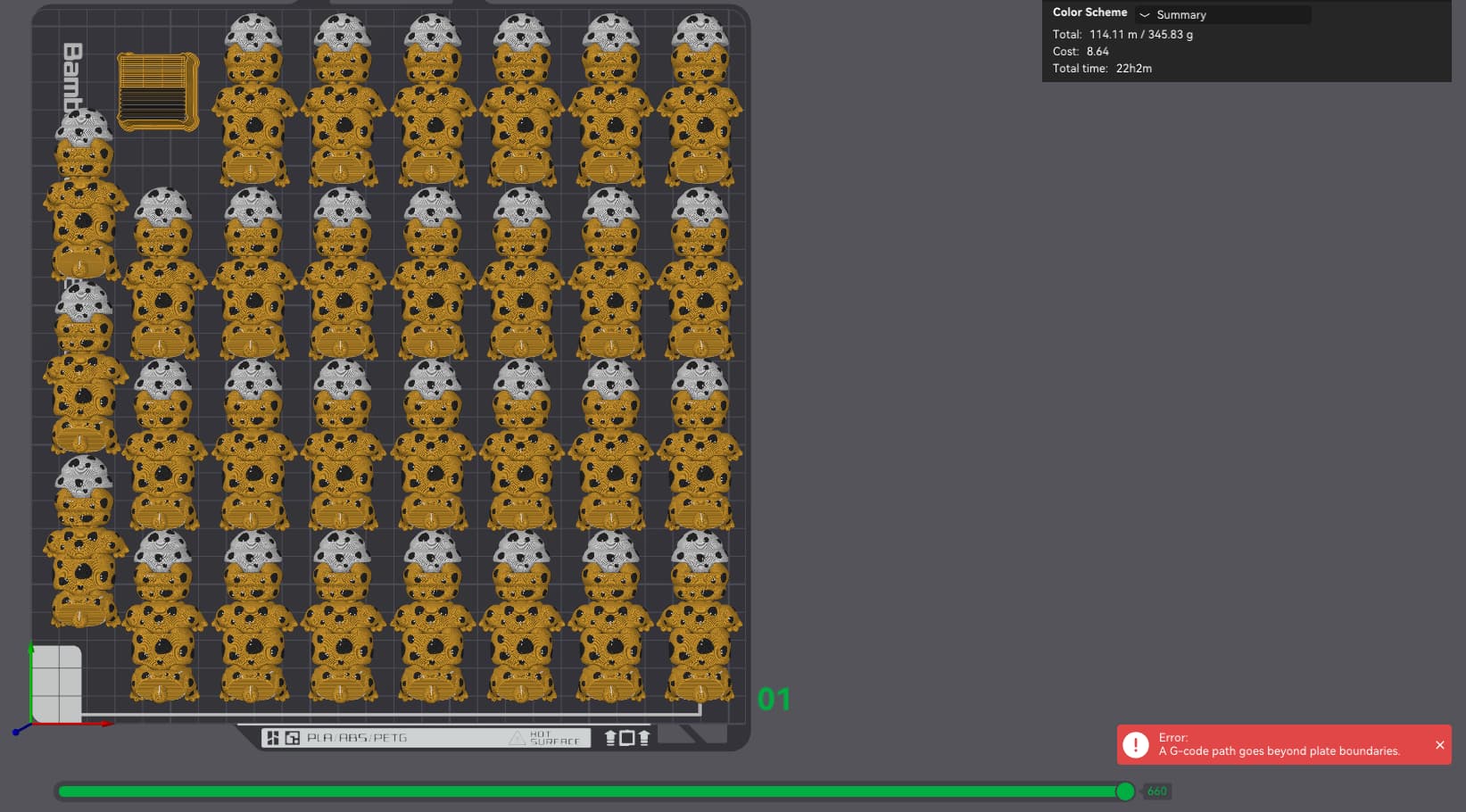

Hi all,
I’m getting this error even though the models are not exceeding the build plate.
Does anyone knows why is that?
Thank you.

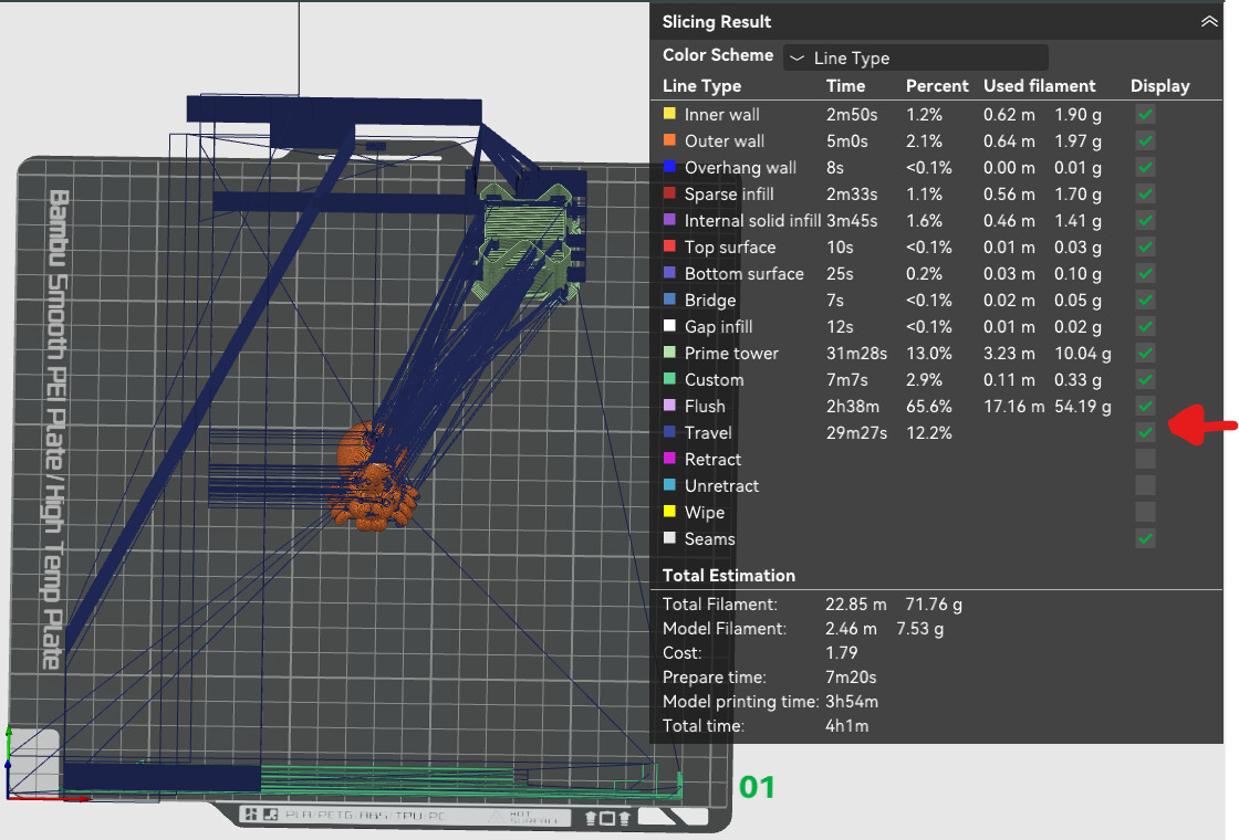

You may want to enable the visualization of the travel paths in the Line Type Preview. There’s likely one or more that exceed the allowable build volume (other than cutting and pooping).
Mhm, strange. I can see that you have already shuffled around the tower. You may need to reduce the number of objects on a copy of the file to spot the one or the line of objects causing issues.
move everything on the plate down 1 pixel, I dunno if orthographic but it looks like you’re off the top edge
