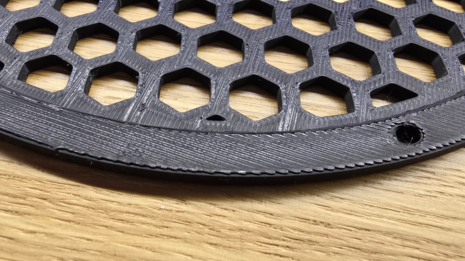

I think I’m hitting some slicer or firmware bug. I’m using X1C and Bambu Studio 1.9.7.52. I have one print that constantly fails in the same way even after re-slicing:
I was trying to track this down by inspecting thelayers in Bambu Studio after slicing. I also tried to use external code viewers, but I can’t find the reason.
I’m trying to print this:
Observations:
  • it seems to be printing up to and including layer 17
  • where it fails is, I think, layer 18
  • notice odd issue in the inner ring - there is this part that looks like thinner filament lines
  • the last printed layer in the outer ring does not have the walls printed but it does have the solid infill printed which comes after the walls
  • the print somehow fails completely after that
  • the print always fails at the exact same way

I will definitely try to increase the number of falls, but I’m trying to find out if the issue is indeed in the model or if it’s a bug. I printed numerous cylinder-shaped models with similar settings with no issues (even ball-shaped without supports). Also, what made me curious is why it’s a complete spaghetti - I would assume at least some parts of the model should “try” to print, like solid infill on top of existing infill, or the top surface on the solid infill (which layer 18 is for the outer “ring”. Also the infill in the center should continue printing, or really some other parts of the model, yet it’s a complete spaghetti. What’s more, the outer wall (around the whole model) did not print, which I guess could be because of what you mentioned, but the solid infill did:
and then nothing on top of it anymore.
There is also this:
(which I do not see how this could happen by examining the sliced model)
Or this:
So, the fact that:
  • it always breaks in an identical way
  • it’s a complete spaghetti (like it’s skipping a layer?)
  • no filament is extruded onto the printed part in any part of the model
  • I printed it successfully once before and it was a flawless print (but I do not have this 3mf, don’t know the difference(s))
  • there are other imperfections I can’t explain
    made me think it may be some sort of bug.
I’m pretty sure I may just change some setting or settings and make it print, but I’m also trying to figure out what’s the exact reason of a fail like this (where at some point nothing more is being printed on top of the previous flat surfaces)

So I re-printed the successful one (from almost 3 months ago) from the print history using Bambu Handy and what do you know:
The imperfection in the inner ring that I mentioned is also not present as well as other imperfections - photos taken at the beginning of layer 18 on a running print, I was watching it closely this time to see what’s going on if it fails:
So, as I mentioned earlier, I took the 3mf file from the cache folder from the SD card, unpacked it, and retrieved gcode file. I then exported gcode from the failing 3mf in Bambu Studio (the recent one that I was using that failed 3 times in a row in an identical way, I’m using Bambu Studio to run the prints through the cloud). I compared both files using a diff tool I was expecting to find some differences that would explain this behavior. What’s more, I expected the gcode to be this different that I would have a hard time to diff between the files. To my surprise the gcode of both was identical except for the filament settings - previously I was using the Generic PLA profile, but later I created a filament-specific profile (DevilDesign PLA) using the manufacturer’s specification pdf. I printed so many things using this profile without any issues. Anyway, the only differences in gcode are these related to the filament profile:
