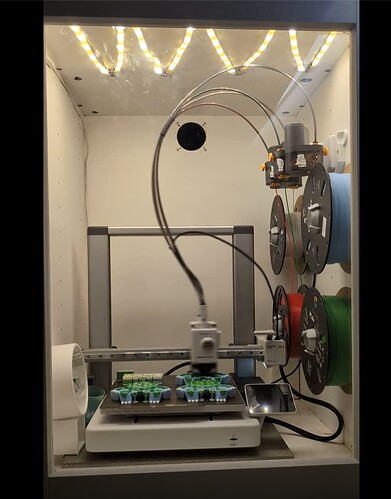

Yep — that’s why mine is in an enclosure but I only close it when it’s not printing. Amazon.com: Upgrade 3D Printer Enclosure for Bambu Lab A1,A1 Mini with LED Light,Iron Frame,Fan Extraction Kit,Thermo-Hygrometer, Fireproof Dustproof Tent Constant Temperature Protective Cover,850 * 580 * 580mm : Industrial & Scientific

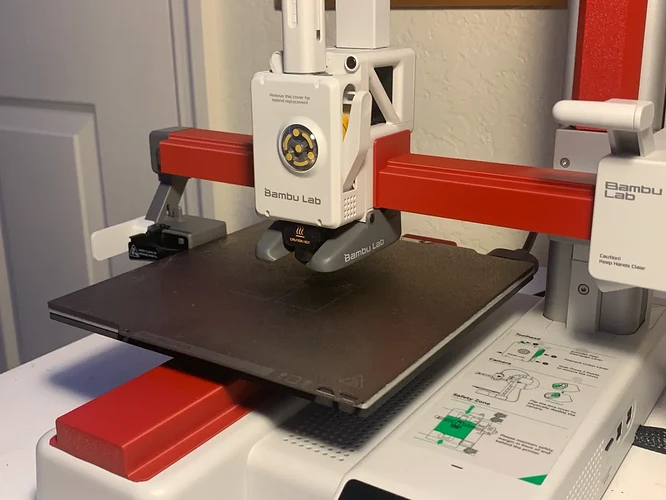

I use this one to prevent dust gathering in the X-Y-Z rails on the A1 Mini.

TOPCUBE enclosures come with additional active air extraction kits, with a flexible tube for disposing of fumes elsewhere.
It’s not such a big deal to put a fan at extraction point that forces air out of the enclosure through an HEPA + active charcoal filter. You even have printing blueprints for this.
