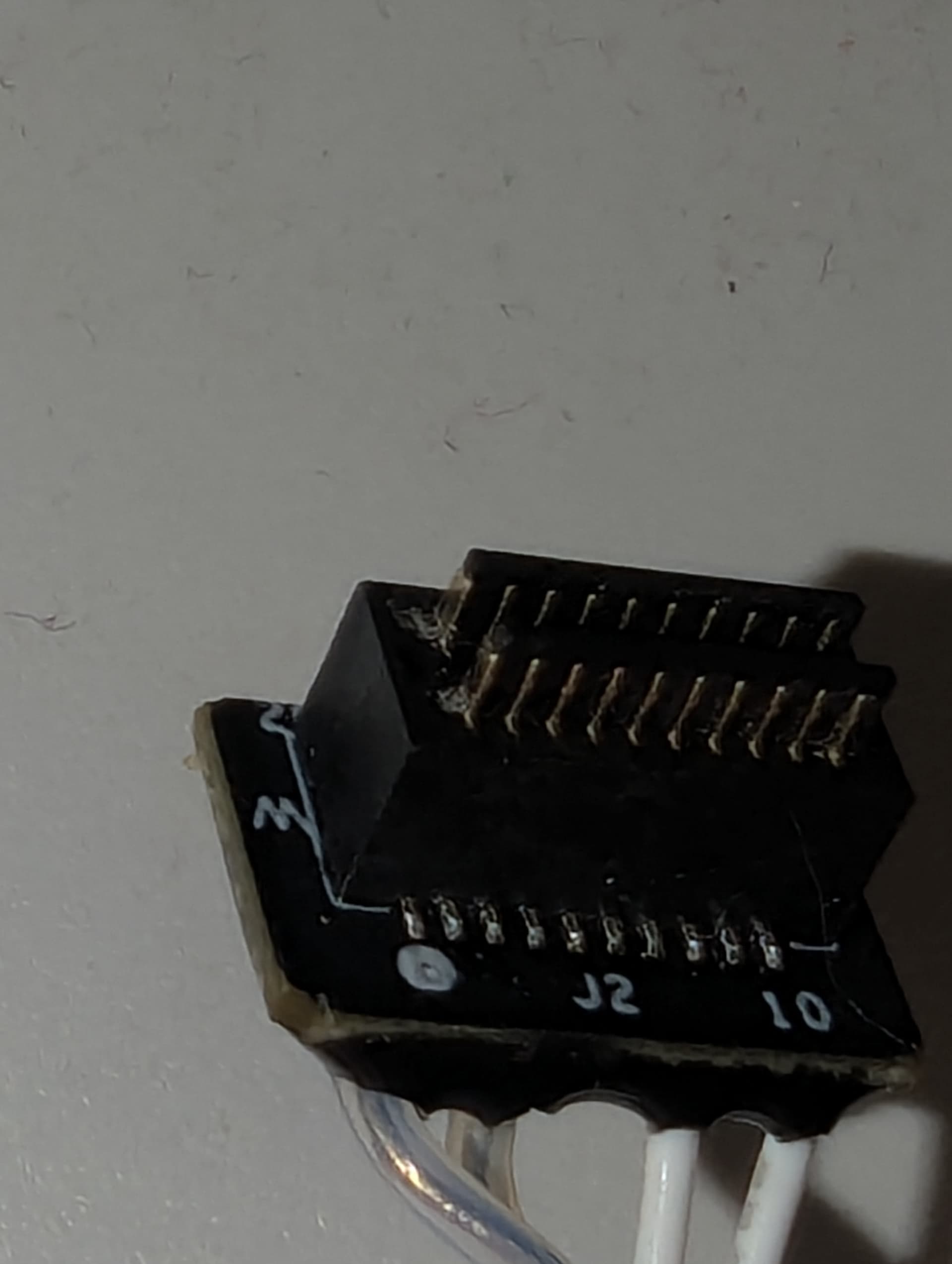

A1 Hotend Heater Assembly plug loose on TH board
On my A1, while chasing down an error for the cutter being stuck, I now have an issue with the black Hotend Heater Assembly plug going into the Toolhead Board. I had to remove all of the connectors to pop the board out to fix the cutter issue. All of the white connectors snapped into place fine. The black one did not. I don’t remember any issues with removing it.
The plug is completely loose, not snapping in at all. The plastic of the plug is sitting completely flush to the board socket. The pins all seem to look good and straight, all there. The sockets look clean, nothing lodged. I can’t see how this is supposed to snap into place at all, and pictures I have looked at online don’t seem to show my connector missing anything. This is resulting in an abnormal temp error on the Hotend.
I don’t know which part is the problem, the plug or the socket. I have tried to force tension on the plug when it is inserted and powered on, but the error is still there, telling me that the pins aren’t contacting even when flush. It is like I’m missing a piece between the two parts.
Any ideas?
I think I might have found the issue. It looks like there is a tiny bit missing on the end of the plug connector.
I’m having the exact same issue - did you manage to resolve it?
Same issue here. The connector will not stay in. I as well have added a tension pad on the back of the connector, still having issues with alignment?
Here we are with the same issue - only it’s year later. Everything looks good. Any ideas on what do to fix it. Is this something that I should open up a ticket for? Thanks everyone!
Just commenting to say thank you, my P1S started throwing the dreaded 0300-8008 abnormal heating error today - the only clue was that the heater plug felt a bit loose, but it looked OK to me. Your post made me go back and check closer and sure enough, I’m missing the same piece from the same side. Not entirely sure how as I haven’t changed anything on the hotend in ages. Glad I don’t need to buy a TH board!
