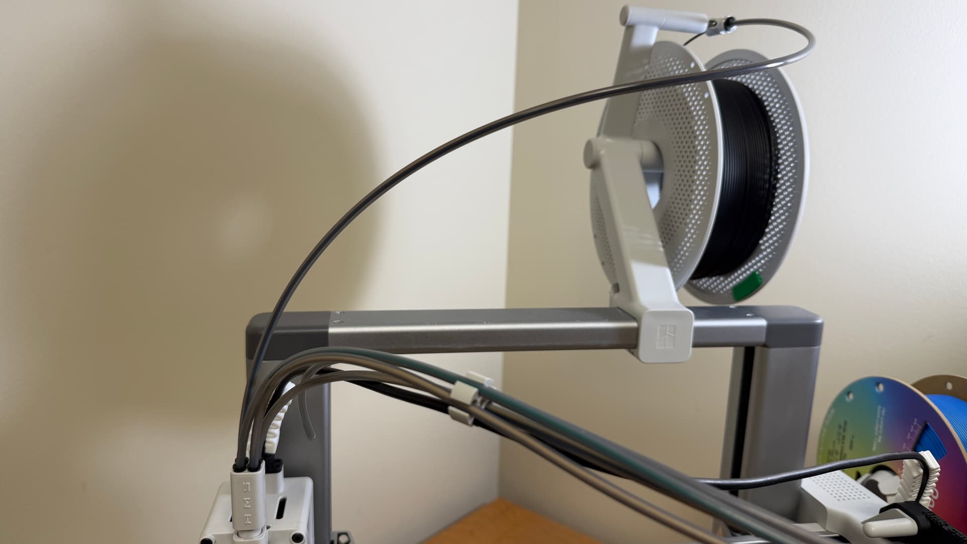

Got a chance to try a different approach this weekend. Turns out. If I bypass using the AMS and route filament directly into one of the spots in the 4-way splitter, choosing external in print settings, there is absolutely NO Issue. So not an issue with extruder pursae, just odd that the AMS causes an issue with .2 nozzles? I verified there was plenty of slack when using AMS and two different positions and it caused an issue. If I bypass the AMS entirely, using the same formerly failing filament, no issues on multiple test runs.
