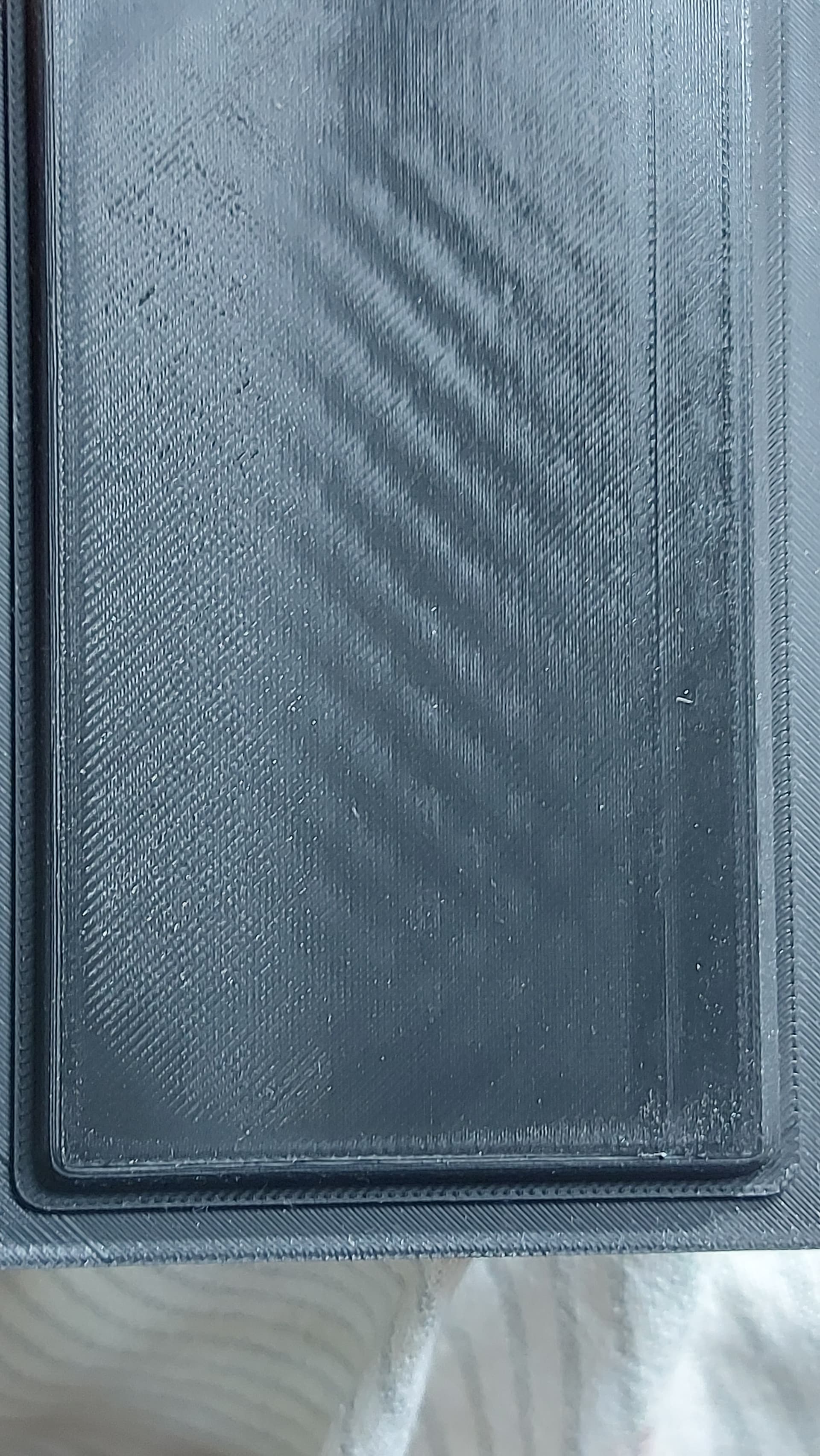

A1 Ironing continues to fail; do not understand what causes this

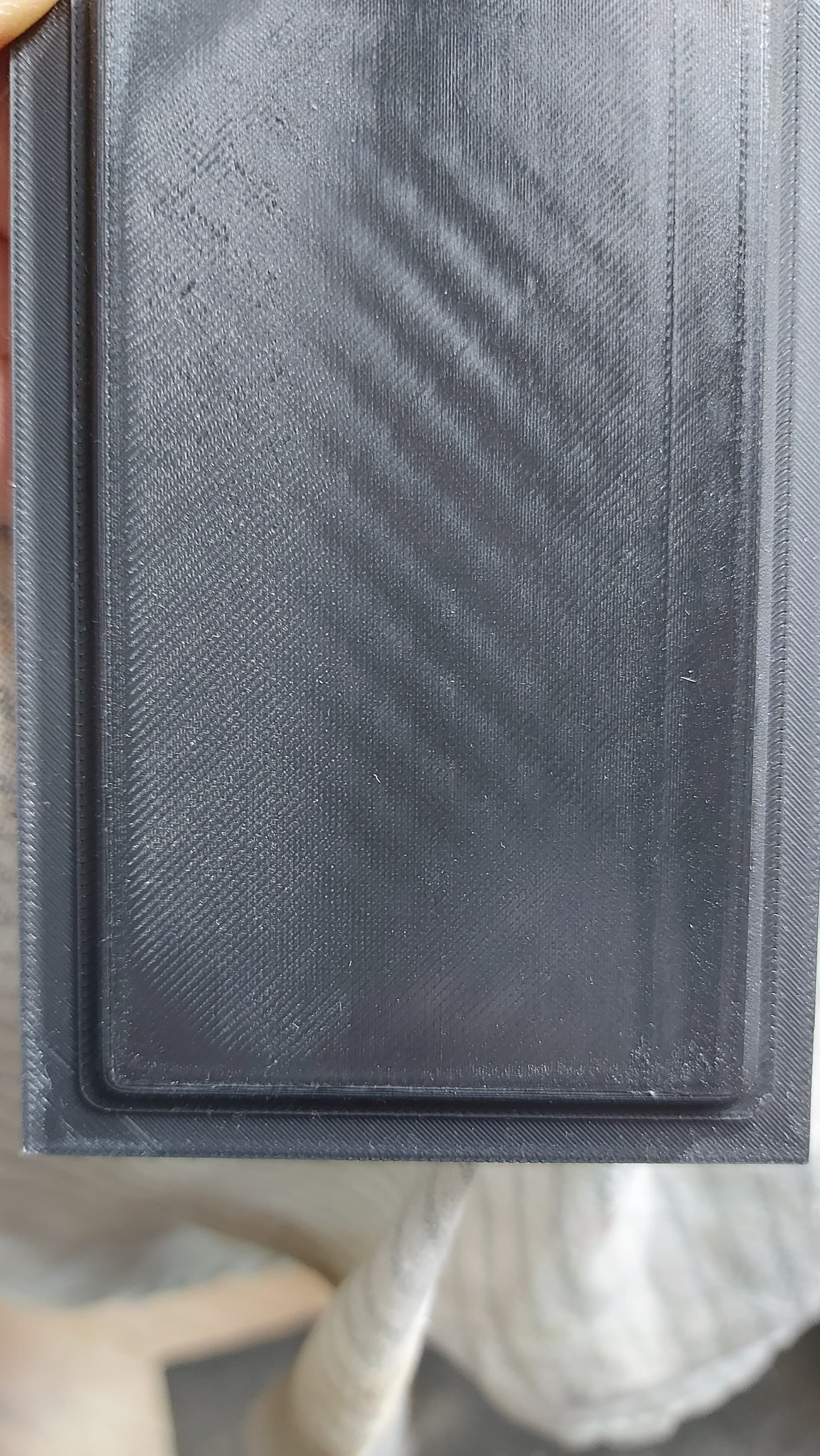

Hi, Having (again) this strange phenomenon:
Ironing starts off very nice and then suddenly starts to create a rough aspect.
The toplayer without- ironing looks normal and acceptable but when ironing is activated I get this
aspect as on pictures.
Since the first 22 mm are ok and nothing changed in the meantime, I rule out the filament (PETG, of TM3D company) the model is printed on the engineering plate and stays perfectly flat so no shrinkage; the plate is always calibrated before each print;
pls note that after ironing I had to sand the surface as it was not usable, however the issue is still clear.
hope to get some suggestions
rgds Tom

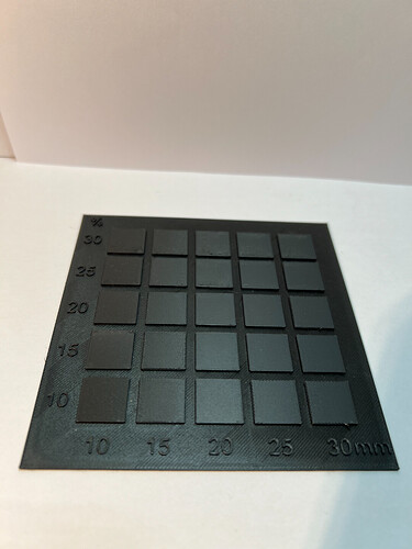

More practical solving: Print this, using your current projects settings
Make note how the surface changes as you increase specific speeds and flows
Find a swatch that looks ragged like your actual print
Alter your ironing flow/speed in the direction that the swatch seems to show improvement on. (if the swatch is ragged at 10% flow, and smoother at 20% flow, increase your ironing flow. Or vice versa. Or if its more ragged at slow speeds and smoother at high, up your speed. or vice versa.)

Thanks for reply; I made 3 tests with PETG (supplier TM3D netherlands). this is what i did:
test 1 (with sp20/flw27) best result sp10/flw15%.
test 2 (with sp10/flw30) best result sp30/flw15,20,25 and 30% were acceptable
test 3 (with sp20/flw25) best results sp10/flw15% and sp30/flw25 and 30%
which gave me no clue what to do.

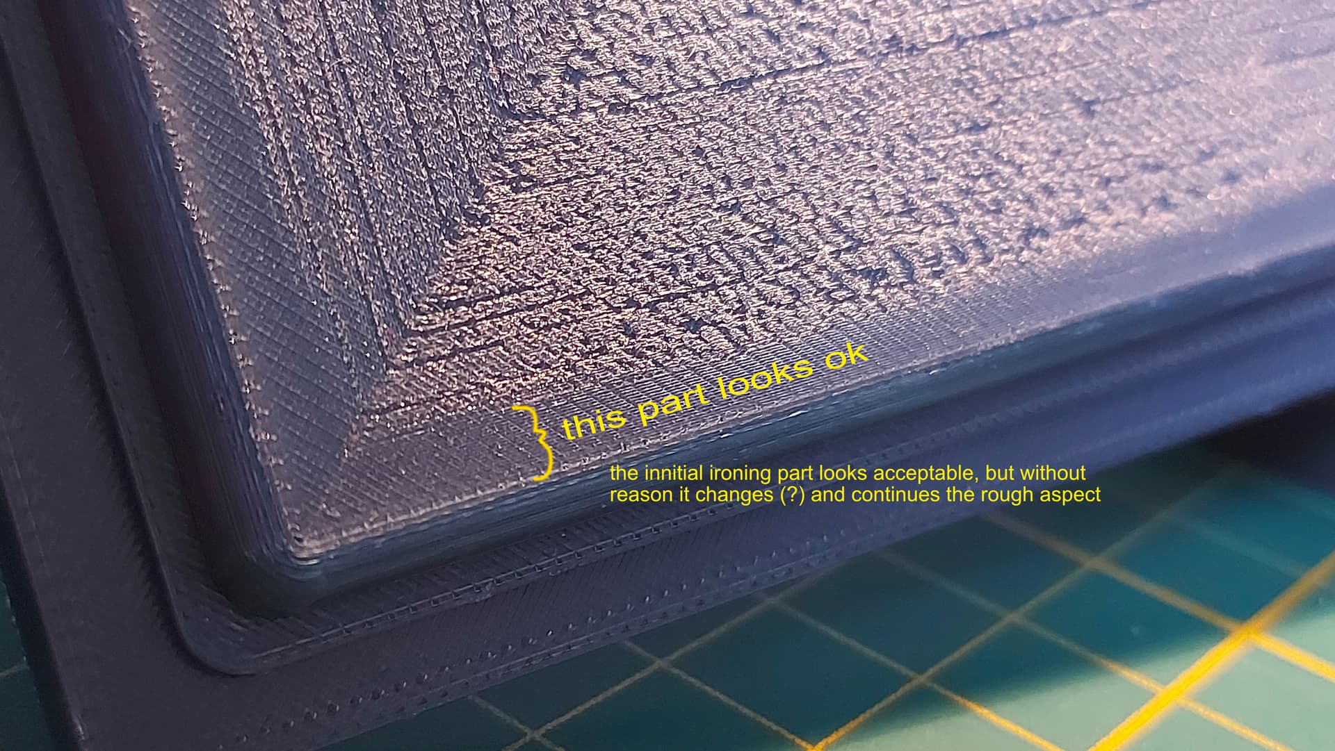

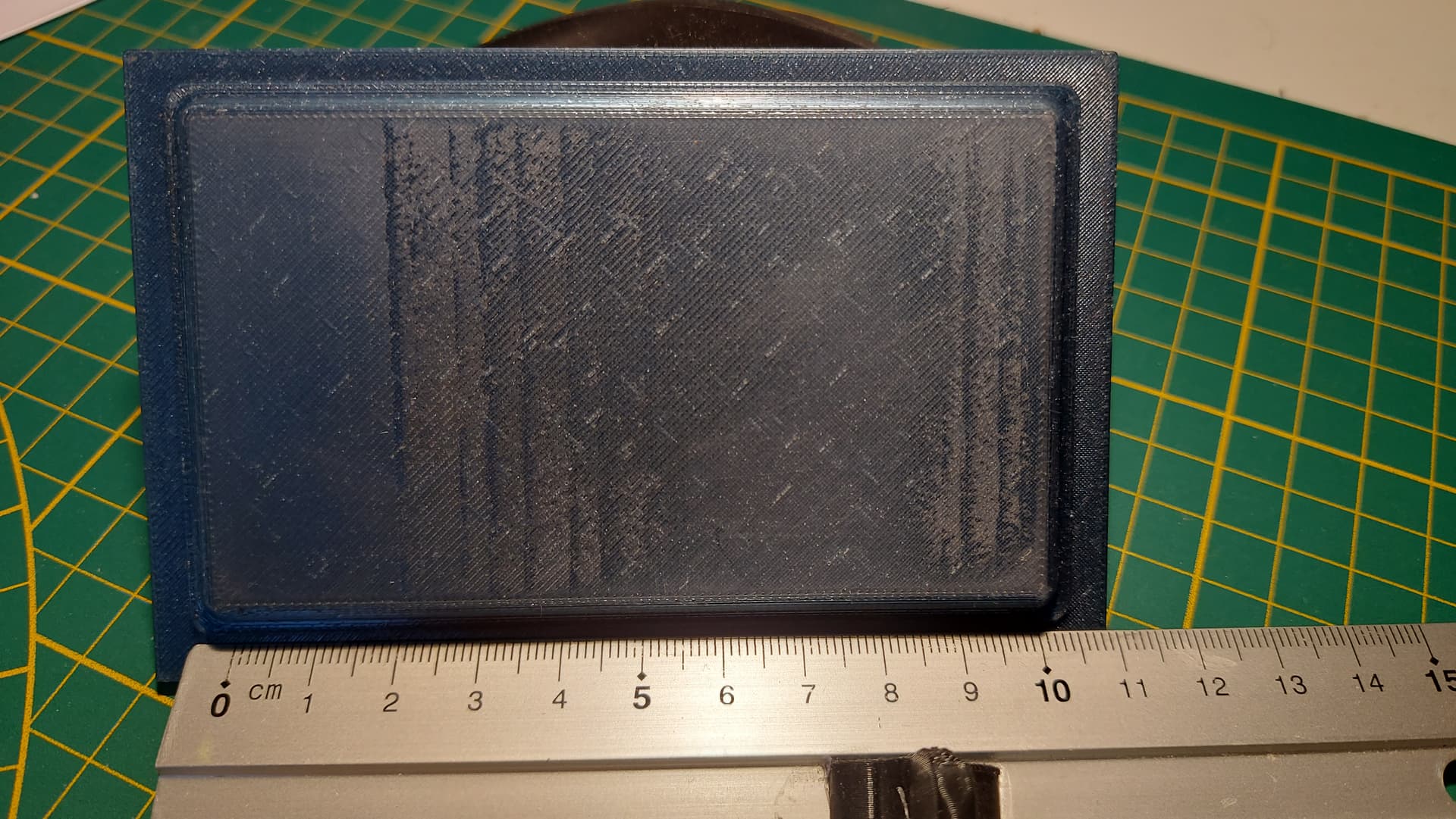

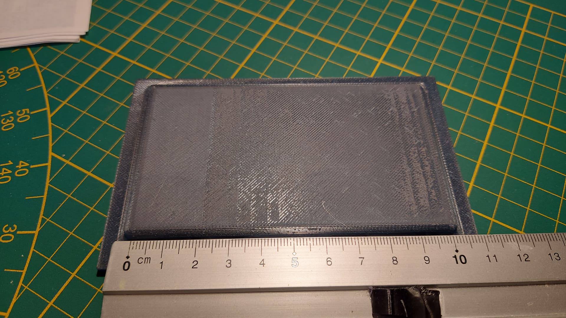

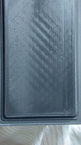

Did a bigger surface (60x100) with sp18/flw20 ref pict PETG 1.
Since I experienced previously that the ironing was acceptable up to a small area in the beginning and suddenly switched over to rough, I wanted to see what happened if ironing was set to concentric.
Again the first couple of lines were ok then suddenly a big change on the next lines and the rest is printed fur. pict 2 and 3.

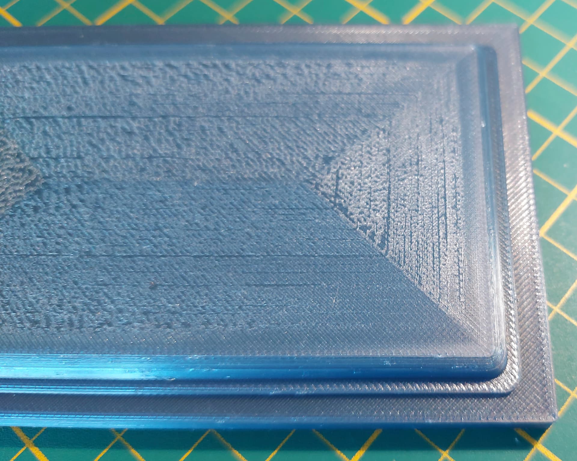

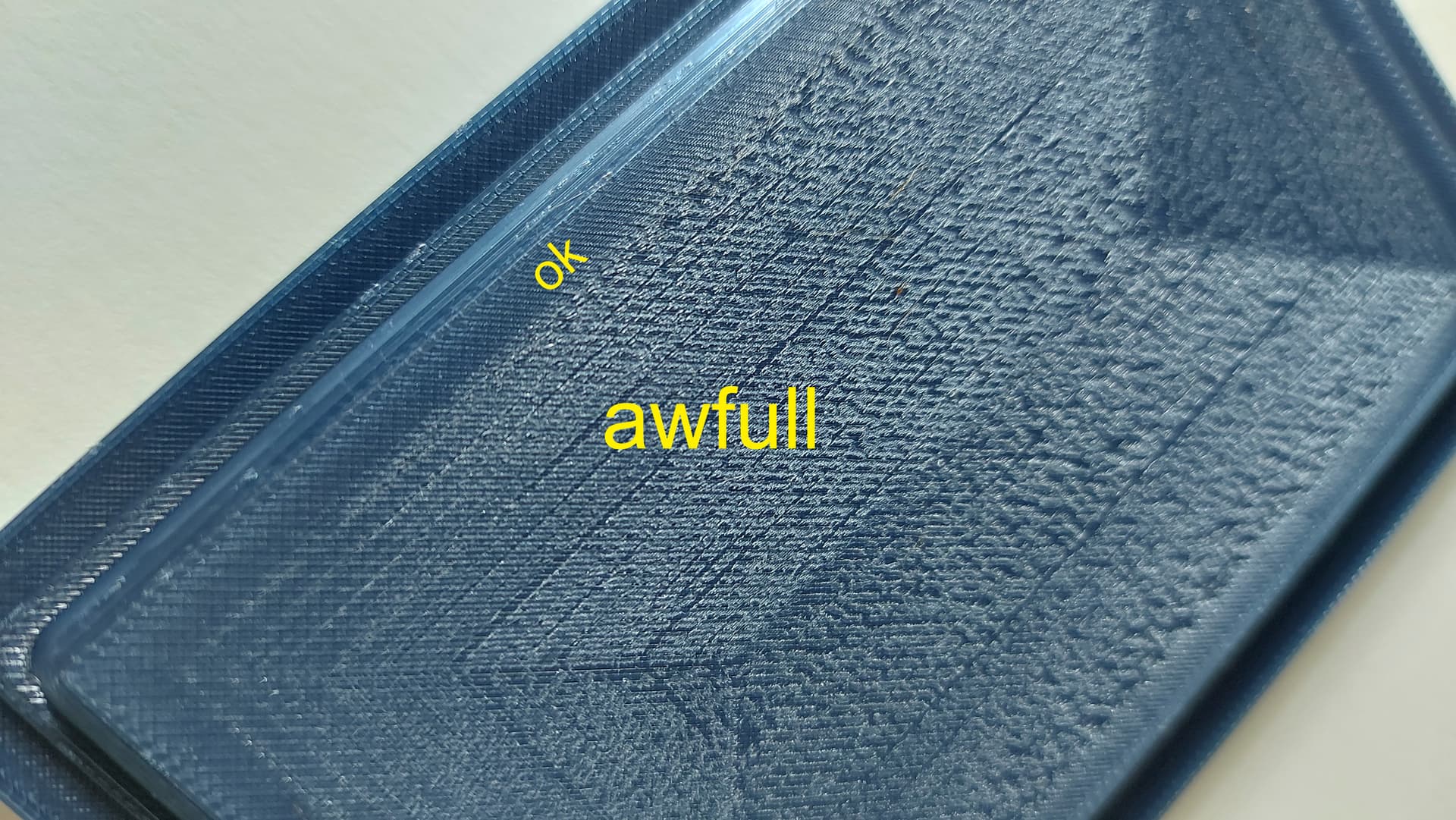

Changed to PLA (same supplier) followed suppliers’ instructions ironing rectilinear; sp30/flw10%.
ref pict PLA 1 & 2.
It looks as if the nozzle does not keep the same distance from the layer all the time. Again the right side is more or less acceptable (and could probably improved by raising the flow somewhat.
But on the left side nothing has happened, it looks qs if it flew over without doing anything. although I have seen it administer filament.

Right now I returned to the first PETG print and sanded de rough toplayer.
Asa de 2000 and 3000 sandpaper are in it will become acceptable for the toplayer. I think I can live with that.
Will check the screws behind the extruder anyway. thanks for the tip.
