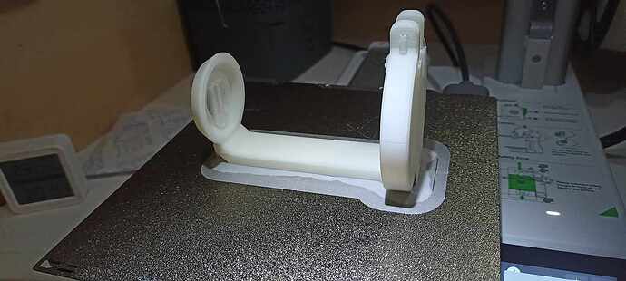

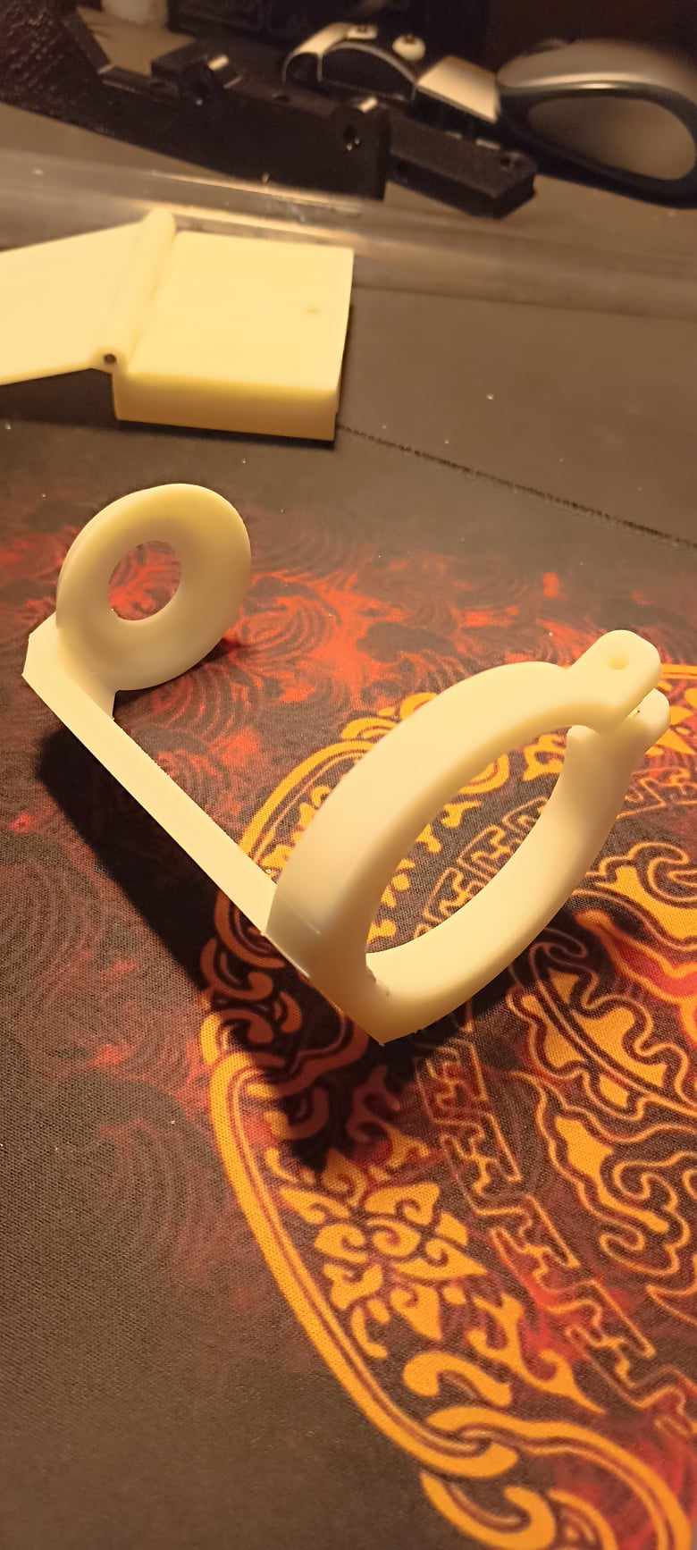

Hey, I have been doing some tests with ABS on my A1mini, and I reached awesome results with the last prints.
What helped was:
I’ve also had success printing ABS-GF and ASA on my A1 mini. I have it inside a ventilated enclosure with an exhaust duct running to the window. The ventilation deals with the odors of printing these filaments while also keeping the interior of the enclosure within the recommended operating temperature of the A1 mini (10-30C). I haven’t tried regular ABS but Bambu ABS-GF prints well with this setup. ASA also works but I’ve had issues with it warping for larger prints.
