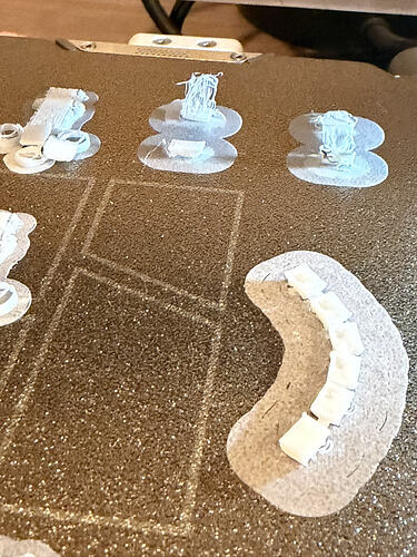

I have been trying for multiple months to fix the adhesion on my a1 mini. I have already checked if my printer is under a vent. It is but even with the AC off, the print still fails. I have also tried cleaning the plate with anti-grease dish soap, which doesn’t work. I am using bbl PLA and I can do test prints or pictures if you would like. I really need help, as everything just says that my bed is dirty and it’s not.

  13. don’t have any rn, but usually 1 part comes detached and there are strings everywere from it trying to print on nothing (will post picture when it happens again)

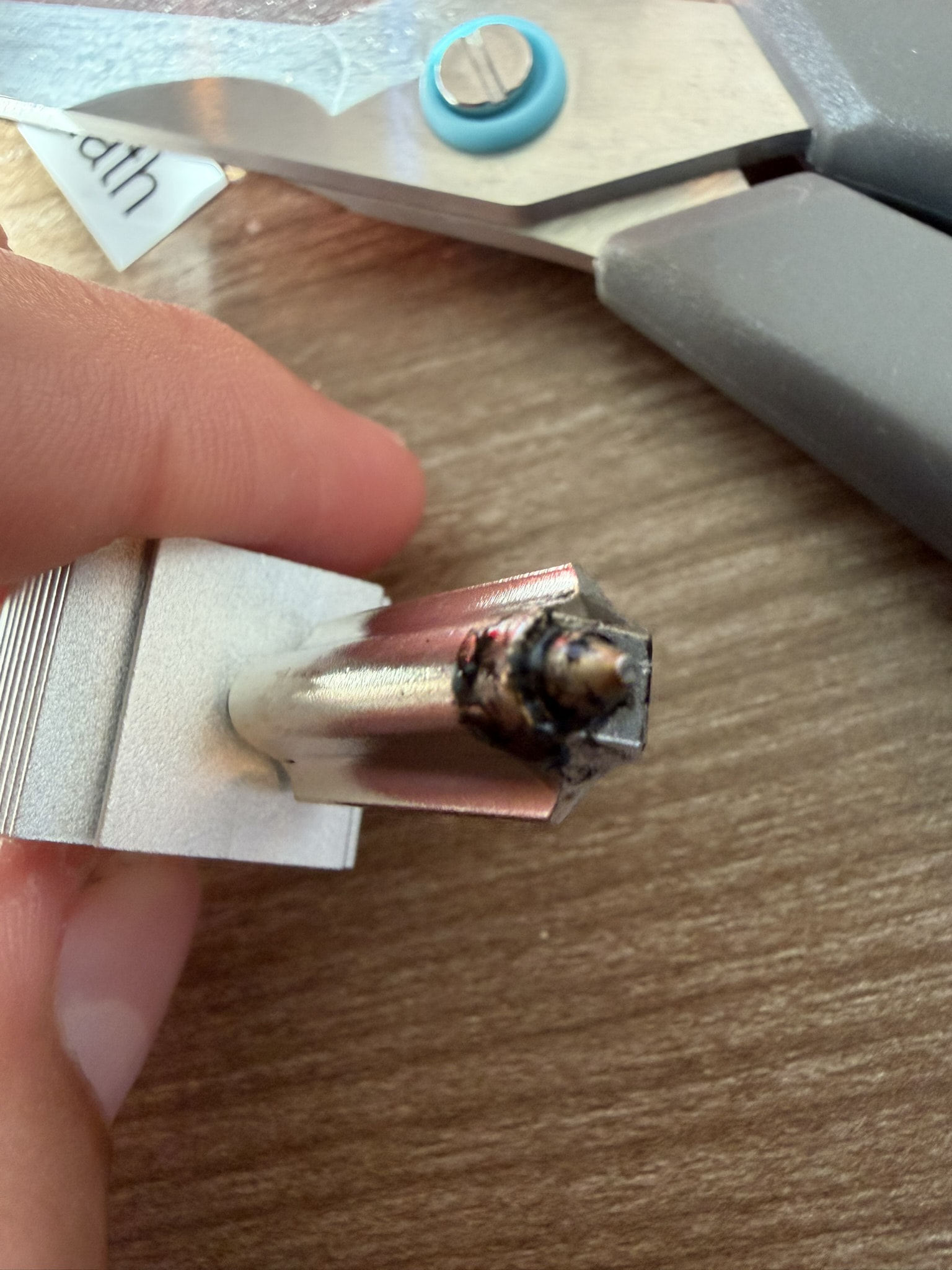

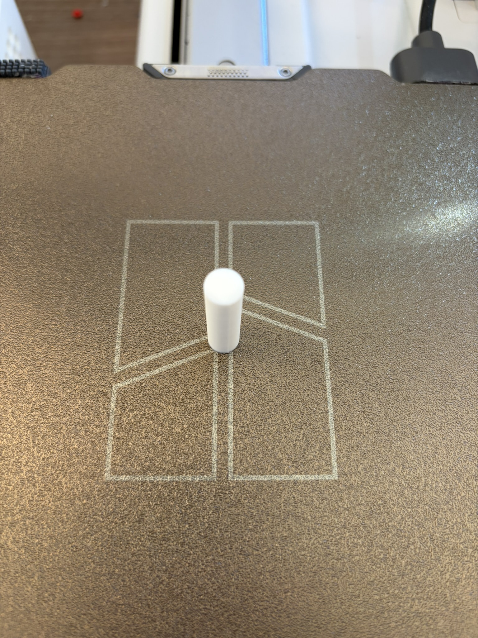

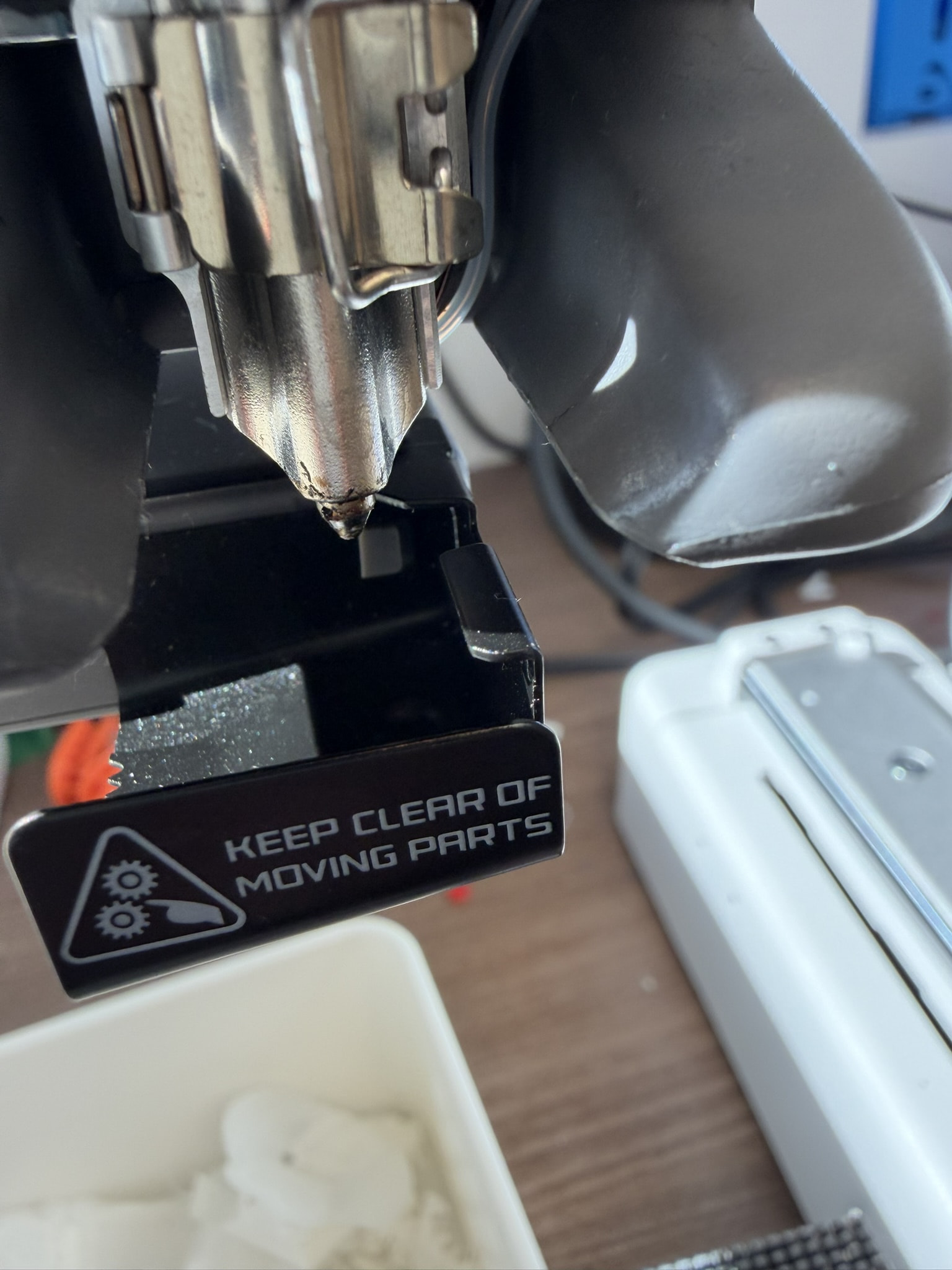

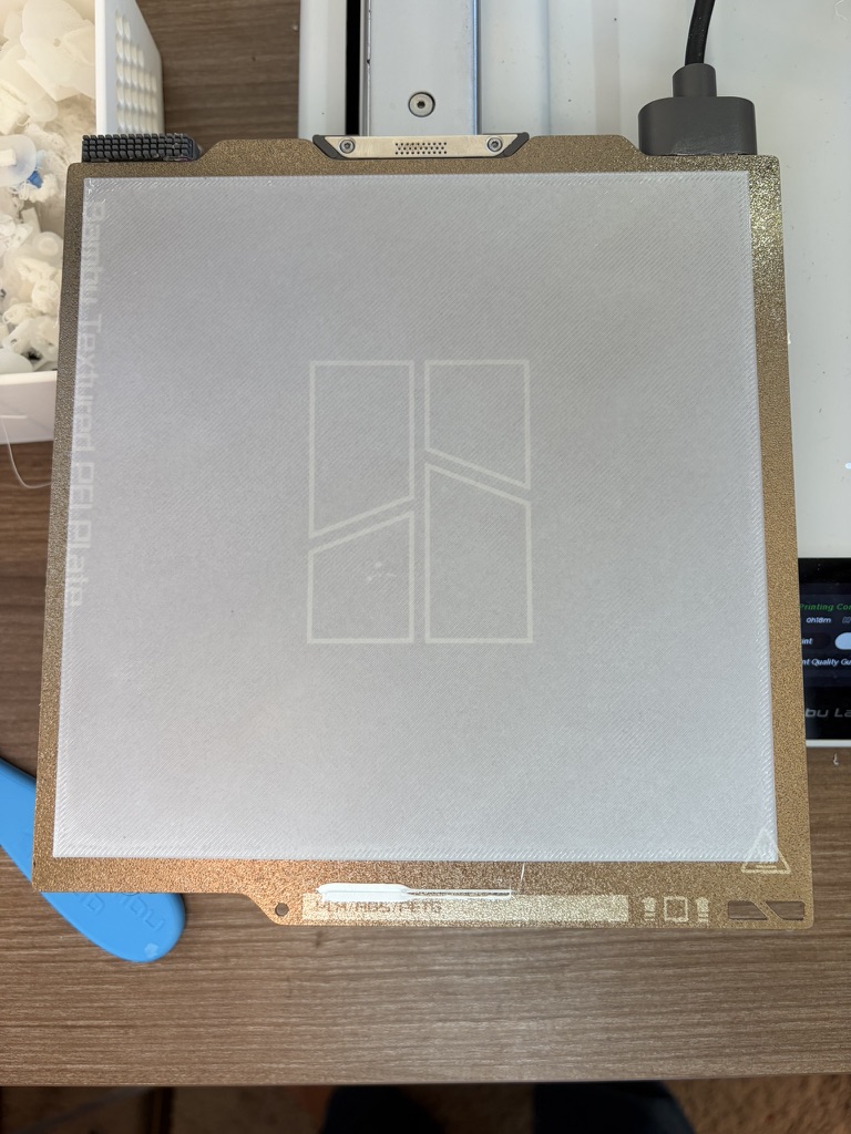

also here are the 2 tests, nothing looks wrong to me. I am printing a print I know has failed right now

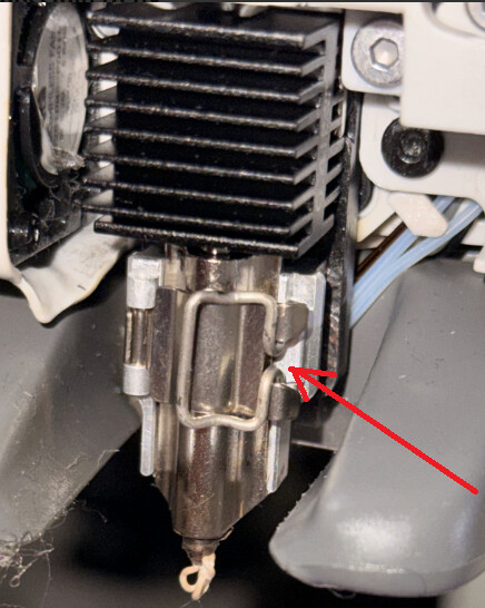

Your nozzle is clipped on wrong, look close at mine. This makes a huge difference. The clip should be inside of the clasps yours is on the outside.
I had just changed the nozzle, issue was fixed
after fixing the issue this still happened on a test print
Part of the print was being pushed up by the nozzle when I found it

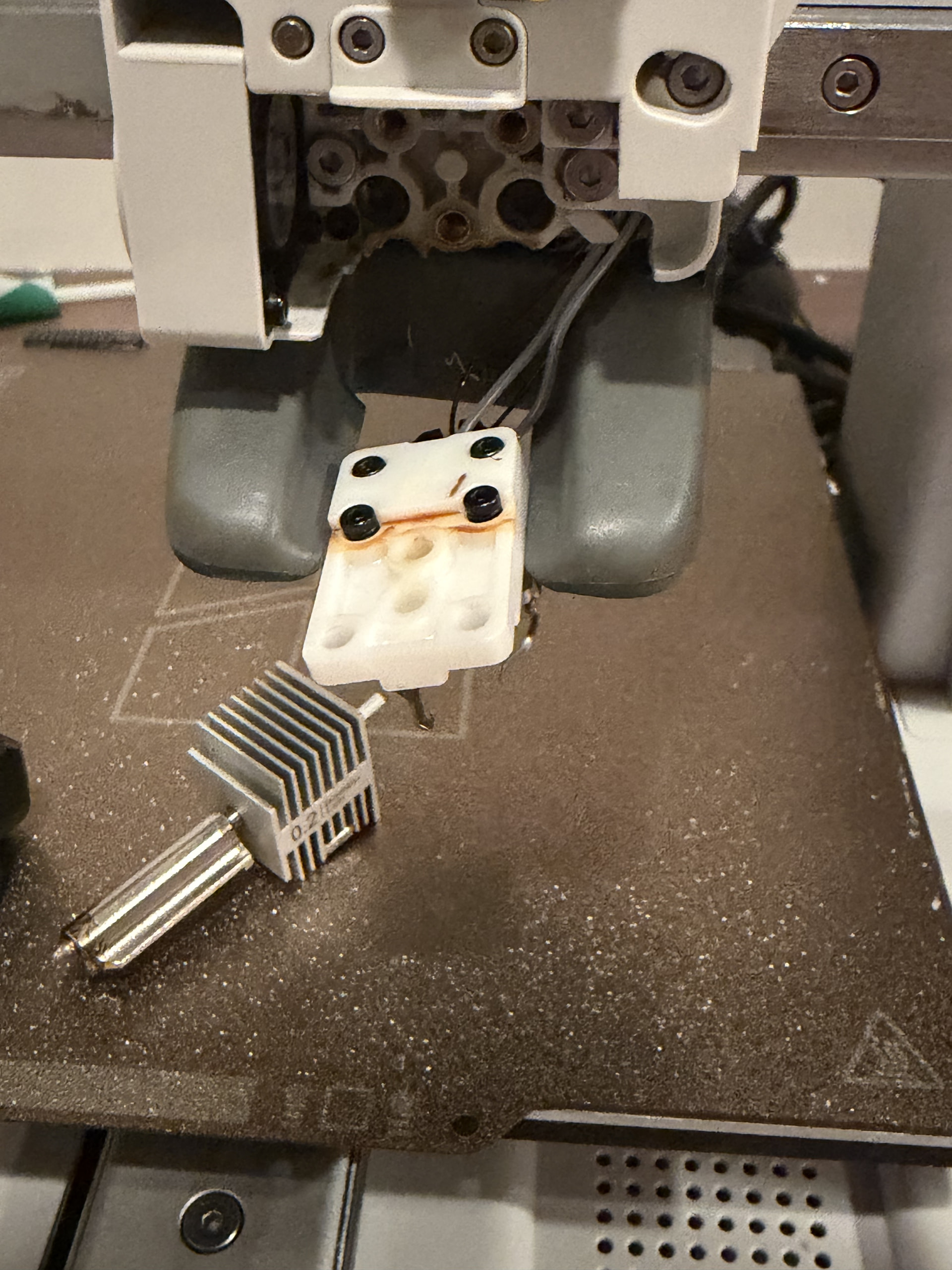

If the nozzle clip issue has been corrected, my next step would be to run a full calibration especially if you just saw the nozzle rubbing/pushing against the print.

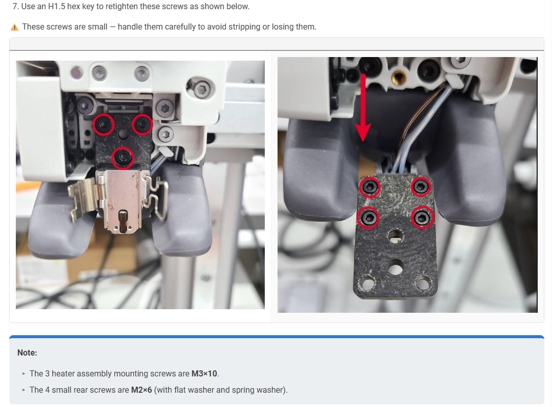

Also, look at this wiki page. You might want to check all of the screws on your hotend assembly. It starts at step 2 - #7. A1 Series First Layer Print Issues - First Layer Too Low, Hotend Moving | Bambu Lab Wiki
Many thanks for the extensive reply. It would have led me down the standard textured plate troubleshooting (use a clean stiff brush rather than a sponge).
However, the pic you showed illustrates bad brim quality and curling defects.
This strongly hints at the loose screw issue identified by @Ulade .
PS: Addendum:
Although I am puzzled about the perfect 1st layer test…
That does not quite go together…
Maybe a slow (50%) print of the troublesome print/object with freshly dried material and supports enabled can shed a bit more light…

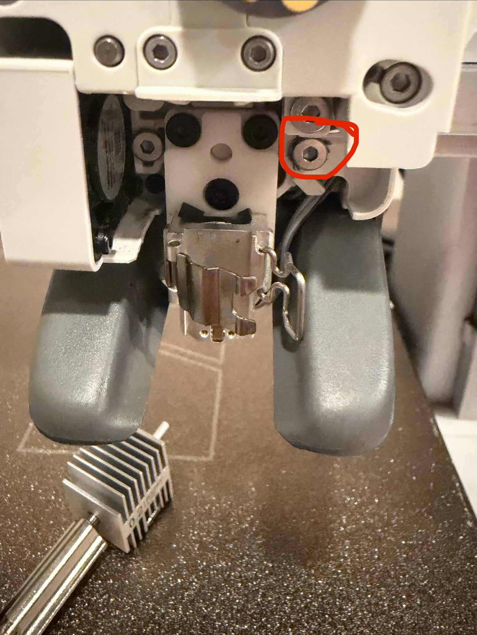

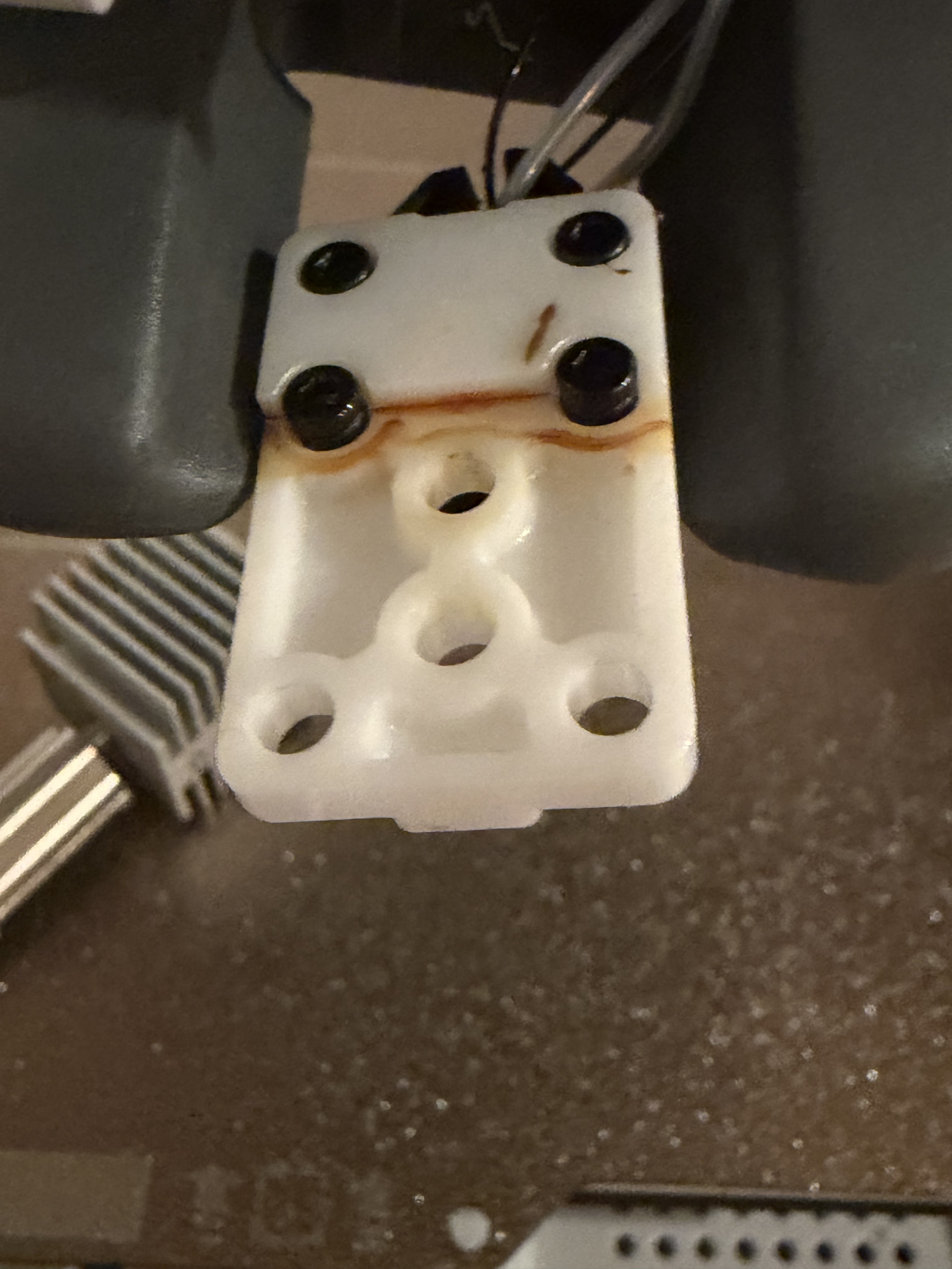

Uninstalled and reinstalled the hotend heating assembly finding no loose screws except one loose screw to the right (circled) it does not screw in tight and twists loose one I screwed it in fully. Also I have replaced it before, not sure if that matters. All replacement parts were bought from the Bambu website
