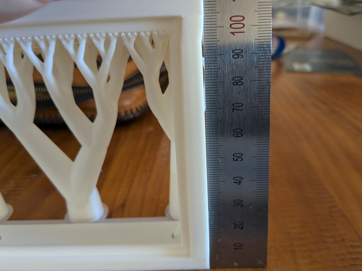

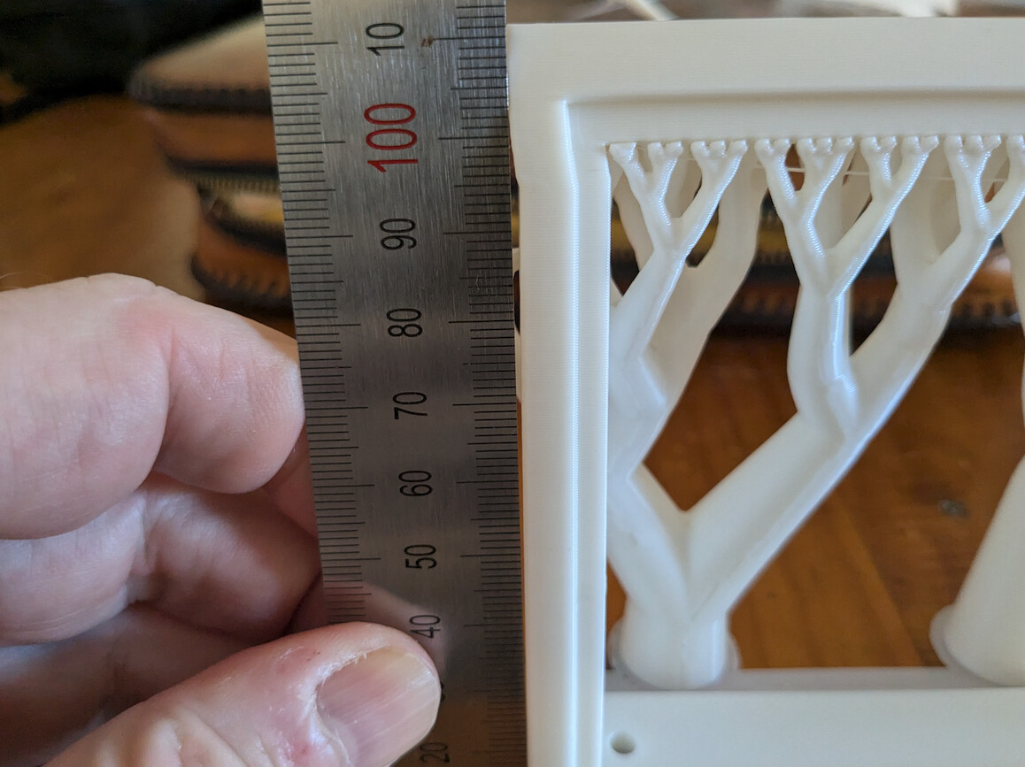

What I did anyway, was swapped the plate to a new one I had. Just to guarantee I had top adhesion.
I still had the same problem, but I can see using a ruler that the side verticals have leaned in instead of printing vertically straight. You can see the gap of the ruler that is sitting flush on the table and hits top and bottom of the print sides:
You can see that the print base was solidly fixed to the printbed.
So I can only assume the problem is getting the sides to print straight.
With the tree supports I can only assume I can do those vertical.
Would it possible to add tree supports on the sides to make them print straight?
