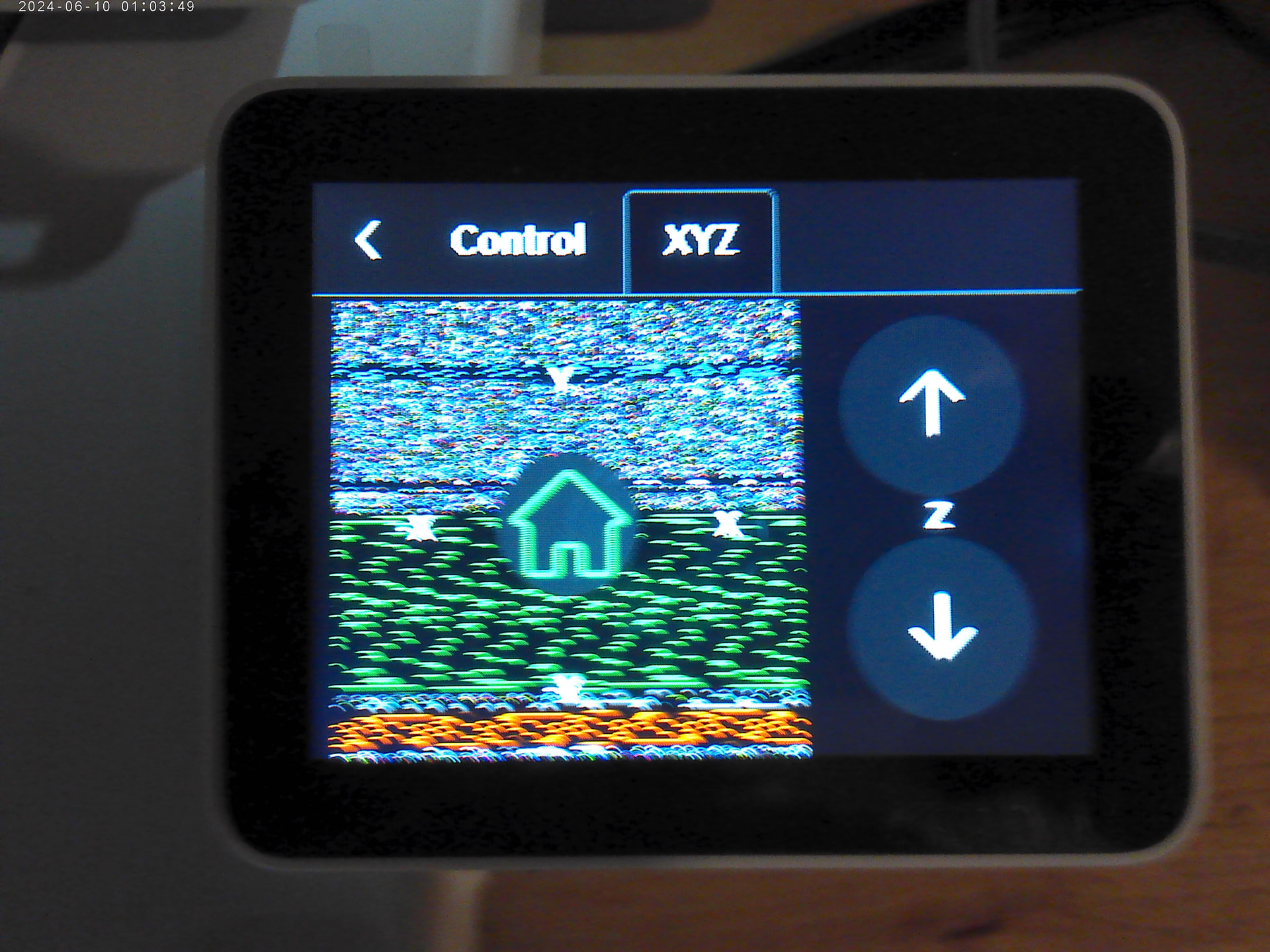

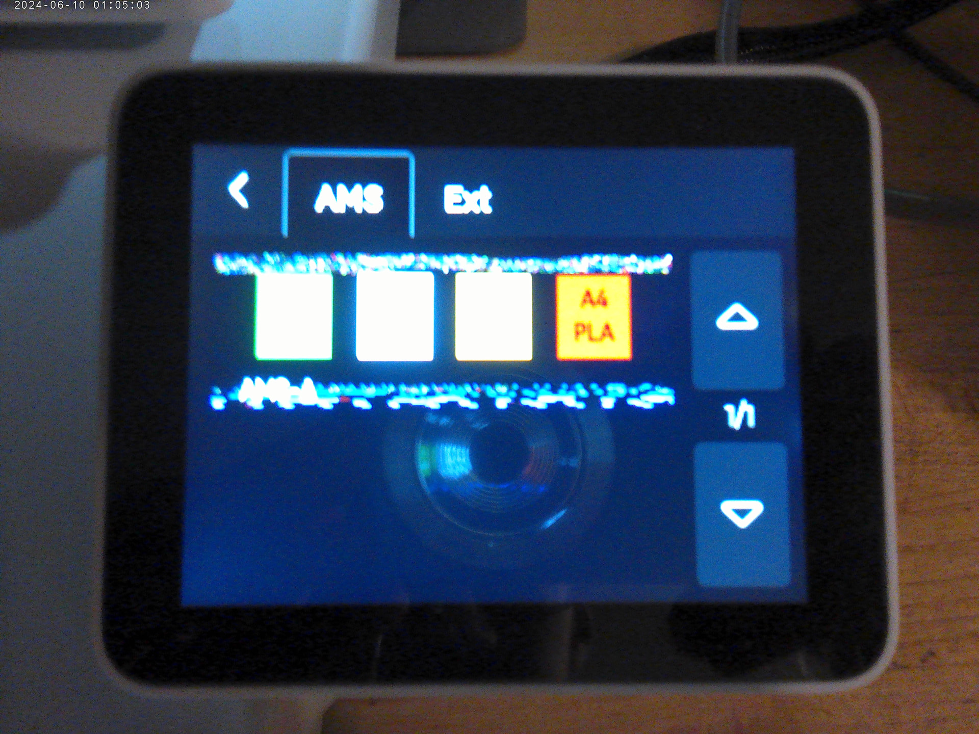

Hello,
My A1 has just 85 hours and it already has a problem!
My screen has been glitching on these pages, but sometimes it displays fine.
What’s the problem?

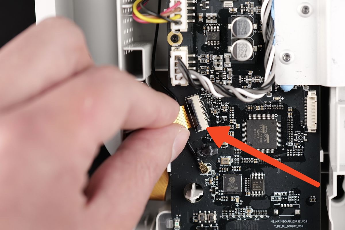

I would check the screen ribbon cable.
Here is the wiki article explaining how to access (replace) this.
I would also start a case with Bambu in case your screen is defective and needs replacement, they should send you a new screen if defective.
