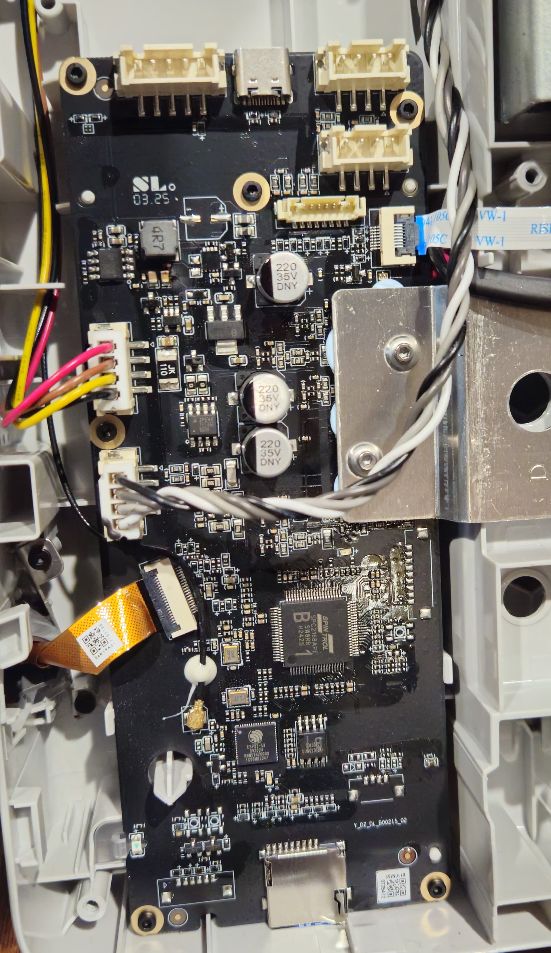

I just had my A1 suddenly stop printing. It made a noise and when I looked over it had stopped, the screen and light turned off and the HMS light was out too. Power light at the back stayed on.
After some power cycles the screen was still off. Removed sd card, screen still off.
I put the card back in and left the power on a bit longer and suddenly there are flashes of white light coming from the internal compartment under the screen and I’m hearing electrical noises, possibly out of the speaker, there is no smell of burnt electrical components. Obviously at this point I panic and switch it off.
After collecting myself I decide to pull the power plug out for a minute, then power it back on. Some more brief flashes of light happen and now it powers on normally again and seems to be working… what the hell just happened?
I haven’t tried running a print on it yet, I think I should probably open it up and have a look at the board first, though I’m not sure if I would be able to know if there was an issue visibly.

Initial thought would be to unplug, unscrew the bottom frame, and ensure that the motherboard’s and power supply’s wire harnesses are still firm, and that you do not see any signs of arc flashing. (black char, melted plastic, etc - unlikely but given what you said, safer than sorry) Focus on the ribbon for the display. Visuals here Mainboard Replacement Guide - A1 | Bambu Lab Wiki

I did open the bottom panel and don’t see any signs of damage, the display ribbon looks fine to me.

I believe I can see a failed capacitor in your original picture, I have highlighted the capacitor with a red rectangle in the attached image:
If you look closely you can see that the capacitor appears cracked near the top and there are signs of scorch marks to the right of it. This looks like a high value multi-layer ceramic capacitor. This type of capacitor tends to fail short circuit which can result in high current flow and rapid excessive heating. Given sufficient available energy they can then blow open, much like a fuse, which I guess is what happened here.
I have no idea how important this part is but if you have been successfully printing then its probably not worth worrying about.
Thanks for taking a close look at my board, I still have the uncompressed photos and I think you’re right it does look blown
Like I there have been no further issues but it does bother me that there was an actual hardware failure on a less than month old printer at the time. I think I will contact support and see if they will send out a replacement board while I still have warranty.
Thanks again, I would never have noticed that

I got in touch with support and sent them the photo of what looks like a blown cap on my board and they immediately asked for order number and address so they can send out a new mainboard - so definitely pop open your A1 and see if you can spot any damage before your warranty is up

The images are in the thread but here is where my failed components are on a zoomed out pic, gives you an idea of how tiny they are. You might want to take a high res photo of your board and zoom in to get a closer look for any damage
