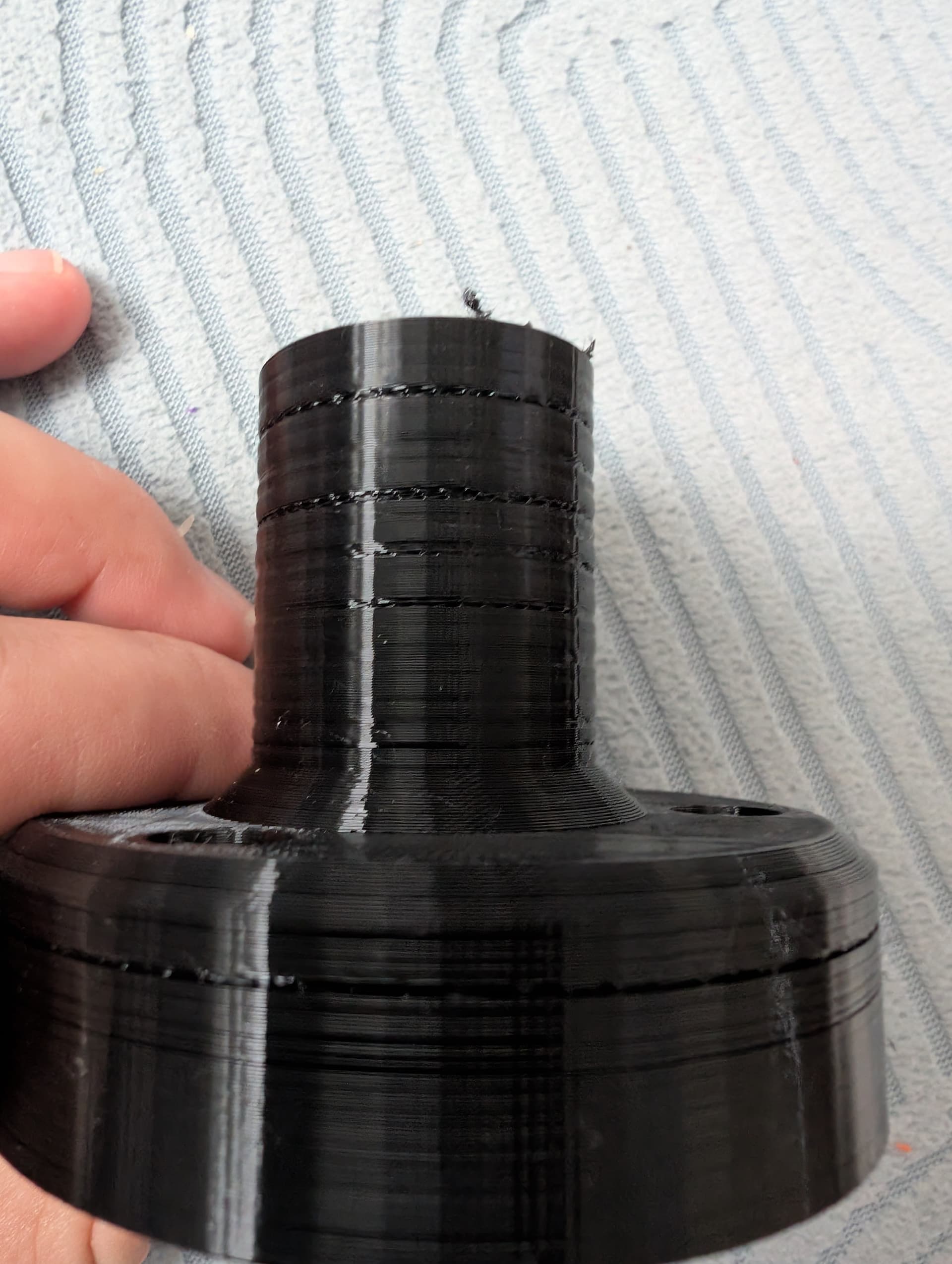

New to 3d printing Woke up to my first absolute mess of a print today!
Printer is an A1.
So I’ve been fine tuning my TPU over the last few days before I attempted this large print. Last benchys I printed turned out great.
Main settings I changed are below.
Nossel temp 215 (within the 195-230 recommended for tpu.
Flow rate to 1.3
Retraction off.
Aux fan to off.
Part fan 50 percent.

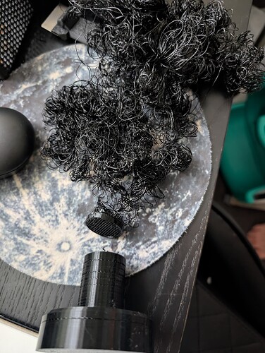

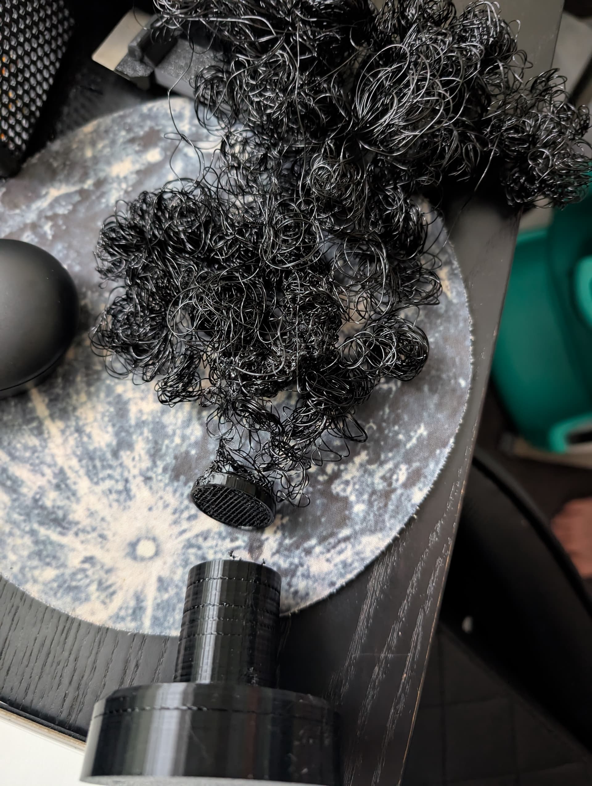

Here is the print. What are these lines? And for it to fail how it has obviously layer adhesion is an issue?
Same print also printed dowels and they just snapped in half straight away.
Please let me know if U need any further info.
Thanks

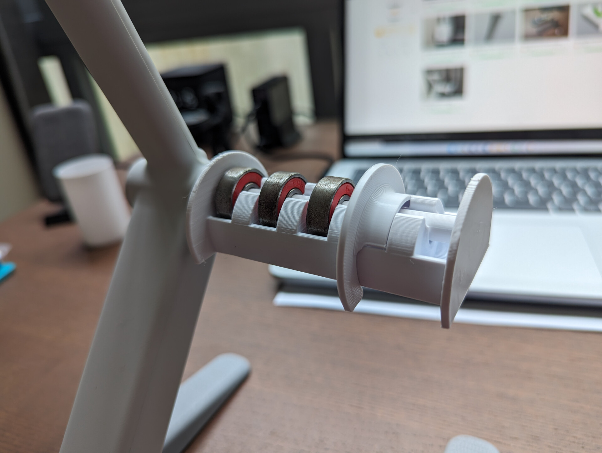

Which grade of TPU ? 95A ?
Did you use an AMS Lite ? Not recommended !
it is very important to have the filament path with as little friction as possible and for the filament spool to turn with as little friction as possible.
Generic setting is good enough to succeed.
from a local supplies called phaser in aus and its 95A.
i have the spool mounted ontop of my A1 in the standard configuration. is this good enough or is it better to mount the spool else where?
With a shaft with bearings it’s better:

It looks more like the spool is snagging and the filament isn’t flowing easily. TPU needs a smooth path all the way.
I use the external spool holder without issues. I note you said you have a top mounted one, it is possible this introduces an issue, but it would depend on which one you have and how well it works.
If that is the problem, @user_1956889802 has the right idea.
I suspect it could be a poorly wound filament though, take a good look at it before printing and see if it could get stuck down either side against the edge of the spool itself.

I’m leaning towards the spool snagging as this was quite a long print which I guess increases the chances of it happening and my smaller prints, e.g benchys have all turned out perfect. very impressed.
Visually spool looked fine, but i find it hard to tell if anything is wrong.
