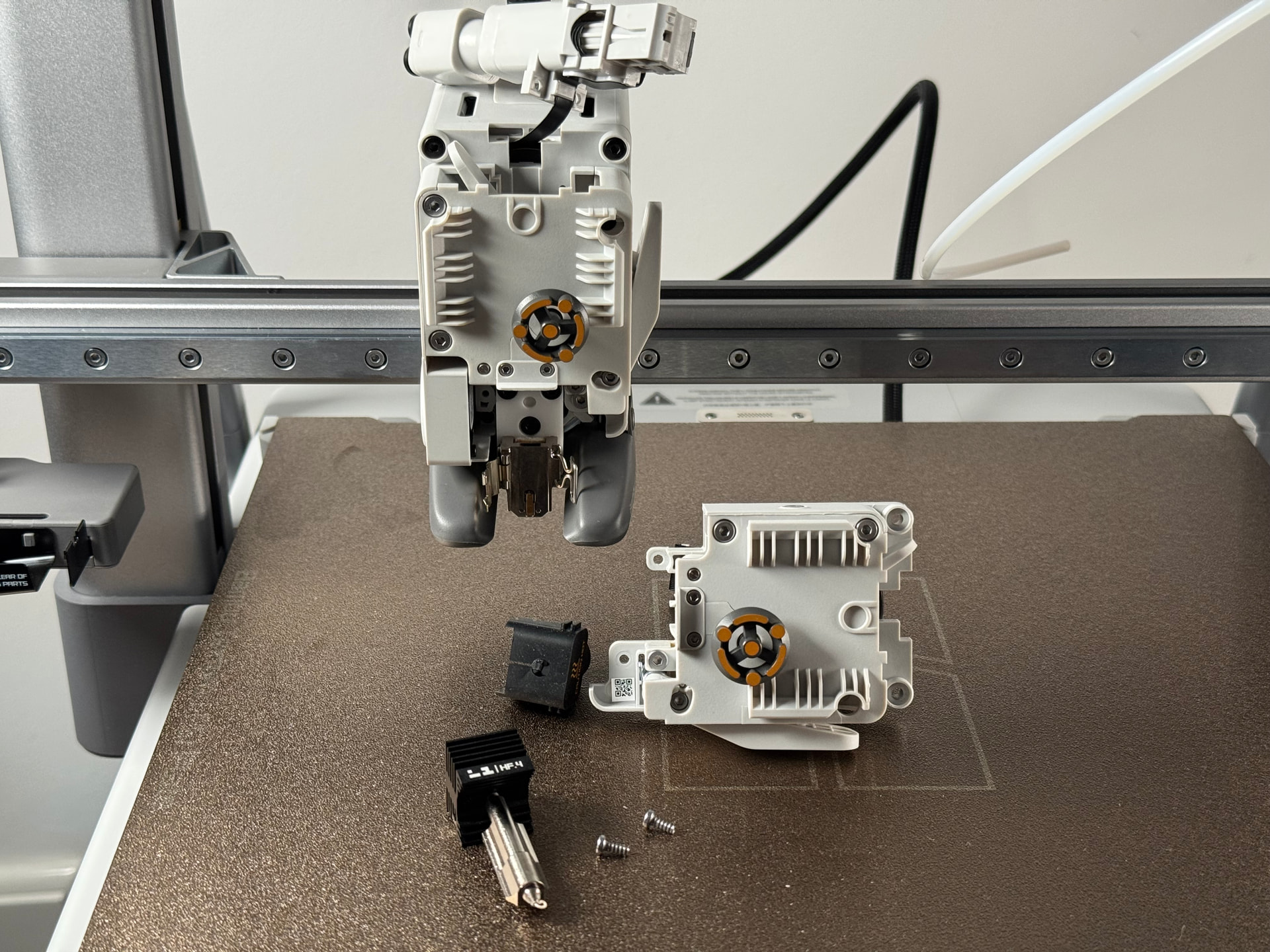

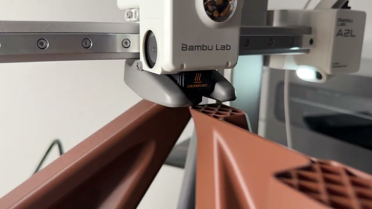

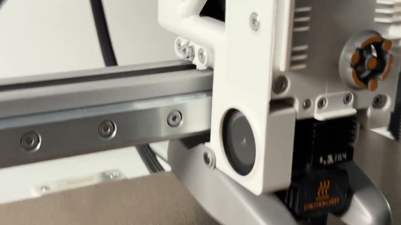

Does anyone else have this issue? The extruder makes a rhythmic clicking noise. I’m using Bambu PETG Basic on the default flowrate. There is no skipping as the print is coming out fine. It’s not a gear backlash noise from retractions as I get the noise on vase mode prints. Listen to the two videos below:
In case someone else has the same problem: replacing the extruder assembly fixed the issue. The new extruder seems to have much less backlash between the gears than the one that came with my printer (not that that was necessary the cause of the clicking, just an observation). Shoutout to support for sending out a replacement so quickly.
