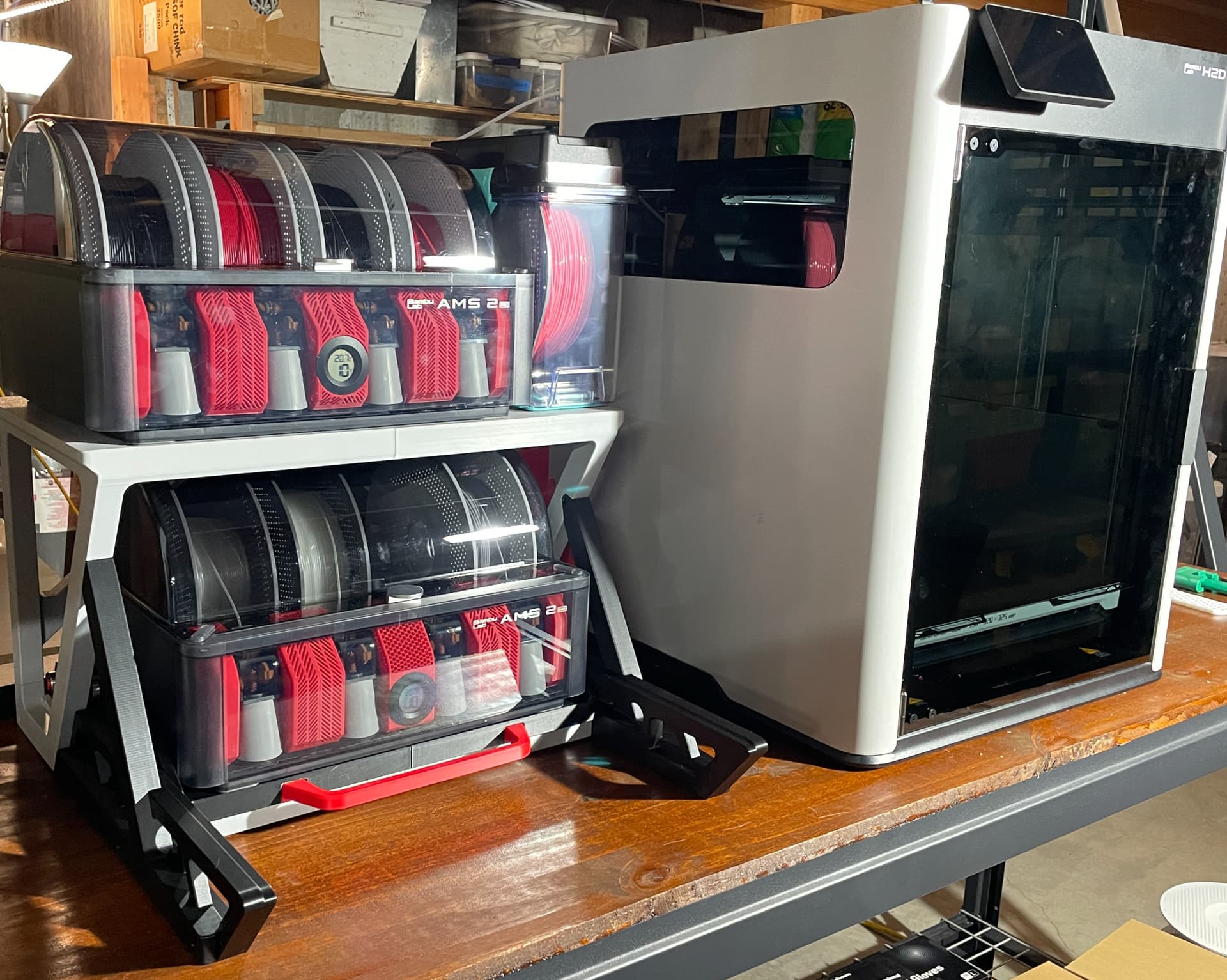

Its definetly worth it. This is my actual setup, one AMS 2 Pro for each nozzle.

I had 2 AMSs connected to my X1C so moved 1 from that , is it better to have 1 AMS on each nozzle ? , I some multi colour print which are 8 colour , I don’t know if it helps with flushing , but I put the light colour in 1 AMS , white , light blue , light pink , etc , and put the dark colour in the other , black , red , blue , orange etc .
There doesn´t a clear answer exists. It depends on the demand of the color changing strategiety of the part you want to build
