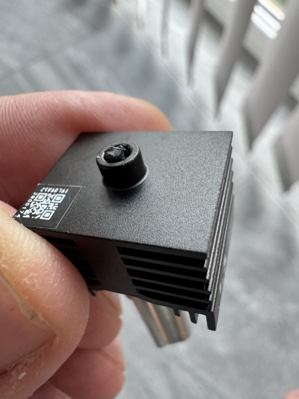

I never had this issue switching between ABS/ASA/PETG/PLA on the X1C. First issue started on the right nozzle when I was trying to load TPU after having run ABS the day before. I just barely got it unclogged, I thought it was the TPU until today.
On the left nozzle I went to run PLA after running ABS yesterday. clicking noises. Tried to push PETG through instead, click, click, click. I noticed it was trying rather low temps to purge the nozzle, so I manually set it to 290 and tried to advance the filament through to push out the old ABS. Nope. I tried everything, cold pulls, nothing was budging the ABS. An extremely small amount oozed out during all of that effort, but not enough to dislodge it. I had to use the extra 0.4mm nozzle that came with the H2D, after only 1 week of printing, because for some reason, this thing can’t handle swapping between ABS and lower temp filament.
I should also note, all filaments are Bambu filaments. Including the PLA/PETG HF/ABS/TPU. Not sure what I’m going to do with this nozzle now. I tried to use a heat gun on it and a hex wrench to push it out, no luck. Might try going the other way and pushing the nozzle needle through the bottom. But this basically means I’m totally gun shy with using ABS from now on, knowing that it could kill my next nozzle if I ever want to use another filament.

if its only ABS in the nozzle, you can try to let it soak for a couple of days in Acetone. that will soften the ABS. Acetone has no effect on PLA though.
try the 2mm allen key. If you have a a1 or a1 mini, release its heater block and seat from the machine (but keep the wires connected), use its seat to install the nozzle, heat it up to 290C and push with the allen key.
You can also do this with H2D, just a little bit harder to access due to the enclosure
@Gerrit@hotellonely you guys rock! I soaked it in acetone overnight, took it out this morning and started pushing the nozzle needle into it. After I got the needle stuck in, because the ABS on the tip was so soft now, I waited for the acetone to evaporate, and then hit it with a mini torch for about 10 seconds. Finally I was able to push the needle all the way up almost to the top of the block, removed it, heated it with a torch again, and then stuck an Allen key in top, and pushed down hard (obviously holding this thing with needle nose pliers), suddenly a ton of filament squirted out of the tip in a perfect 0.4mm stream (about 10 inches long). Stuck the print head back in and fed some PETG into it, it worked. Now I’m doing a cold pull to remove any remnants. You guys saved a print head for me. I owe you both a pint of ale. thank you!
