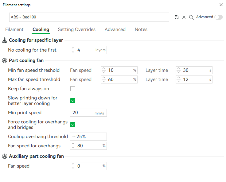

I have printed with the settings enclosed ( see picture) in ABS ( BLUE part) and one with PLA (black). The PLA part was printed couple of week ago, with PLA eSun filament choice. So differently then the ABS settings. What could be the root cause of the poor ABS print?

I suggest increase max fan speed to 60 or 80 for better cool at the tip.

in the meanwhile i’ve succeeded to print an acceptable quality part. I’ve chosen to set the STANDARD ABS BAMBULAB filament and°C adjusted the temp to 260°C. Bed temp at 90°C and while it was printing, coming to the later layers i’'ve played with the AUX and CASE FAN. Both raised till around 80% and even at the end AUX on 100% and got a good result.
So, conclusion is, that the TEMP of the filament at the end-layers is too hot, resulting in a wobbling plastic cylinder instead of a nice squared profile.
The end tip and even the arm need the filament to be cooled quicker it seems.
When it stays too long hot, it doesnt make a solid base for the next layer, so it starts the next layer on a melted abs layer which is still soft ( too soft) to build on.

I would print at least 2 of the same part that small and place them far away from each other, so that it would increase layer time.
The longer layer time the better it cool down.
