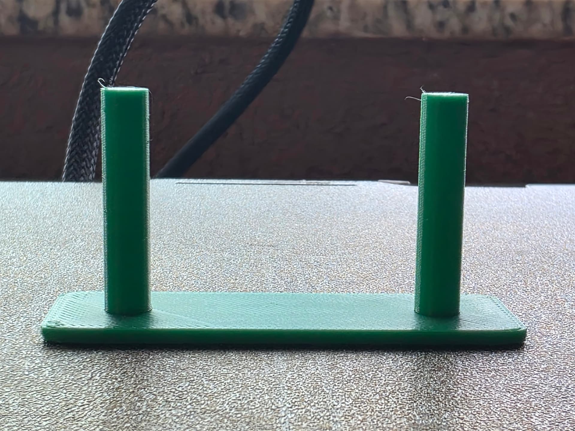

I’m having issues while printing with ABS with my A1. All my tests are done with PLA or PETG as the first layer, after that I set Bambu Studio to change the filament to my green ABS. With PLA and PETG, all my tests below works perfect, and this is my first time ever printing with ABS. Also, this is my first 3D printer, so I’m not sure how to do some stuff yet.
So… I first printed a temperature tower test and I could see that my filament works best with 240ºC, with the least amount of stringing in the test.
8 - Tower_Temp_ABS_230-270ºC.3mf (1.6 MB)
Then I printed a retraction test and I could see that I’m having some issues with stringing and the pillars are rough to the touch (not smooth).
After that I tried a Benchy and it looked fine, except the chimney.
Everything is default, but the temperature. I tried to use the retraction up to 2mm and retraction speed up to 80, but that didn’t help at all.
What am I doing wrong?
Thanks in advance :slight_smile:

So I did this, I cloned twice, and I spread the 3 objects as far as I could.
This is what I got:
The one in the back (still looks bad):
The one in the middle of the bed (way better, with just a couple strings)
The one in the front (almost perfect, no strings but not 100% smooth yet)

Holy moly, the difference is like day and night.
The only issue is this minimal string in the last layer. Any advice on that?
So right now I have the temperature set to 240 and max cooling set to 100% with 7 seconds layer time.
The poles are so smooth to the touch, with no artifacts whatsover. When I tried to bump the retraction I started getting some small punctures in the pole, so I’m not sure what to adjust right now.
Only the top layer (last layer) that is showing just teeny-tiny string in the retraction test (poles)
----Edit
I could also get a very good result with 50% fan and 9s layer time. I’m trying to get a better result because the first benchy with 100% and 7s showed a crack near the back round window. Probably because it cooled down too fast and didn’t adhere so well. But at least now I’ve an idea of what is happening.
Good progress! Dialing in cooling can be a pain.
Especially with higher temp filaments there is a delicate balance between enough cooling to maintain details but not so much as to reduce layer adhesion.
For the top layer, you can try dropping the printing speed from 200 > 150 mm/s.
