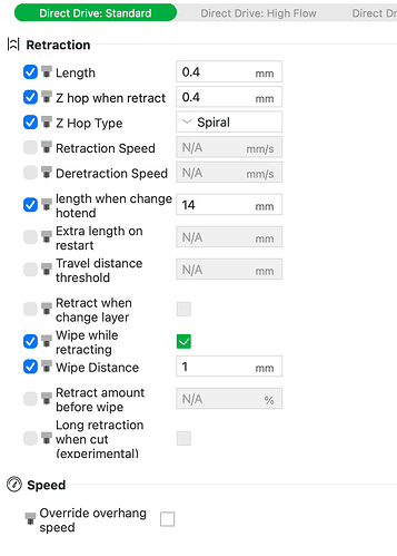

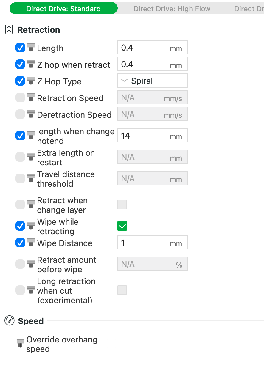

But here’s a H2S setting I used to great results that you can try anyway.
Everything else, stock, because I mostly print the GF variant.
