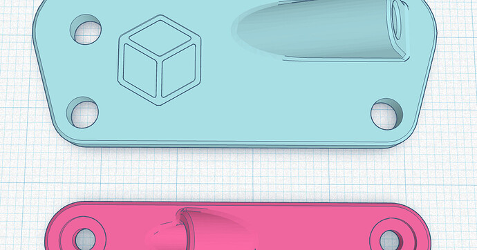

I’ve moved on from this design and printed a PETG passthrough which is hard screwed into the frame. I then use two PTFE tubes for strain relief. I got sick and tired of Bambu’s crappy design which pops out too easily if you are let’s say feeding from a dryer box.
This is the solution I use today.
This is a wonderful design that Bambu should have started out with. Note, these are divided into two pieces by the designer so that they print flush. In my case, I used acrylic cement to weld the two parts together as one unit. I made the hole undersized using the X-Y hole compensation in the slicer and then enlarged it. I then I used a drill to enlarge the hole slightly so that the PTFE tube would pass through more easily. Used PTEG filament to ensure that it would not warp due to chamber heat and for strength.
Here it is in action. You’ll note that I placed a PTFE tube through the interface hole and secured it with PTFE hydraulic fittings on both sides to prevent the tube from slipping out. The PTFE tubes provide sufficient strain relief, frictionless flow, and the rigid plastic allowed me to secure the whole setup using screws, unlike the floppy mess caused by the rubber grommet.
Note: You may need to drill screw holes through the steel case. My unit had partial holes, possibly due to the P1S back panel retrofit. An X1C or P1S may have these already pre-drilled. I used an M3 tap for threads and screws, but you could likely self-tap the screws. I tapped threads for easier servicing.
