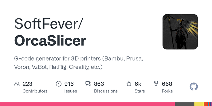

I would just use Orca Slicer.

Orca Slicer is a fork of the Bambu Studio source code. It contains a superset of functions that are either missing from Bambu Studio or were not migrated from Prusa when Bambu ported Prusa into Bambu Studio. The Orca developers are 3D printing enthusiasts who add, not subtract, features into the slicer. One of their big achievements is that they blend the features that were not migrated from Cura Slicer and left out of Prusa Slicer, from which Bambu Studio is derived. If you have not explored scarf joints as an example, that’s something they released in 2.0.
Orca uses the same BambuSource.dll as Bambu Studio. There is no need to uninstall one and choose another. Both can coexist on the same machine. What you will notice is that Orca’s 3MF files are functionally neutral and you will on occasion get complaints of values that are found that are ignored. These are not relevant as far as I can see.
Studio and OrcaSlicer both store their User Profiles locally. As local files, they can be backed up like any other file on your computer.
OrcaSlicer’s filament preset editor can enable pressure advance and store a K value, Studio’s can not.
If your preferences allow preset Auto Sync through the Bambu cloud, both slicers will use the same User presets and slicing with Studio produces g-code using the K value established in OrcaSlicer, overriding whatever value is shown on the Device tab.
